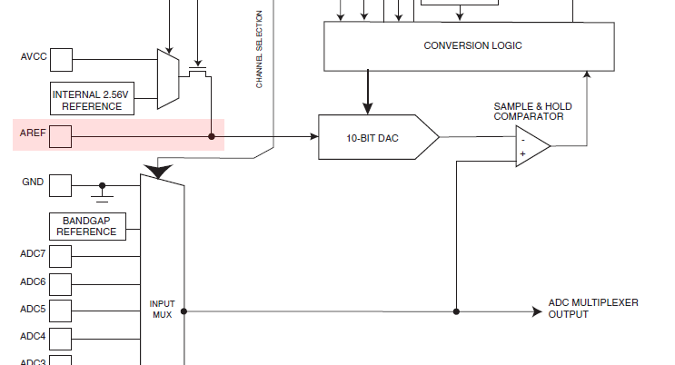

    Listen, after connecting the system, can I use a meter to measure how much my supposed internal 2.56 AREF actually has?

    Judging by this diagram, it is on the AREF pin:
    Connecting AVCC and AREF on ATmega with Internal 2.56V ADC Reference

    Yes, that is why when turning on the internal 2.56V source, you must not connect anything to Aref because there is a short circuit.
