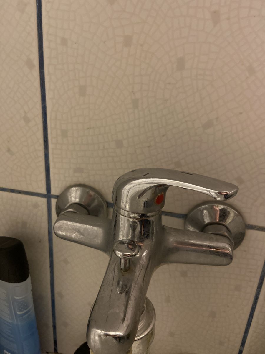

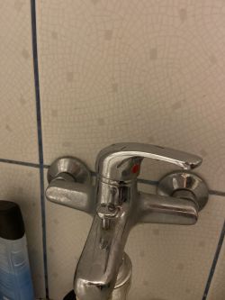

    #18 19114062
    lukwin87
    Hello, I would like to connect to the topic. I have a similar problem, but in the bathtub I have ordinary batteries, without a thermostat (unless I'm wrong, that's why I add a photo).
    In the sink next to the bathtub, the water is hot, while in the bathtub it is lukewarm.
    The stove is Termet Ge 19-02. I tried to regulate it with the knobs on the flame height and temperature, but the effects are poor. Could the fault here also be on the battery side or the stove ends? He's about 5 years old.
    Thank you in advance for your help and best regards.

    #19 19114176
    Wojewoda82
    Posts: 968
    Help: 118
    Rate: 392
    Unscrew the bathtub spout (warm water) half a whistle and see after a few or several seconds if the water is warmer. it should be warmer. Bathtub faucets have a high water flow and probably this one also has 15l / min, hence the boiler cannot heat it so much through it (it probably has a capacity of 10-11l / min). Cold water is now at 5 degrees.
    Heater parameters:
    Nominal heat output 19.2 kW
    Minimum thermal power 8.0 kW
    Hot water outflow (?t
  • Calcification or excessive flow may be causing poor heating
    #20 19114378
    BUCKS
    Posts: 3820
    Help: 536
    Rate: 1087
    you have been a user for 5 years and now something has changed for the worse?
    If so, it may be the effect of calcification in the exchanger, which makes it less heat transferable.
    If this is your first winter and you are renting an apartment, it may be as Wojewoda82 wrote and you have too much water flow in relation to the boiler's technical capabilities.
    I use aerators and in the shower I have a flow of 6.6 l / min, thanks to this my 2-function boiler, although it is twisted with a maximum power of up to 17kW, quietly heats the hot water.
    I always open the tap to the maximum and it's OK, because I know that the flow will not exceed 7 l / min and the boiler will always be able to heat the water.

    Gentlemen I have read all the posts and can't see a solution to the problem for me. Today my wife calls me into the shower and says the water is running cool, a little surprised I look at the cooker and there it shows 33 degrees and the temperature is not going up. We have a Termet minamax elegance gas cooker with no water tank, it heats up on the fly.
    I turn on the taps in the wash basins and the water reaches the set temperature of 42 degrees, but in the shower, bath and kitchen it seems to me that the water pressure is already higher and it can't heat the water to the desired temperature unless the water pressure is reduced. Then it reaches the set temperature. I had the cooker serviced in the autumn. I have the usual basin and shower taps as well as in the kitchen. I'm starting here because it's almost midnight and it's starting to bother me. I should add that the heating in the house is ok, is this an issue of some kind on the cooker? Should I be worried about any leaks in the system?
  • #28 21368583
    W0jtek92
    Posts: 3852
    Help: 469
    Rate: 1258
    Hi. Has the pressure in the bathroom taps always been the same? If so, I would bet on a calcified hot water exchanger. It may not be very calcified, but there is enough calcium that it no longer reheats the water at a higher flow rate.
    Regards.

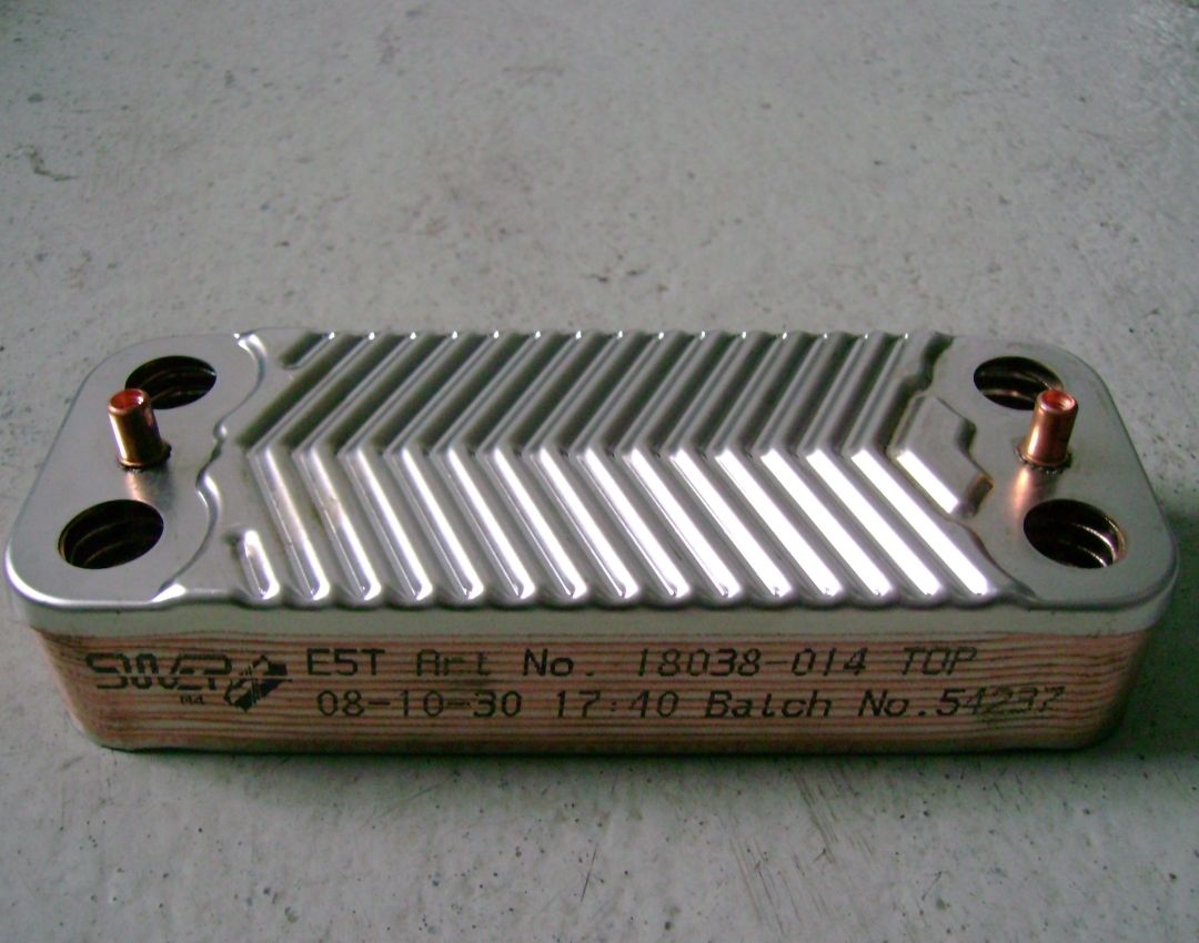

  • Heat only returns when mixer tap is partly closed
    #30 21368793
    Quleross
    Posts: 11
    From my observation I can say that the pressure at various points in the house did not change. In the bath it always ran stronger and in the shower and it took a while for the temperature on the cooker to reach the set point. Now, after turning on the tap, the cooker temp even flies down, does not rise and stands at 33 degrees. Only when the mixer tap is turned halfway does the temp go up and hot water comes on.
    I called for a service technician today, but of course the waiting time will not jump. So far we have hot water by turning on the tap.
    Added after 5 [minutes]: .
    I've had a look at where this exchanger is mounted. I think it is unscrewable without much technology. The issue is if it's on those 2 screws just fixed and how those water tubes go in there, what principle holds it. Heat exchanger lying on a surface with metallic grooves and markings. .
