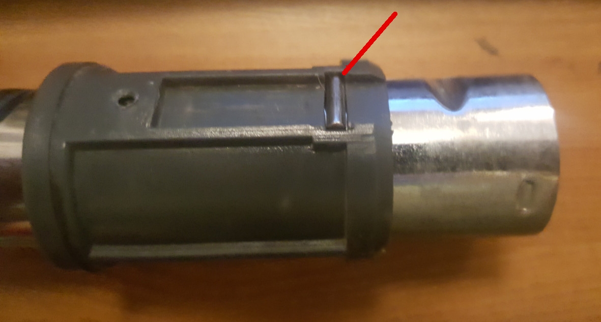

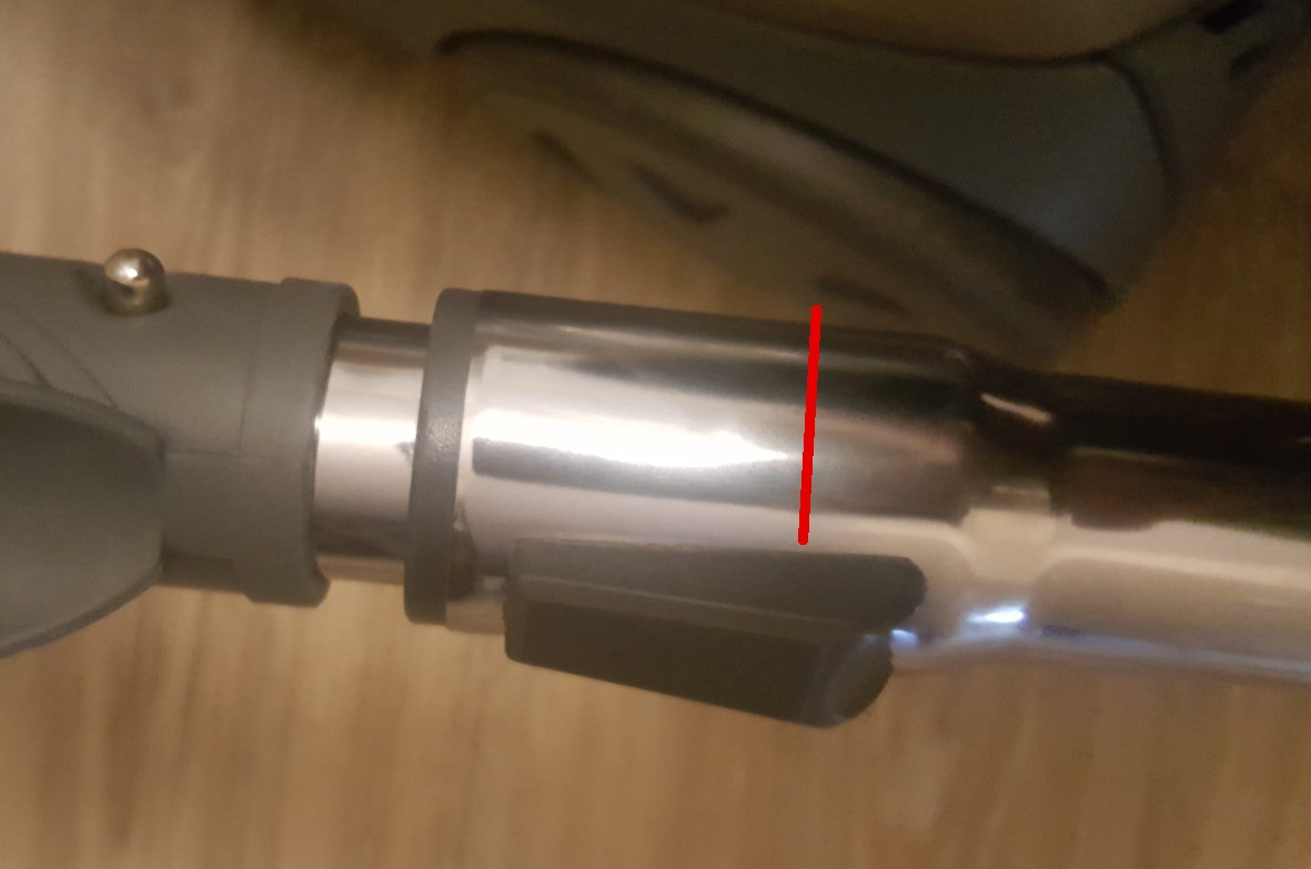

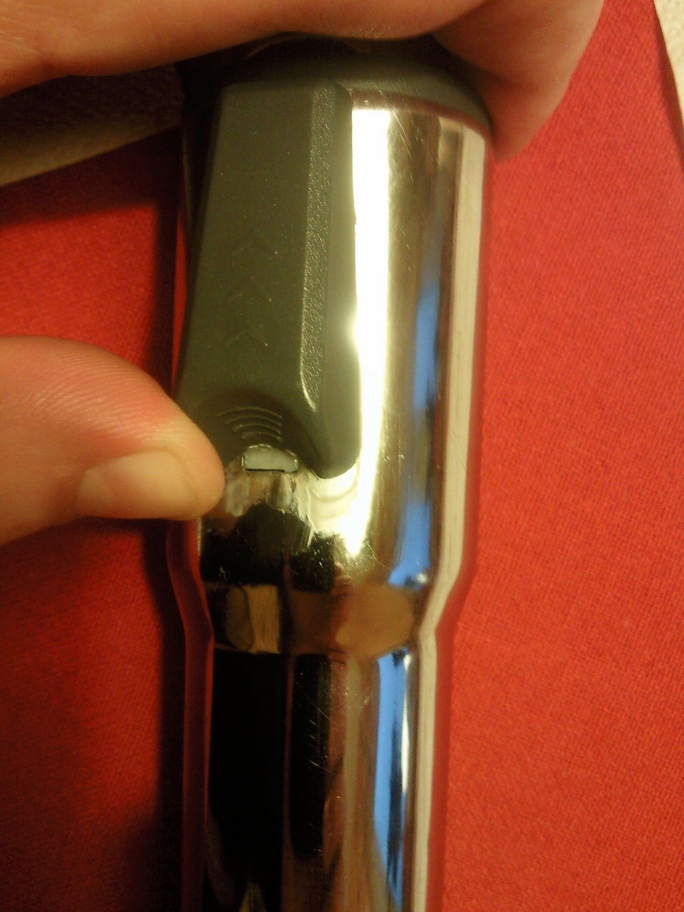

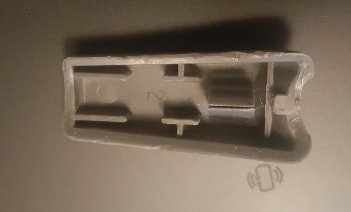

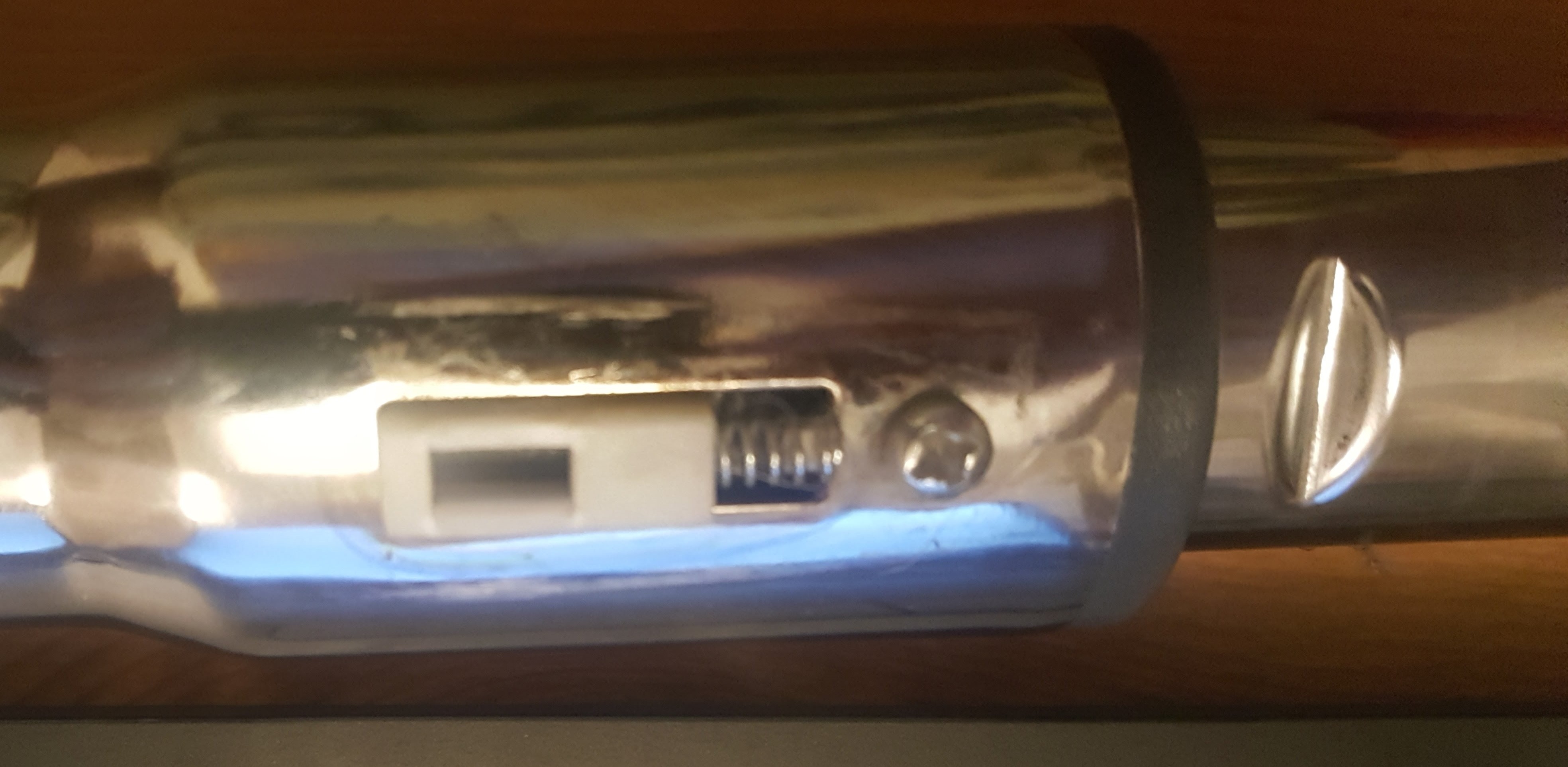

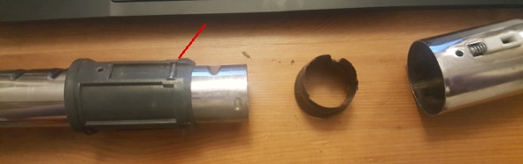

  • #14 17163244
    Drapiezca
    Posts: 8
    Rate: 21
    Hey
    The key to everything is prying that plastic off the side. I add photos so that everyone knows what's going on because taking it apart is trivial.
    You have to pry on the side in the photos you can see where the plastic has a latch. When undressing, be careful not to lose the metal roller responsible for blocking.
    Regards

    #15 17868412
    Grendel
    Level 21  
    Posts: 326
    Help: 35
    Rate: 244
    Drapiezca wrote:
    undressing is trivial
    Overall, maybe it is - just like the structure of this mechanism.
    Unfortunately - in the case of my pipe, removing the slider (even though I knew exactly how and where it was attached) was almost a miracle - by the way, the catch in this light gray cube with a spring broke. Luckily, it's not serious.
    Worse, that (as it turned out later) the thin stop on the right side of the metal roller (looking at the third photo) was also crushed, so the repair may not be effective.
    Maintaining the pressure force on such a poor crossbar, which arises, for example, when vacuuming a carpet, sooner or later (rather sooner) will cause it to crumble.
