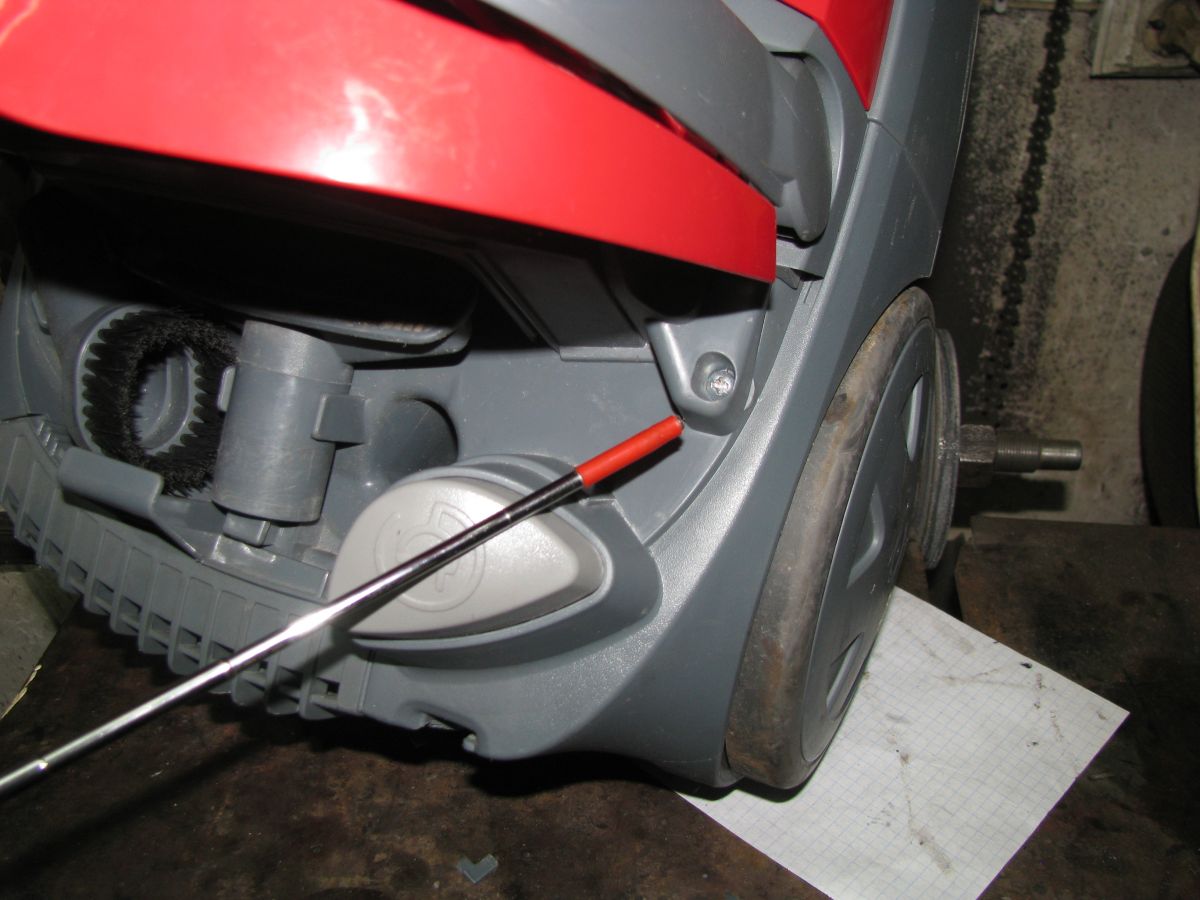

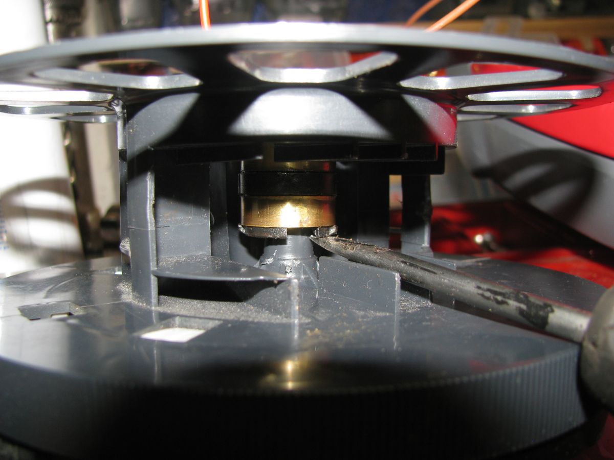

    Now it`s time to unlock the hooks above the wheels, insert a thin screwdriver on both sides and pry:
    How to disassemble and repair the Zelmer Jupiter vacuum cleaner How to disassemble and repair the Zelmer Jupiter vacuum cleaner

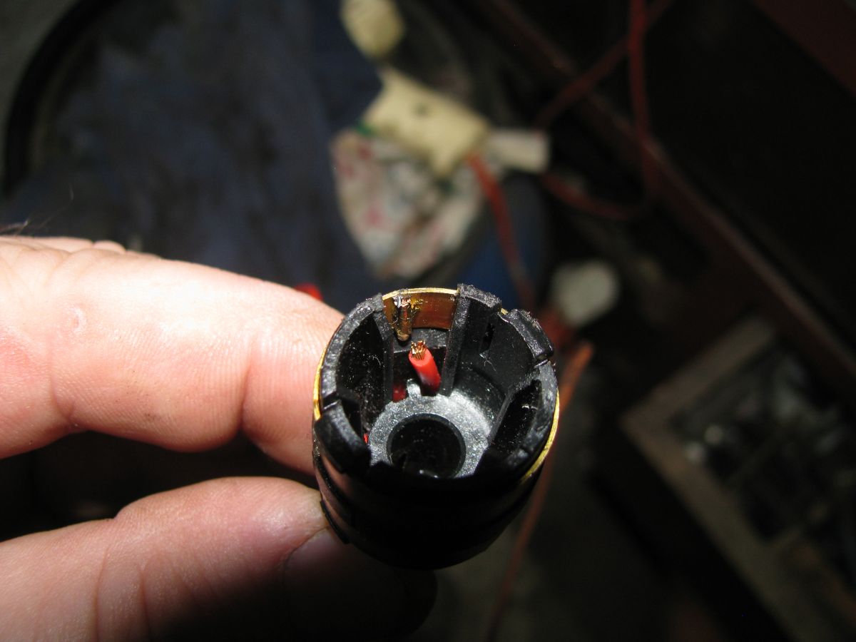

    Now let`s get inside, after checking the switch and wiring, I found that there is no voltage coming from the cable reel, so we pull the reel outside:

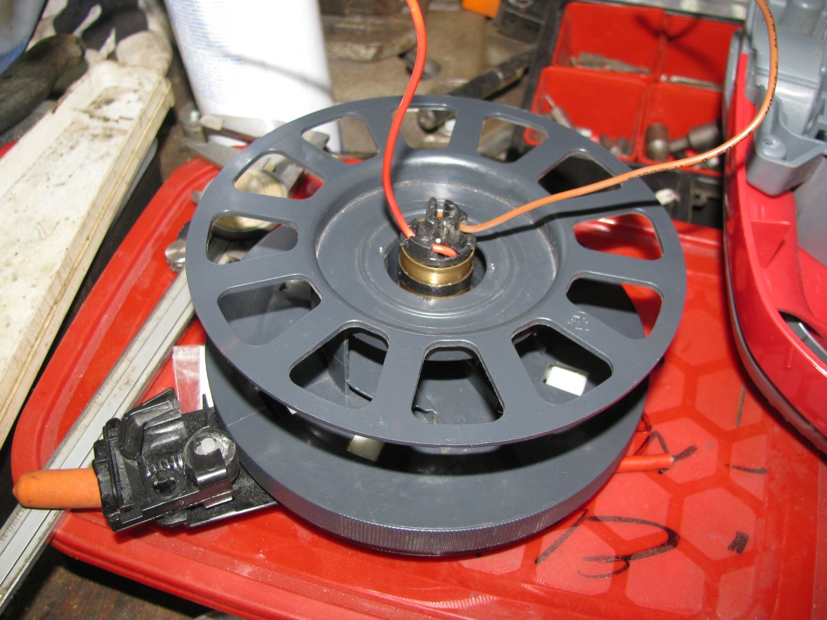

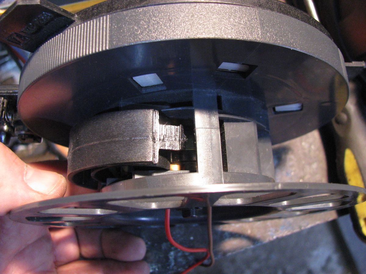

    We unwind the cable, taking care not to release the spring lock that locks the ring with the spring, otherwise we have to adjust the spring tension so that it winds up the cable completely. Once the cable is unrolled, we remove the black insert by prying the catch with a thin screwdriver:

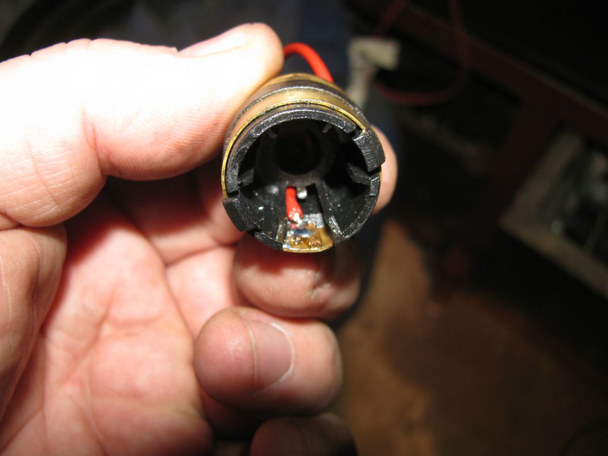

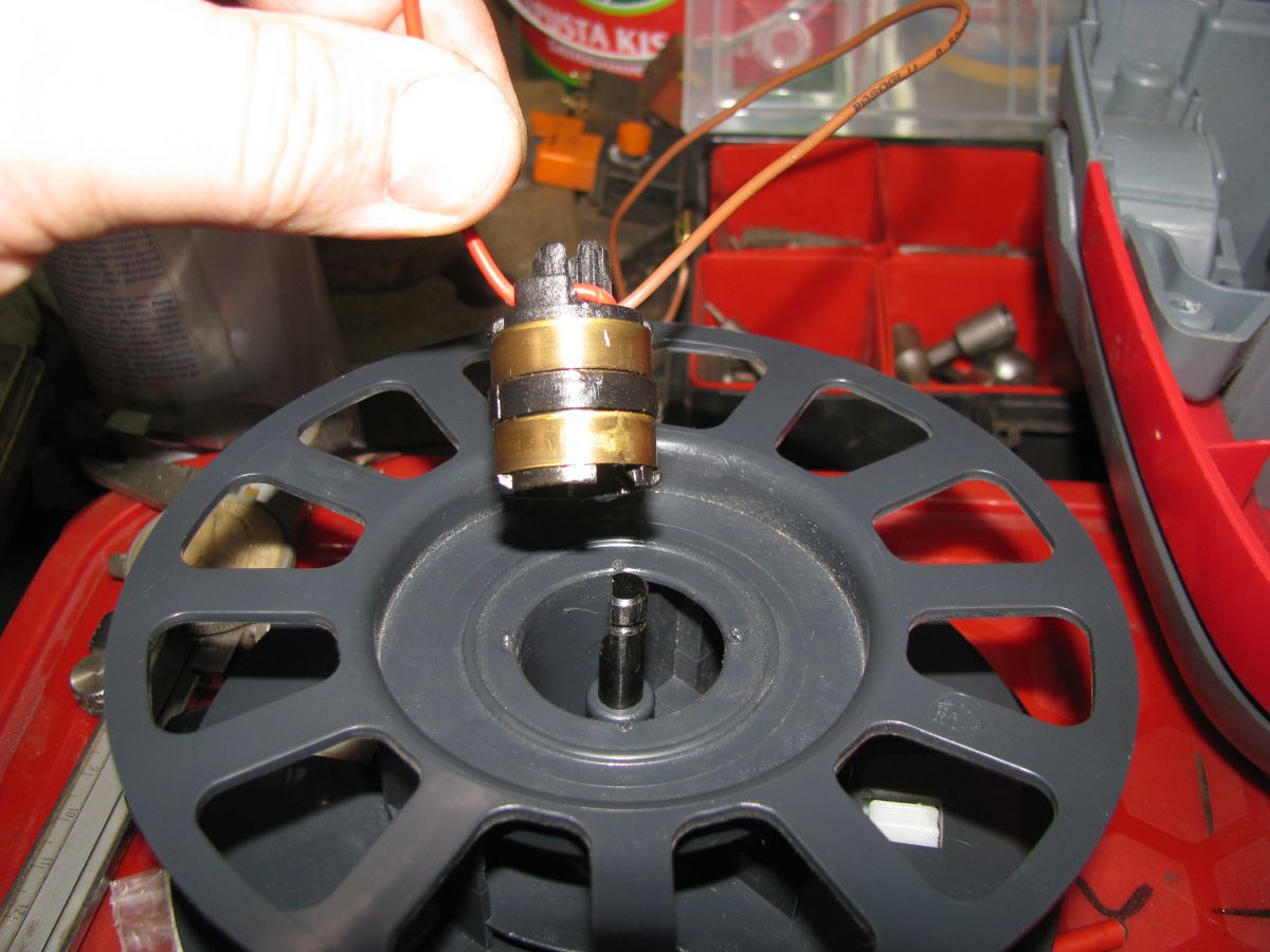

    Now I am disassembling the center where the entire contact slider is located, I inserted a thin knife, prying the extreme catch, and at the same time inserted a screwdriver and pryed the bottom to push it up.
    How to disassemble and repair the Zelmer Jupiter vacuum cleaner How to disassemble and repair the Zelmer Jupiter vacuum cleaner How to disassemble and repair the Zelmer Jupiter vacuum cleaner How to disassemble and repair the Zelmer Jupiter vacuum cleaner How to disassemble and repair the Zelmer Jupiter vacuum cleaner
    After careful inspection, it turned out that the cable above was torn off. We solder the cable and wind the cable on the reel, put everything back together, put the reel in its place and close the engine, check the button to see if it rewinds the cable:

    You described it nicely, which is a plus, I also repaired several such cases in my career. This is a typical fault in vacuum cleaners. Regards

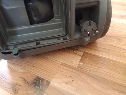

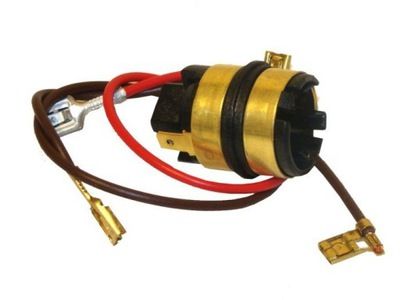

    And I assume this is the case
    And peace of mind.
    If you were at Zelmer`s training, you would know that it is a disposable part that breaks when taken off and a new one is put on 😀

    This slide from #3 looks like it could be the new stripper. Because the wires are on connectors, not soldered.. ;) Maybe they also gave better cables in this new disposable one...

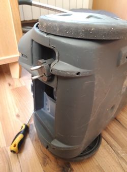

    Hello, I have a problem with disassembling this bush remover. I unscrewed everything, but it looks like something is still stuck there (as in the picture). Does anyone know how to arrange it here?
