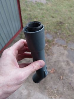

    I have a Meteor 2 vacuum cleaner, which I brought back to life thanks to the advice from this forum, but there was another common problem - the suction pipe next to the suction cup holder had a hole stuck in it. I decided to fix it and cut the pipe, but I can`t get the remnants of the suction pipe out of the plastic casing, it just spins and won`t come out. How to take it apart?

    It`s about the part as in the photo, the hose had a hole covered with tape, so I cut it completely because I thought I could easily make it again ;-) But unfortunately it just hangs around and doesn`t want to come out...
    Zelmer Meteor 2 - How to disassemble the end of the suction pipe
    Here you can buy a ready-made tip for PLN 20, maybe it is originally built this way, but how to disassemble it, how to pry off these latches and where are they?
    Now I see that I don`t have the half-centimeter long hole like on the tip ready for sewing.

    My snakes (I have two Meteors) don`t have these holes. The hose rotates freely at the end.

    Then grab the wire or plastic reinforcement (I don`t know what you have) with the pliers and slowly pull it out, it should work. Maybe then you`ll see the locking ring.

    I even tried to pry it out with pliers, to no avail, that`s why I`m asking here. There must be a blockage somewhere, but I don`t know where to look for it.

    Try unwinding the wire and pulling it out of the connection. Good luck.

    As suggested, I removed the remnant of the pipe without any problems by unwinding the wire.
    Unfortunately, I can`t remove the middle part because it`s held in place by latches, but there`s no way to get to it and pry it off because there`s an external flange on the pipe that limits the hose and there`s no way to insert a screwdriver there. :-(

    I couldn`t remove the internal movable part on which the flexible pipe is wound, access to the latches that hold it tightly is terrible, but removing it is not necessary and solving the problem turns out to be quite simple. We block this movable part from the inside so that it does not rotate and now we can easily screw on the flexible pipe and it`s ready. ;-)
