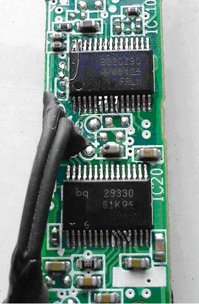

    I decided to replace the blocked controller with the BQ20z90 with the appropriate switching pins, which are not many - you can see them in the pictures.
    I disconnected the cells from the electronics. Then I desoldered the BQ8030 and checked the connections with a typical BQ20z90 application from the datasheet.

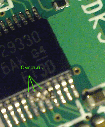

    The legs 6, 7, 29, 30 of the BQ20z90 controller need to be raised. I soldered the prepared system to the driver board. Then I connected the free legs and pads with a thin wire as described:
    - connect the raised 30th leg to the pad under the 6th leg,
    - connect the raised 29th leg to the pad under the 7th leg,
    - connect the 21st leg to ground,
    In the BQ29330 system, move the legs as shown in the photo.

    Sorry for the bad photos - I take pictures with the phone camera.

    - in the BQ29330 system, move the legs as shown in the photo.
