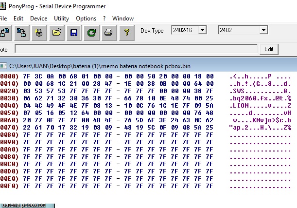

    Greetings to the forum from Argentina, my apologies for errors, I am new, I replaced the cells of this pcbox kant notebook battery, they were inflated and punctured, the new ones are the same as the original ones and they are perfect, I loaded them with a separate source of 3, 7v are two 3.7v 3600mah cells, in windows 10 it shows me 100% charged but if I disconnect the charger it turns off, it uses a sq2060a chip with a 24c02, I read this one with Ponyprog (I upload the file) to see if someone can restore the values or correct errors if you have them, thank you very much in advance.
    PS: I only have Ponyprog to read and write
    Is what I get with the ponyprog, what values should I change?
    Czy to co dostanę z ponyprog, jakie wartości mam zmienić?
    • Ponyprog - replaced cells 3.7V notebook battery ponyprog.jpg (139.73 KB) You must be logged in to download this attachment.
    • memo bateria notebook pcbox.rar (267 Bytes) You must be logged in to download this attachment.
  • EEPROM file appears to be the fault source

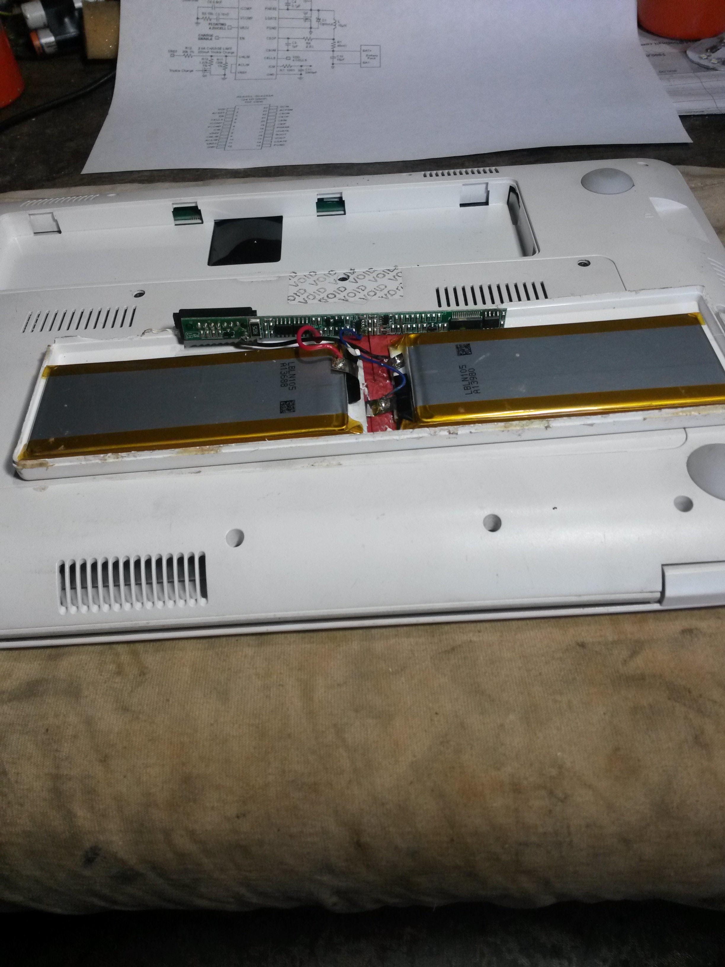

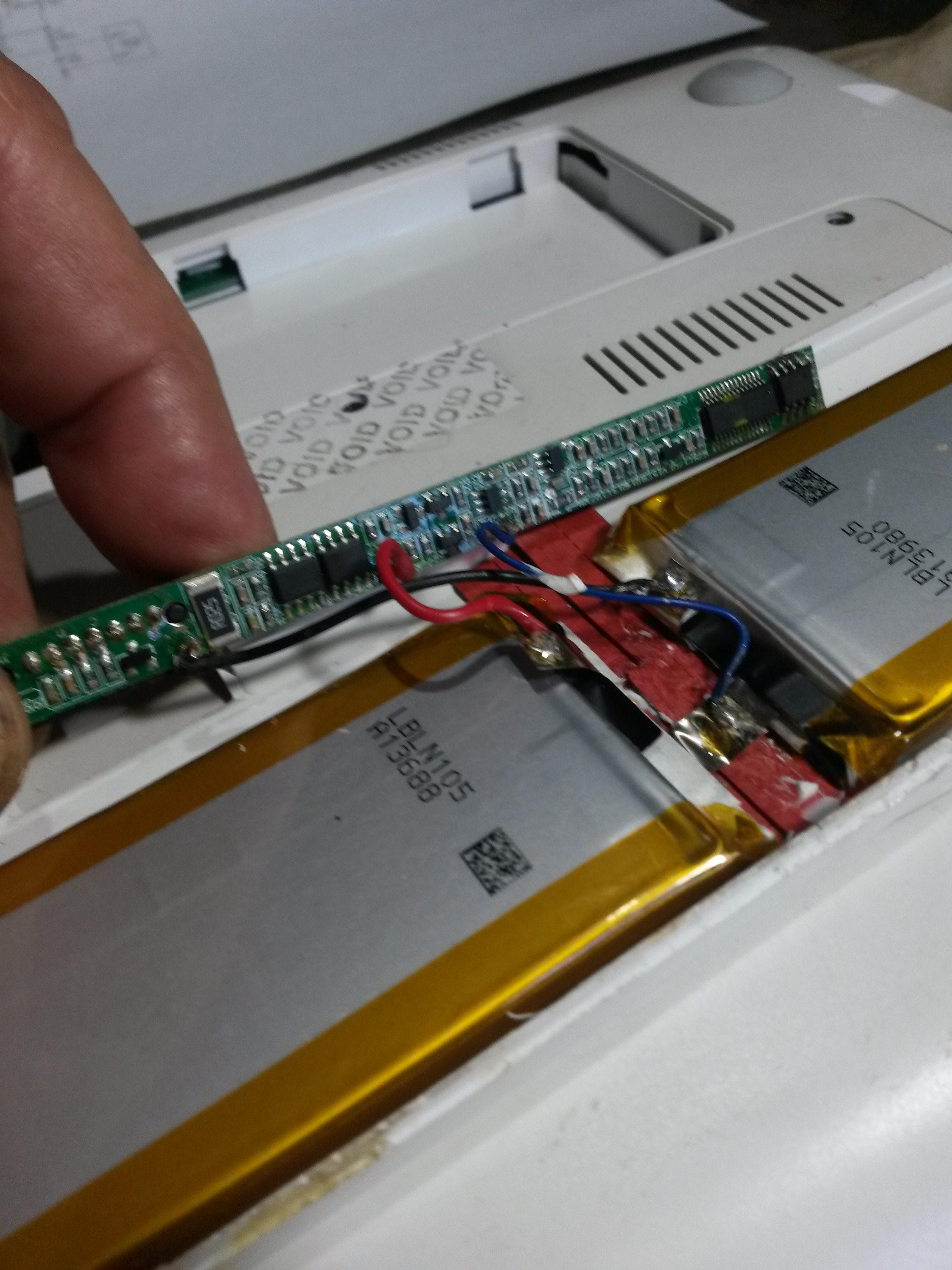

    I add photos and the file in .bin
    The problem is definitely in the eeprom, I loaded the one that rudiksam uploaded here: https://www-elektroda-pl.translate.goog/rtvfo...x_tr_tl=es&_x_tr_hlsc=es&_x_tr_pto=op and at least the indicator led battery flashes, but I don't know what voltage corresponds to this .bin, if someone could tell me how to restart the one I uploaded, it would solve the problem, I'll try the rudiksam one and say if it works well, thanks.

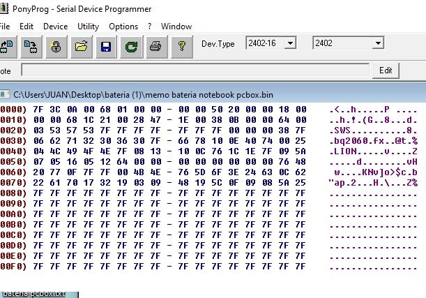

    No cóż koledzy, znalazłem rozwiązanie, wstawiam je tutaj i zamykam temat, aby mogło się przydać innym, eeprom musi być taki Ponyprog - replaced cells 3.7V notebook battery
    Well friends, I found the solution, I put it here and I close the topic so that it can be of use to others, the eeprom has to be like this
