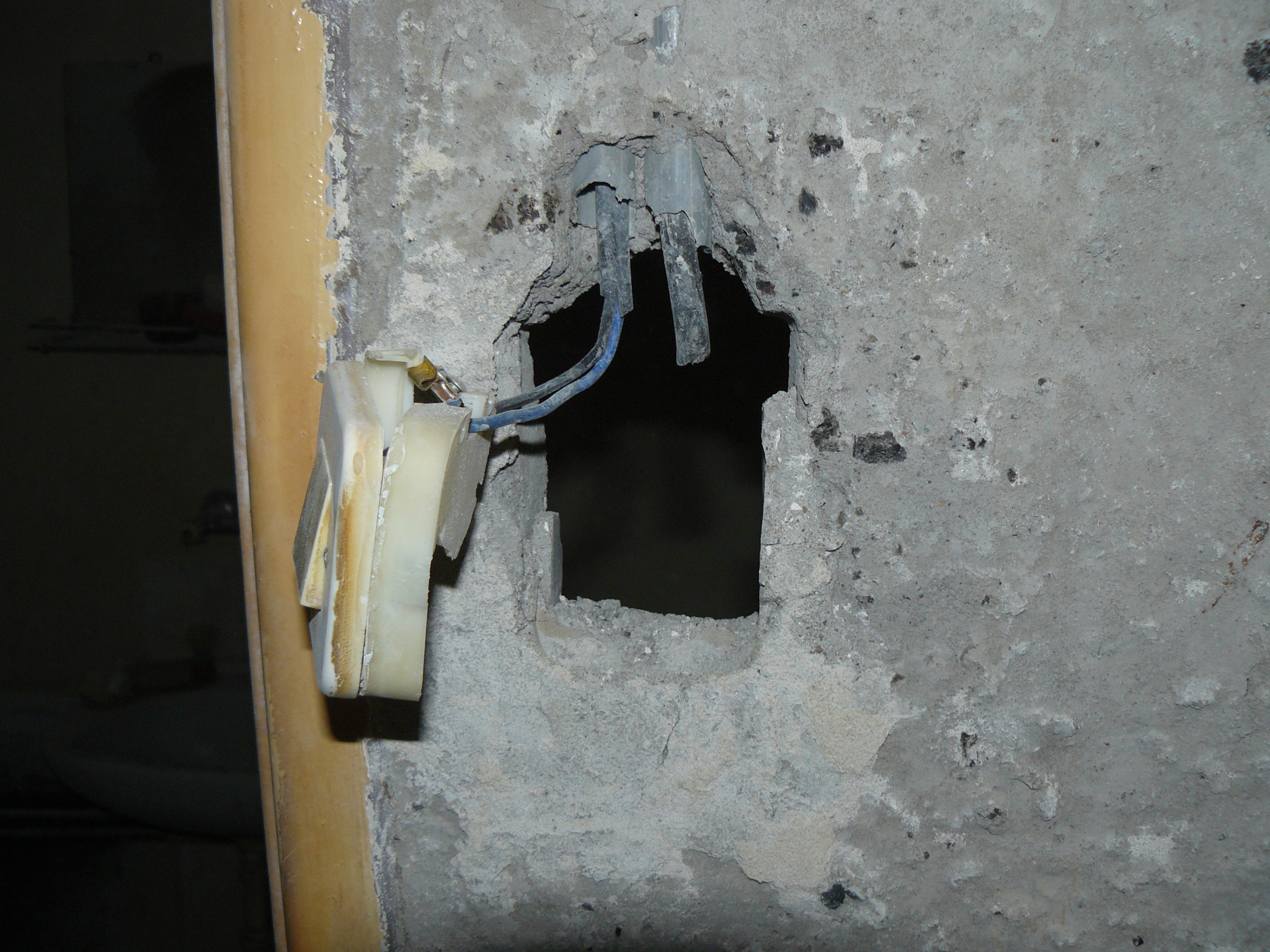

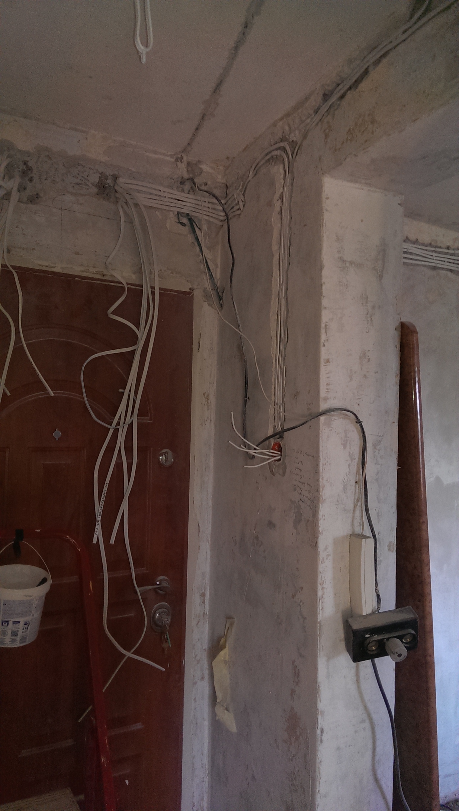

  • #14 16029542
    paulex80
    Posts: 176
    Rate: 27
    mawerix123 wrote:
    In the screed probably and the sockets at the floor, I just do not know how the connectors because the lamps probably at the neighbor higher let

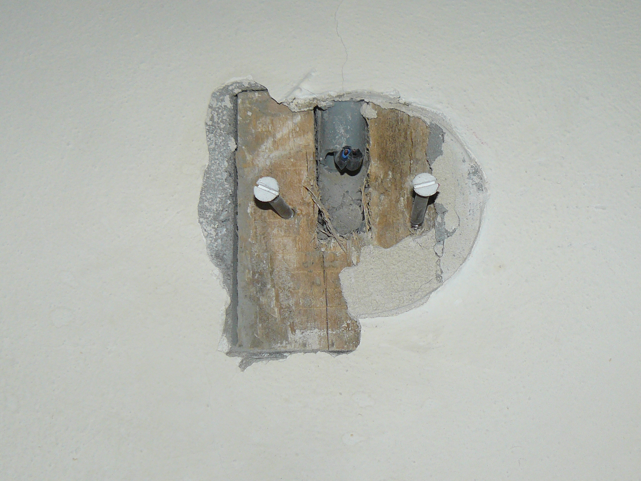

    I will show a photo of the box:
    Renovating Block of Flats with Big Plate from '92: Electrical Wiring and Surface-Mounted Box .
  • #15 16029559
    retrofood
    Posts: 31317
    Help: 1140
    Rate: 4798
    mawerix123 wrote:
    I asked because not so long ago I was doing a block of slab plaster was on wires. Alu installation was fixed on gypsum cakes and the whole thing was covered with plaster with communist diligence..... "hey mountains and valleys" ;)
    I think it should not be assumed in advance that there is no plaster on the slab.
    I have also encountered installation furrows in places, which Luke-O once mentioned in some topic and in them wires.
    If we are talking about a large slab, the conduits for cables were made at the slab production stage, as well as the holes for equipment boxes. Mounting furrows only in some places where partitions were made of pro-monta blocks. You can not talk about any plaster, only the joints of the boards were covered with it.
    Otherwise - it was not a great slab.
    This does not mean that the installation can not be done, but about easy should be forgotten.

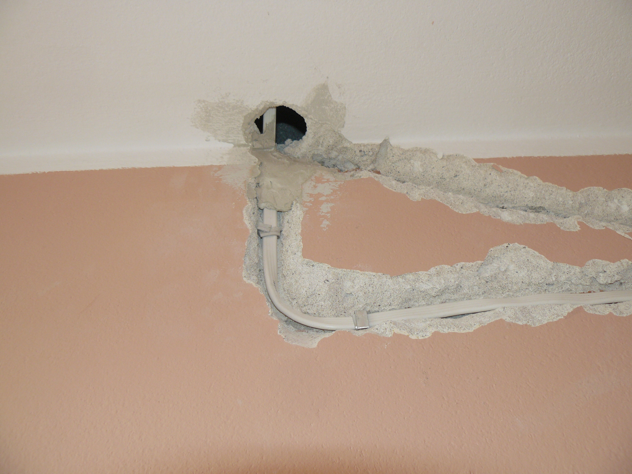

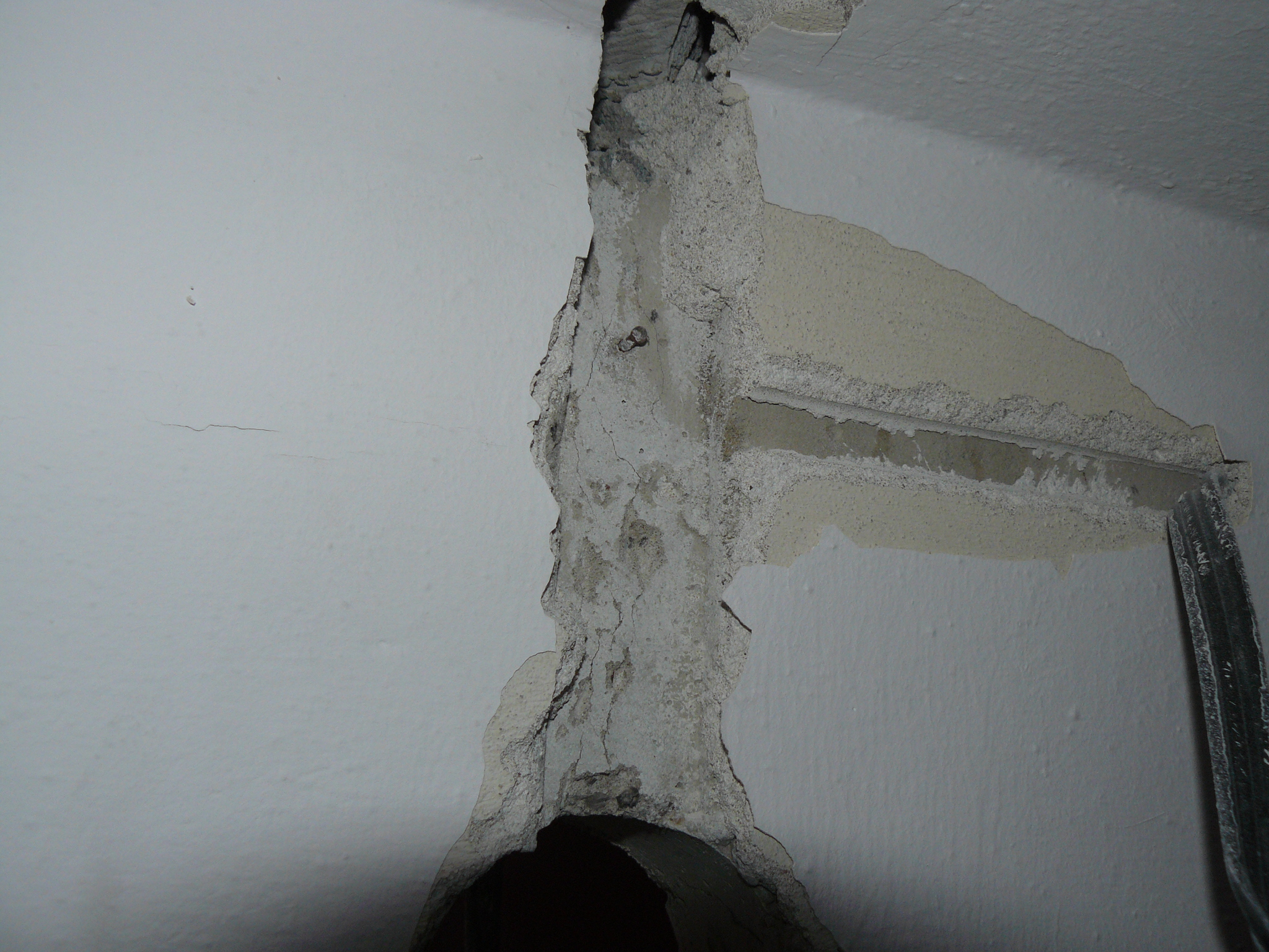

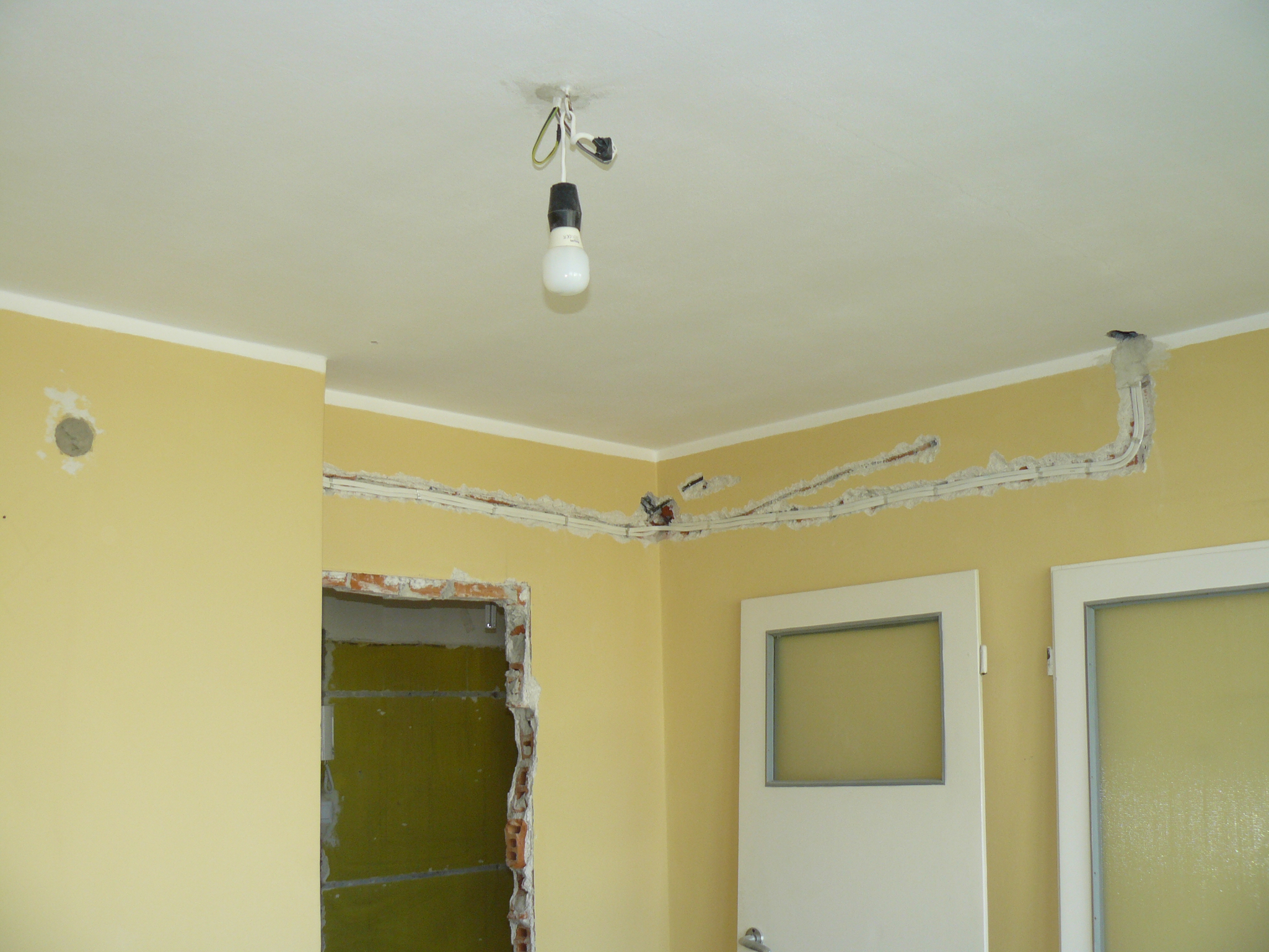

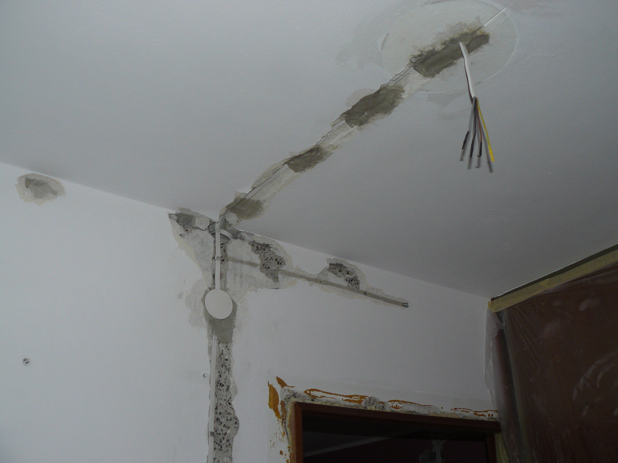

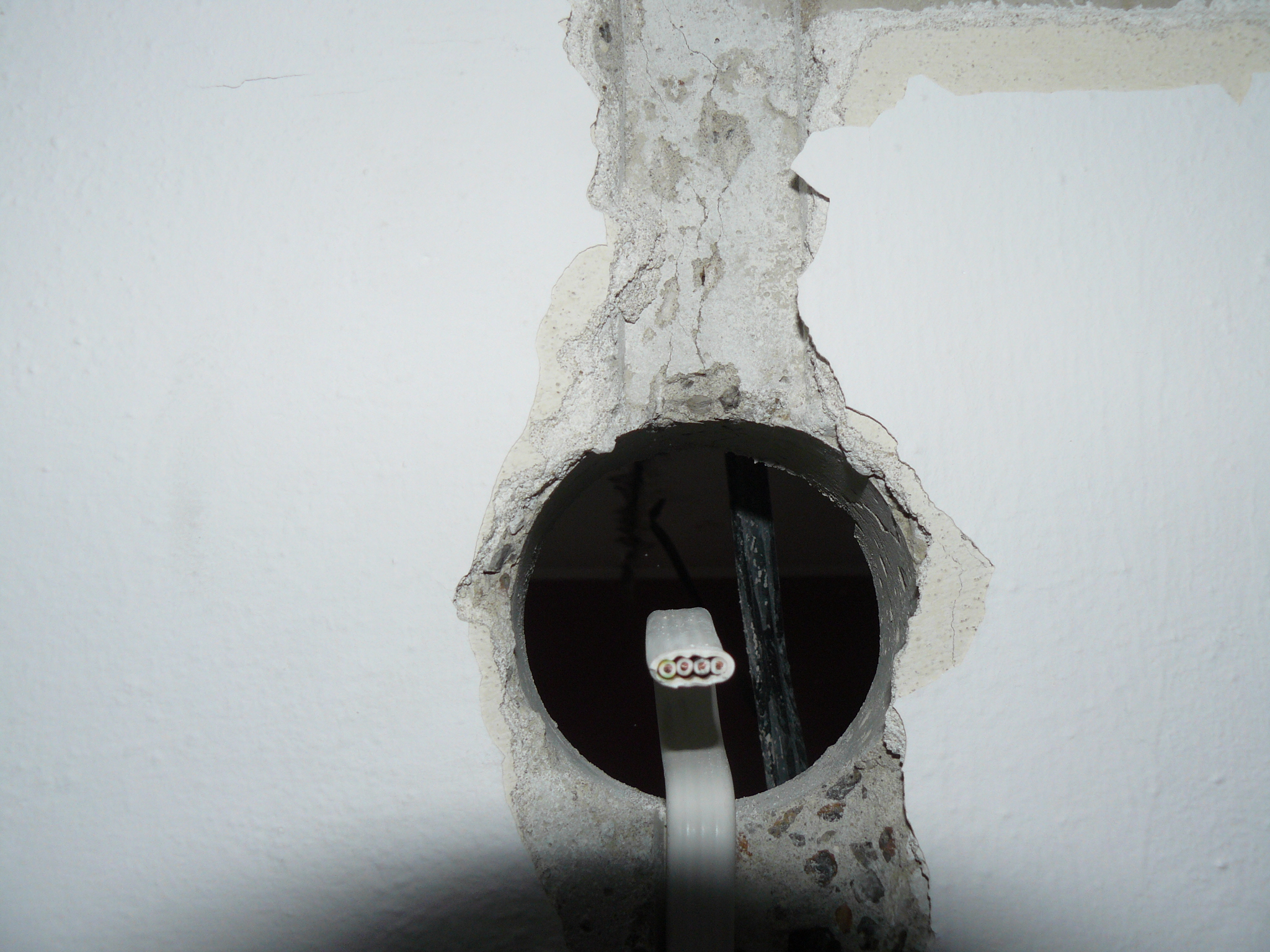

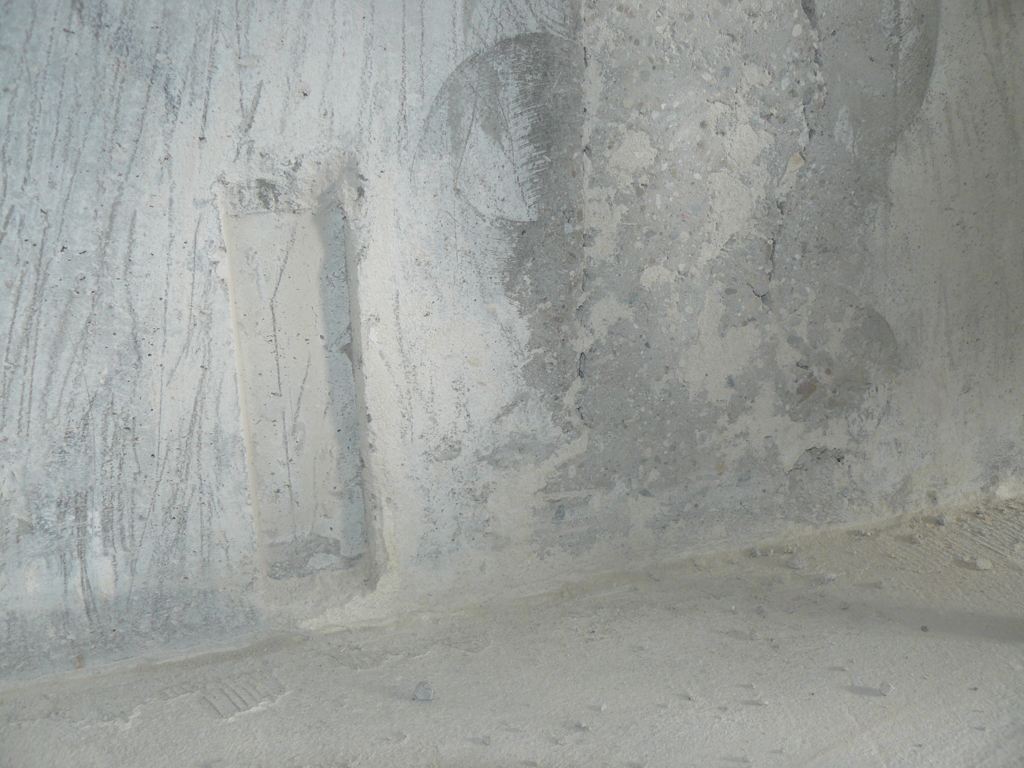

    Łukasz-O
    Admin of electroenergetics
    Posts: 21789
    Help: 654
    Rate: 4292
    seemingly gone but meets ;)
    Good, you got it right :D

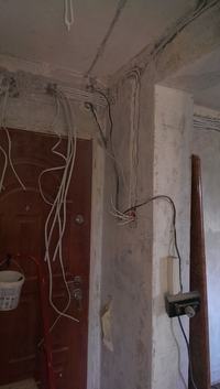

    What about the big slab. You can't generalize, because as many great slabs as there were solutions, changing at the turn of the year.

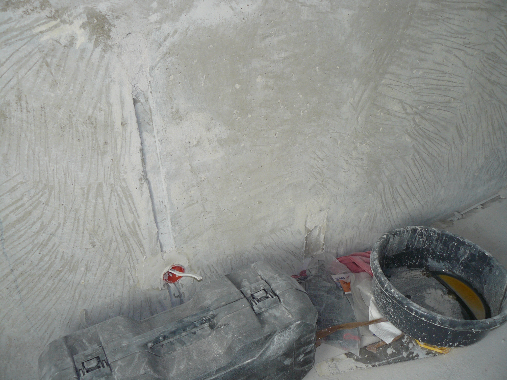

    There were slabs with furrows and holes made at the production stage, here an example for solid slabs:
    This one shows the uncut factory cavities and the hole for the box:
    Renovating Block of Flats with Big Plate from '92: Electrical Wiring and Surface-Mounted Box Renovating Block of Flats with Big Plate from '92: Electrical Wiring and Surface-Mounted Box

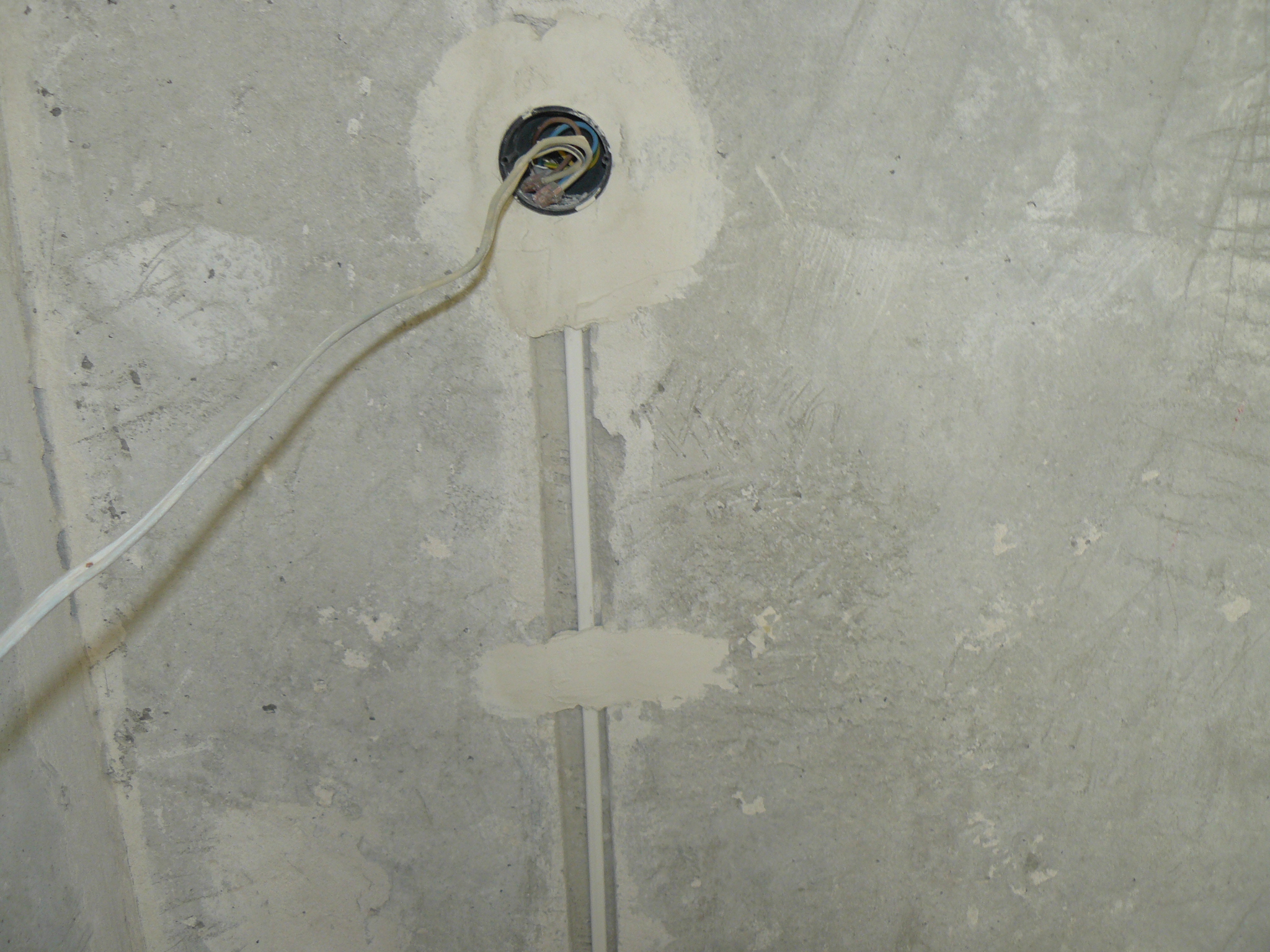

    Without the plaster you can see it better:

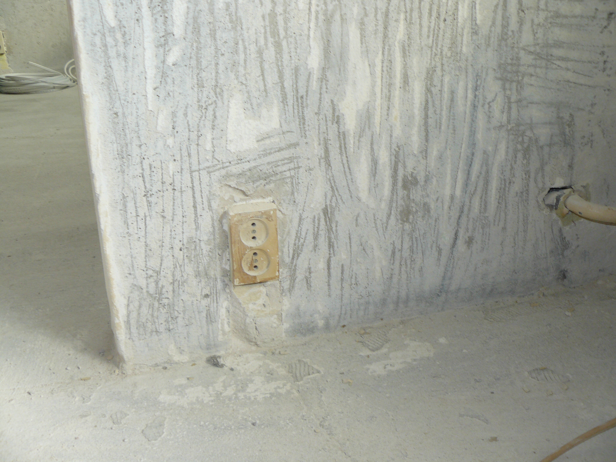

    Depressions for sockets (surface-mounted):

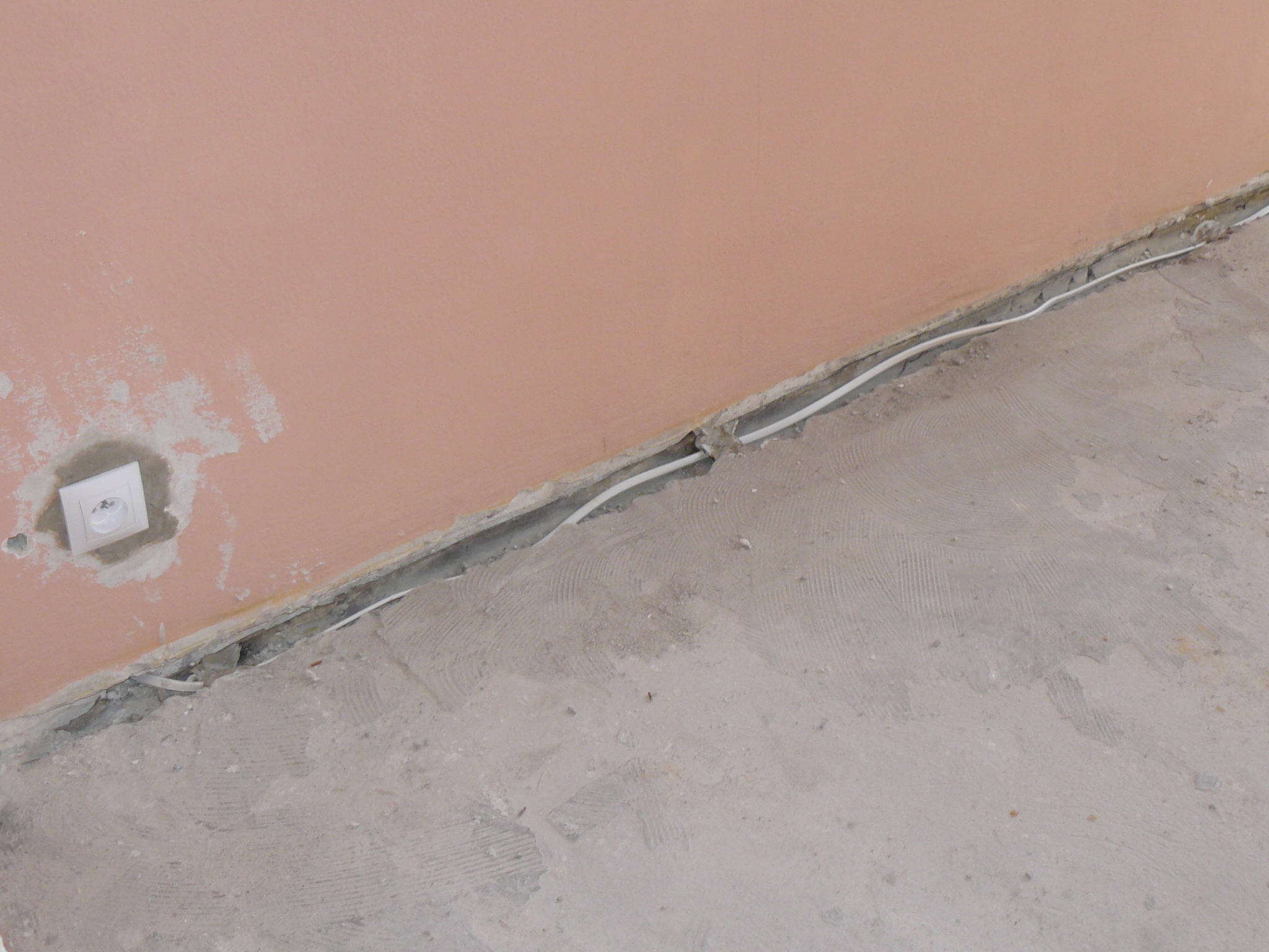

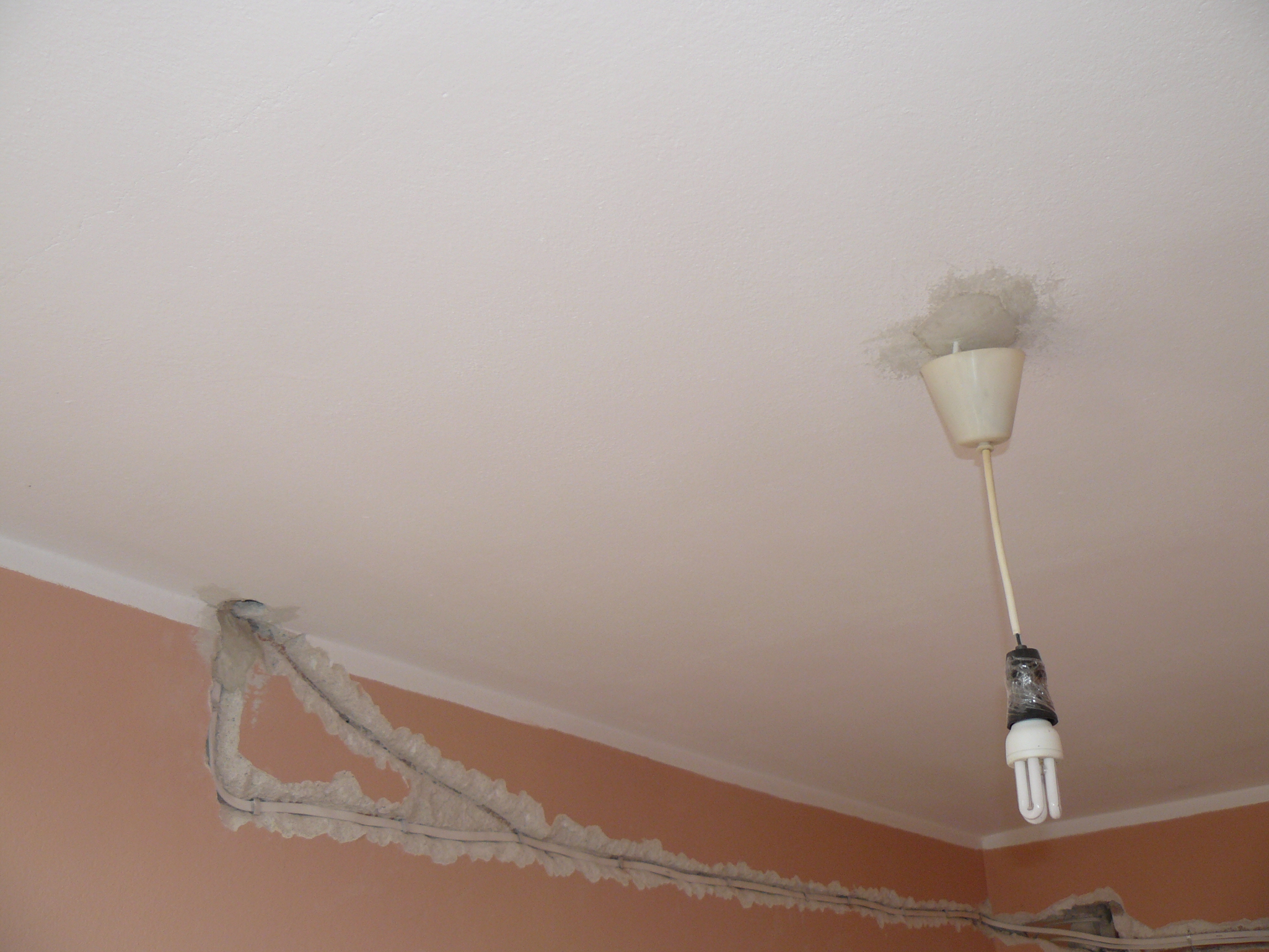

    In solid ceilings, expansion joints between tiles were used for overhead lighting, or cables were run under the spout of the neighbor one floor above.
    Example of placing a new cable in the expansion joint, without disturbing the slab structure (along the old route):
    In slabs with ducts, the installations were just stuffed into these ducts, so called.
    Renovating Block of Flats with Big Plate from '92: Electrical Wiring and Surface-Mounted Box Renovating Block of Flats with Big Plate from '92: Electrical Wiring and Surface-Mounted Box Renovating Block of Flats with Big Plate from '92: Electrical Wiring and Surface-Mounted Box Renovating Block of Flats with Big Plate from '92: Electrical Wiring and Surface-Mounted Box and use for general outlets (by the way, the installation was run in the spout:

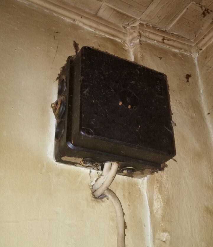

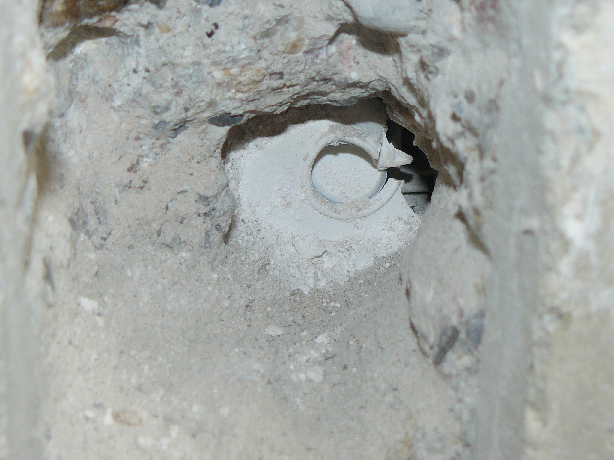

    Very often after forging the old box, the neighbor's box appears to the eye:
    Renovating Block of Flats with Big Plate from '92: Electrical Wiring and Surface-Mounted Box :D
    Times, some structural components such as. complete bathroom cabins had factory-submerged PVC pipes into which wires were inserted at the construction stage:
    Removal in a large slab is difficult but does not mean impossible.

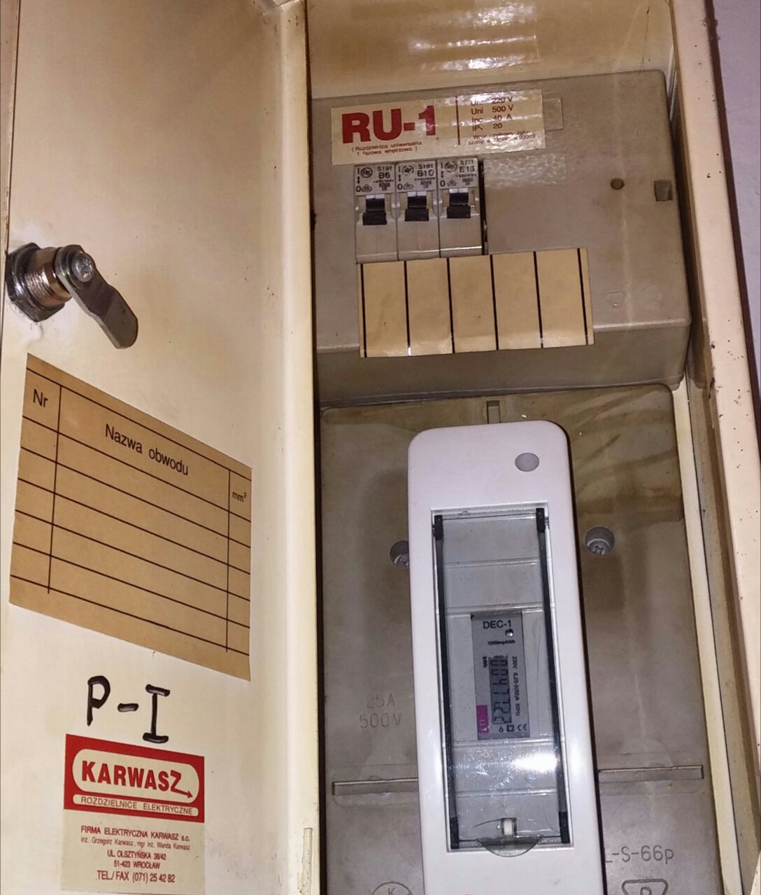

    This is the only box in the apartment that you can see, behind it on the obsolete is the corridor and the apartment's energy meter.
    • Renovating Block of Flats with Big Plate from '92: Electrical Wiring and Surface-Mounted Box IMG_20161031_191201.jpg (142.54 KB) You must be logged in to download this attachment.

    But I asked about the interior of the "box" , not the meter and fuse board.
  • #25 16030903
    paulex80
    Posts: 176
    Rate: 27
    elpapiotr wrote:
    But I was asking about the inside of the "can" , not the meter and fuse board.
    But this can I did not disassemble on Saturday I will look at it inside and make a photo documentation.

    There were standard CPR cans in the OWT system. The box in the author's photo is some kind of hybrid WITH terminal strips probably inside. I'm also puzzled by her enclosure. I wonder if she was there from the beginning or someone built her in later. On the other hand, CPRs in OWT were not mounted under the ceiling. Hence, it makes me question whether it is OWT or someone "along the way" reworked the installation.
    Added after 1 [minute]:
    paulex80 wrote:
    but I haven't disassembled this can on Saturday I'll look at it inside and do photo documentation
    Footage desirable but remember safety when opening it because under the lid wonders can be.

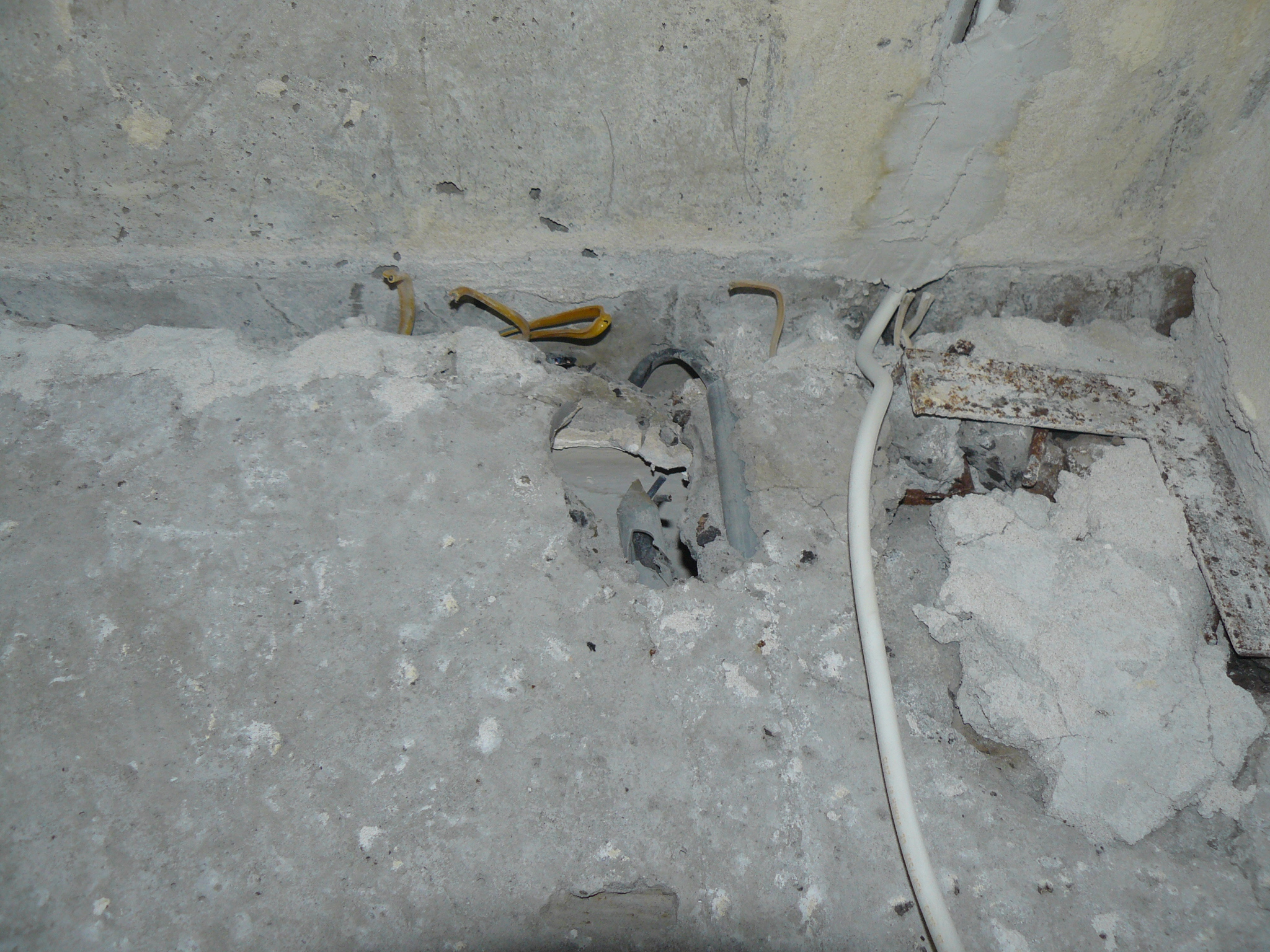

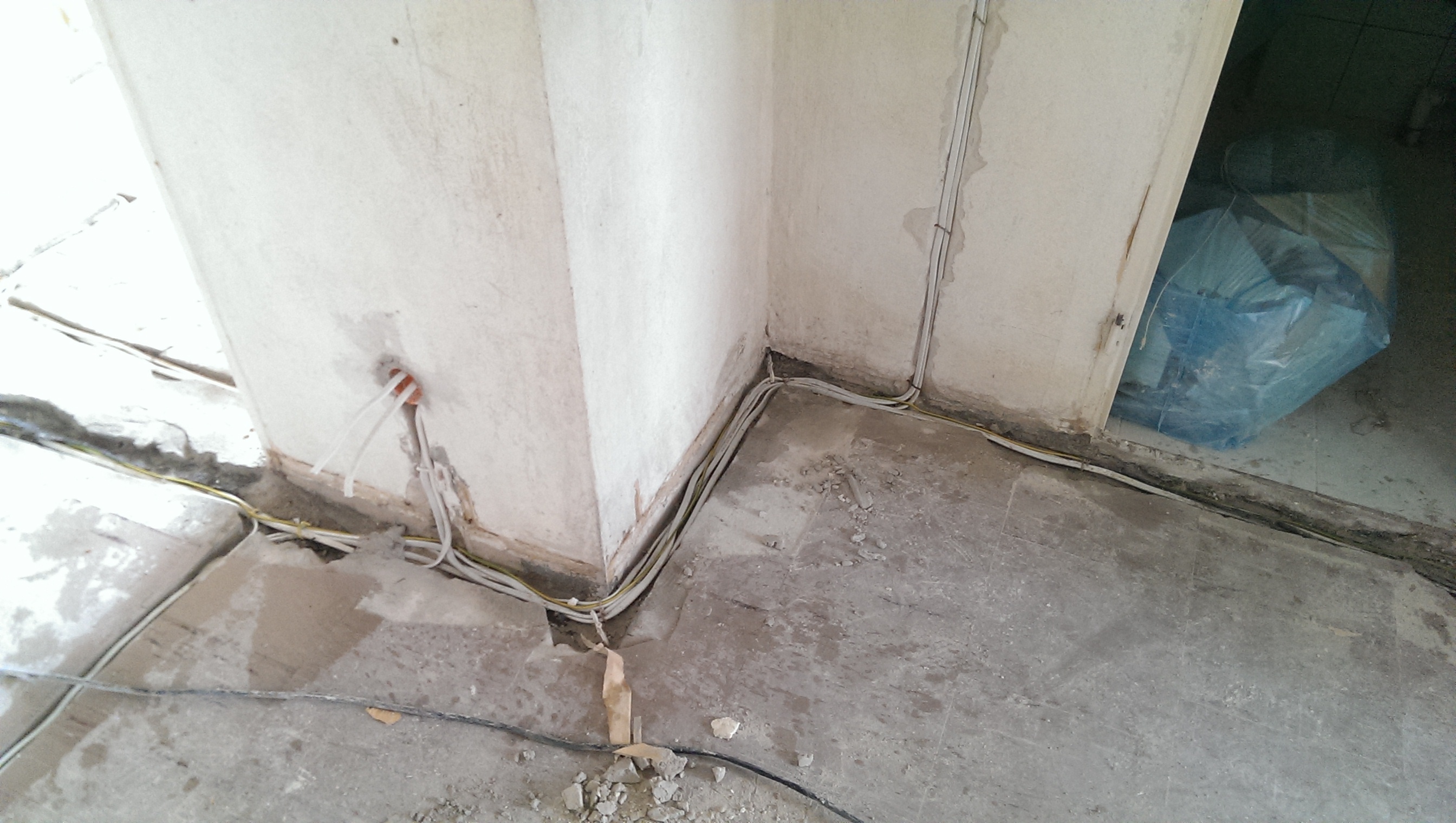

    Brivido
    Posts: 2862
    Help: 226
    Rate: 430
    Sometimes and did not regret the plaster ;)
    And sometimes, as someone said it, you have to hide the wires under the emulsion
    or in the screed
    You can even see the neighbor's black wires here.
    And Luke, well please, and I read on the electrode all the time that there is no problem to buy a 4x wire with a blue wire :D .
