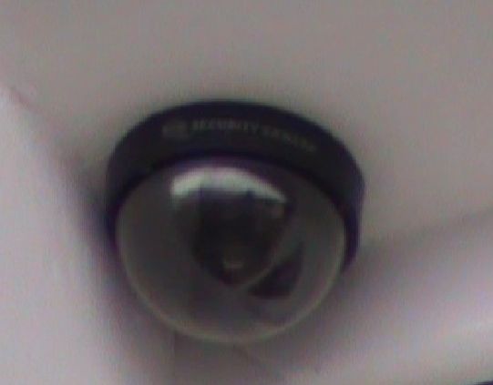

    Question to the author of the topic - how far is the camera from the window?
    Gentlemen, excluding the legal / shutter aspect - the image generated by the camera provides the owner of the camera with material, in my opinion, only illustrative from the yard.
    How much space in the frame can the window take up? If the cameras are monitored by half of the yard - probably not too much. On the other hand - if the maximum focal length is set (to be as close to the "four circles" as possible) - the window may not even be in the field of view.
    The psychological aspect and the magic of American cinema works ...
    And one more thing - it seems to be the most important in the whole topic. Spelling. Is no one offended by a bull in the subject, which is additionally thoughtlessly duplicated ...?

    It can be any camera, although it does not seem to have IRED lighting,
    It can also be a dummy ...
    Is the yard bright at night?
    Blinding it during the day will not work anyway, I would try to raise the background level, i.e. illuminating the windows with infrared light - it should give an effect similar to a mirror (at night), and it will not have a negative impact on the effectiveness of car observation.

    The camera, even from the lowest price and technology shelf (and in my opinion, is in the photo attached to the previous post) is not defenseless against attempts at "blinding attacks". Probably installers-practitioners know about this:
    - the intensity of the light reaching the camera decreases with the square of the distance (the value of the distance is raised to the second power)
    - if any light source, even of extremely powerful intensity, emitted from a source outside the frame - is not a threat to the camera
    - if the camera is a color camera - there is no sense in using infrared as a source of interference or glare
    - cameras have different exposure automatics mechanisms
    - there is no stronger light source than the sun's rays - damage to the camera sensor (CCD / CMOS) may cause the sun's rays to fall DIRECTLY on the sensor - for a long time.
    In addition, I would like to add that if the camera from the photo attached to the previous post is used to observe the yard - its author can sleep peacefully.
    And one more thing. I believe that any consideration of interference with electronic security systems should not take place in this forum.
    Fortunately, the hitherto advice of "experts" on camera dazzling shows a lack of elementary knowledge of physics and the principles of operation of the camera. By the way - I am curious how many cases of "liquidation" of the camera by dazzling the participants of this discussion succeeded?

    Let's summarize:
    - this camera has no infrared,
    - if you took a photo from your own window, it looks in a different direction,
    - probably the image quality allows you to count the windows, not to look inside,
    - it is very possible that it is a dummy camera.
    Have you ever seen the image from that camera at your neighbor's?
    What was the picture quality?

    Hmm, I suspect it's a dummy or a toy camera :) I am interested in the method of installation, no cables to the batten boxes, installation as on a coffer or nida, unless hidden, hm suspicious, and the IR is red glowing at night, you will know that it has a light well :)
