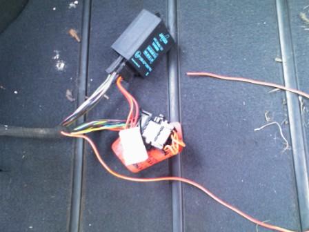

    Hello. I purchased a used bosal hook 026-411 for my astre 2 from 1998. However, after the plugs are plugged in, the turn signals on the back of the car disappear
    One orange and red cable remains unconnected as you can see in the picture which is probably the cause of this fault.
    can anyone advise you how to fasten it on the original plugins. I'm not really interested in hooking this hook for a short time directly under the lamps.
    How to connect Bosal 026-411 in Opel Astra II – no rear turn signals?
    Thanks in advance for the hints.

    Do you have any schematic for this module?

    I do not have the scheme. I got the hook from the guy I was buying a car pulled from another car

    So how do you know what to hook in? Look for wire splices because without it you can move ...
    Drop a better picture of this module, maybe someone has something about him and will share.

    The plugs are original because it is a hook dedicated, among others, to this model.

    It seems to me that this is only for flashers and STOP. It also requires a permanent plus. Does he have this plus friend?
    54 is the STOP line and L and R are the flashing lines. I do not know and nowhere can I find a description of the entry / exit of these RZ and others
    I link also with Electrode, but also not explaining what and how:
    https://www.elektroda.pl/rtvforum/topic960188.html#4892790
    Maybe colleague Wookiee write?

    The picture shows the outgoing connections socket with bridged orange wires.
    I have x-rayed it with a meter, I juxtaposed according to the meter's indications and everything goes smoothly.
