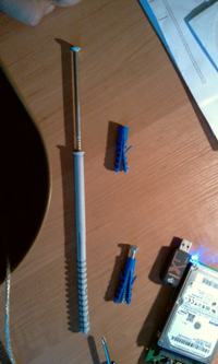

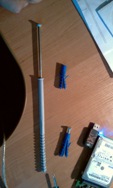

    He often mounts CDR 805 Q cameras from Vidicon, they are quite heavy. I used ordinary long pins, but it all flies like .... These plastics screwed into polystyrene would do the trick, but with the settings, you also like to do it: /

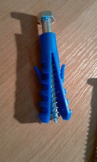

    In my opinion, the pins do not have to be that long. After all, you can drill a hole with a thinner drill, and with a thicker one, e.g. halfway - to gradate the hole.

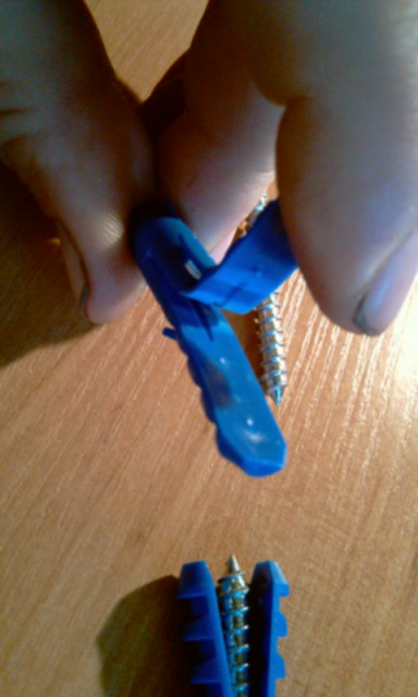

    To understand this, you need to know the structure of an expansion plug and the principle of its operation. Just don't answer that you know or you wouldn't ask that question above. The longer screw in the photo is just extended. Alternatively, I insert anchors and for this I buy a threaded rod which I shorten on the spot to the appropriate size. For small contact surfaces and structures exposed to wind, I put tubes on the screws. Thanks to this, the structure rests against the wall and you do not crease the polystyrene on which the plaster is laid, which, when screwed too tight, likes to crack. And then it falls off.
  • #19 9824371
    Jacek28
    Level 19  
    Posts: 565
    Help: 5
    Rate: 46
    It is not I who do not know the structure of the peg, but rather you did not understand the question. The question of the long screw is clear - it must reach both the pin and the polystyrene above it. In my opinion, a shorter pin (as A in the picture) would suffice and I do not see the need for a long pin (B). As for the tubes, it is a proven solution and I even installed a satellite dish this way with a very good effect (it has survived many storms).
    [CCTV] How to mount cameras on a facade with polystyrene insulation?
  • #20 9824741
    kkknc
    Posts: 23753
    Help: 1915
    Rate: 6709

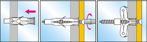

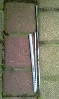

    I see that, however, you do not know the construction of the peg and how it works. Look at the first picture, the closer to the end of the wheel, the smaller the space, so the further you screw the screw, the more the pin will expand and, what is important, the greater length, which ensures its proper operation. [CCTV] How to mount cameras on a facade with polystyrene insulation?
    As you can see in this photo.
    The pin you see is starting to catch the first coils when it protrudes, it's about 100mm, so it won't provide a good and secure fit. Of course, the plug can be pulled out, but then there is a danger that it will begin to expand before it enters the wall and its further screwing will cause it to slide out of the hole and not properly expand or twist. Even if it expands in the wall, it will not only stick to a certain part, so it will not achieve full strength.
    You also need to know what the wall is, the worst case is ytong.

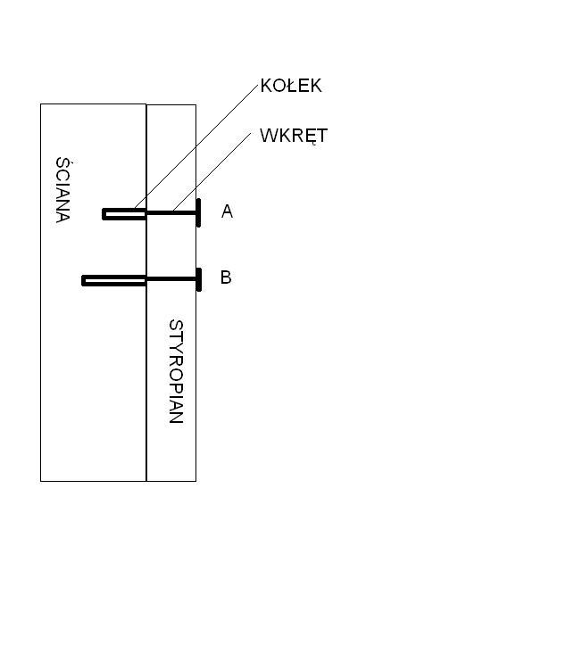

    I can see that it was you who did not understand despite the drawing I posted. I will put it as simply as I can: for the camera, such a short blue pin would be enough, as you put in the photo, but with the long screw as shown in the previous photo with a white pin. And when it comes to dowels, not all of them work the way you illustrated, and there are also some that tighten lengthwise when a screw is inserted, such as plasterboard dowels.

    sharp wrote:
    Only this "short pin with a long screw" will push the handle into the polystyrene as the screw is screwed in - there is no "limiter", which is the collar of the long pin.
    Especially if the spacing of the holes in the holder is quite small.
    Porotherm and various other hollow bricks are also annoying.
    As for pressing into polystyrene, it will be the same in the case of a long dowel that will hide the whole into the wall (that's why I cut the pipes that rest against the wall), and this is how I understood my colleague kkknc, since he wrote that he extends the screw by the thickness of polystyrene, the pin is hidden in wall. Therefore, in a situation where the entire dowel is hidden in the wall, I do not see the need to use such a length and I say (I have tested it on much heavier objects than the camera) that a much shorter dowel is enough, if the wall material is full, because if, for example, a block is actually such a longer pin would be better, but there are other solutions.

    I, on the other hand, use steel threaded rods + appropriate plastic pins + spacers made of plastic water pipes.
    I drill a hole in the polystyrene with a diameter equal to the outer diameter of the plastic pipe. I drill a hole in the wall for a plastic dowel. I cut a piece of the threaded rod and one end of the blade so that it can easily be screwed into the pin and push it apart. I put some mounting foam in, then push a plastic tube cut to the thickness of polystyrene so that it presses the end of the pin, and the other end is a distance for the element being mounted. A little foam inside the tube and screw the rod in. The assembly foam seals any gaps against water. I put the washer and nut on and press the tube against the wall and the stud. The protruding end of the rod allows the installation of any holders that have holes through and it is possible to screw them with nuts. If this is not possible, then first I put a piece of a metal plate or contour (such as is used in carpentry) and on this element I assemble what I have to install using self-drilling screws. The mounted brackets do not touch the facade but are offset a few mm, essentially the thickness of the washer and nut. In this way, you can fill any weight, even several dozen or several hundred kg, e.g. LED screens, billboards, antennas, of course by selecting the appropriate rod diameter and the appropriate thickness and length of wall plugs, and by selecting the number and spacing of such fasteners. I install the highest loads with such rods, shooting right through the wall and fastening with nuts and washers on the other side, hiding the washers and nuts in the plaster.

    Instead of the distance sleeves described by my colleague Plumpi, I used self-locking nuts with wider washers.
