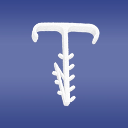

How should I fasten YDYP 3x1.5–2.5 cables to aerated concrete walls so they stay neat and secure?
Use USMP plastic cable holders for aerated concrete; they are suitable as long as you do not make the hole diameter too large [#15546555] If you want the cables to sit closer to the wall and the installation to be easier, several users prefer the plastic US type holders over metal pin/plate fixings, because they are quick to mount and hold the cable well [#15547815] For larger runs, a simple drilling template helps keep the spacing even, and a 7 mm drill was used successfully for 3x2.5 cables [#15548033] If you are working under plasterboard and want extra grip, peg + plate fixings can also work, but avoid metal fasteners where possible because of long-term corrosion and possible leakage/RCD issues [#15546653][#15547940] For neat routing, lay horizontal sections along block joints and mark verticals with a laser or string before drilling [#15547924]

    What is the best way to fix the ydyp 3x1.5-2.5 cables to the wall of aerated concrete? There are such plastic holders, but are they suitable for laying wires in bk ?. I have seen a method for plates with a pin and papiak, will it work when attaching to the bk?
    I think I'm looking bad, because I found only something like this on Allegro http://allegro.pl/uchwyc-aluminiowy-40x10mm-usmp-blaszki-do-gwozdzi-i6035861908.html
    Are there any other better ways to make the wires fit nicely to the walls and not fall off?

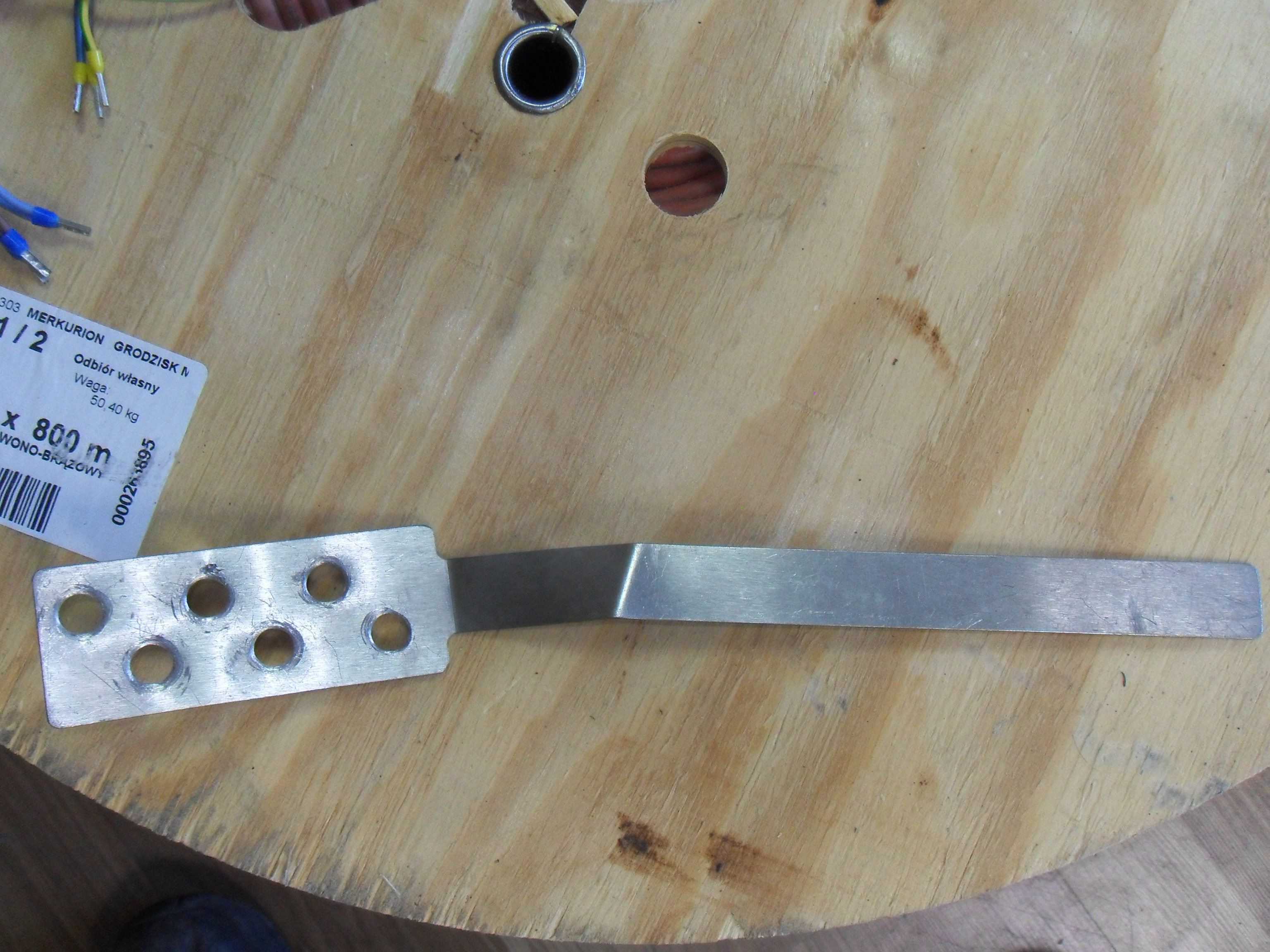

    I have always used standard fi6 pins, metal plates (for 1 cable 50mm and 2 cables 60mm) and papers.
    Remember to buy good quality pegs, because the cheap ones like to break off and fall into the chambers.

    Plastic USMPs are suitable, just do not overdo the diameter of the holes.

    There will be no plaster, only plasterboard with glue. So it's best to use the plastic ones?
    Won't they be better USMP-3 Bis? Best Methods for Securing YDYP 3x1.5-2.5 Cables to Aerated Concrete Walls and USMPH-3 Best Methods for Securing YDYP 3x1.5-2.5 Cables to Aerated Concrete Walls ?

    If it goes under the boards, I suggest a peg plus a plate, it will be better to hold and it is more comfortable to attach (at least for me).

    Most of them have cellular concrete blocks, so plastic ones would probably work there, but not really on ceramic blocks, except in the joints.
    Ok, buddy, but where to buy such badges with a pin in a set online? I was looking for the Allegro and I can not find these plates, i.e. they are complete with pins, but the shipping is more expensive than the product itself, although I will need at least a few hundred pieces anyway.
    Now I do not have time to go for it and if I had ordered it and it came, I would have laid the cables for a while.

    Buddy, where to buy on the Internet, I do not know too much. However, I would suggest you drive to some electrical store / warehouse.

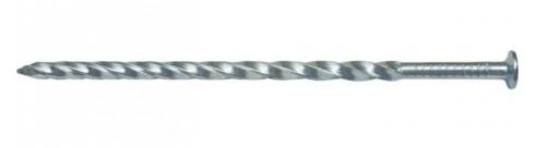

    I would also like to suggest that instead of typical papiaki I recommend galvanized twisted nails and 6 kpx pins - at the moment I do not remember the specific dimensions of the nails, tomorrow I could check it for you.

    Ok buddy, I found a cut aluminum tape, full of it 1-2-0209 & order = p could be those from the link from 1 post, but these papiaki and pins are probably a poor connection, I think the pins are probably best for empty spaces, so that they hold and do not fall out.

    Yes, buddy, buy yourself the 6cm. You can put two cables in parallel, or let the cable run individually - it makes no sense to separate the plates for one wire, and the plates for two wires separately.
    As I wrote before, the kpx pins have a smaller collar.
    Papiaki nails do not hold well. Plus, regular ones can rust over time. Galvanized curly and it will be ok.
    Galvanized nails, driven e.g. into belit, will also rust after plastering with gypsum ;)

    I will definitely arrange alu tape and pegs. If they rust, it probably doesn't matter under the plasterboard (?). Thanks to everyone for the help and information, pifka gone.

    Gentlemen, the world is moving forward, but I can see that a plate with a nail will probably outlive all generations of electricians.
    I use the handles from post 4 and 5 myself, you just need to choose the drills properly. Recently, I had to use ?7.
    In many cases only nails :)

    One more question, does anyone know how many alu tapes or plates are in such a 1 kg package? because I do not know whether to take by weight or by weight and I will definitely need several hundred.

    And at least 2,000 holes with handles in each apartment :) I recommend these handles.
    Recommends Plastikon handles over Bis brackets for cable mounting

    I use US type handles and I am very happy with them, it is made quickly and conveniently. All you need is a drill, a pack of handles in your pocket and wires to lay :)
    I have used products of various brands and I like the ones from Plastikon.
    I did not like the Bis-type brackets due to the less convenient laying of the cables, there were cases of the cable sticking out of the wall when using them.
    If a colleague has such an opportunity, I recommend trying both methods: on the handles and on the plates. The best opinion on mounting technology is based on your own experience :)

    Man, but you messed with my head :) . I can see that what Fachman praises me, I do it for myself and not so much as comfort and reliability counts, it is known that it will not be visible when plasterboards stick, but it will not happen soon and it has to be done until then hold the walls well and not fall off. I would like to remind you that I have walls made of aerated concrete, so it is impossible to hammer a nail with a plate like this, the pegs have to be there.
    The plates with pins are more expensive and there is a bit more work to do with them, but they seem so more pro to me. Plastic is definitely more comfortable and, as the name says, faster to install.
    In addition, I want the wires to fit perfectly to the wall, so that they do not reflect plasterboards, and with plastic ones, I think they stick out more.
