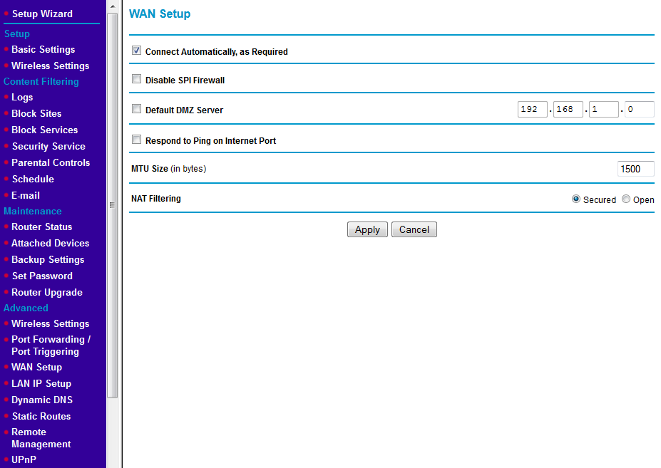

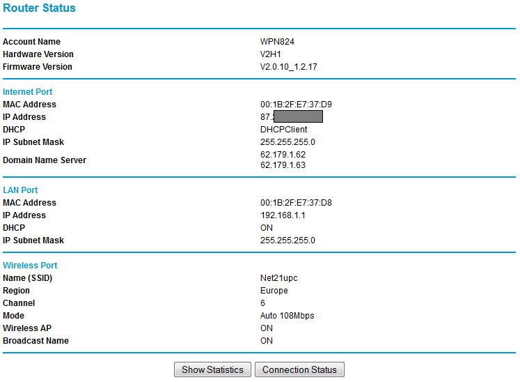

    In fact, I did not catch your post: / But I am answering, basically I will throw a screen so that there are no understatements.
    But before that, I want to point out my first question "How to do it and how to check if it was successful?". I also meant, in case I managed to redirect the ports so that I had a router and an external ip on the laptop - how to check if the ports are really well redirected? Is it working?
    And another screen from the router settings, maybe you need to set something here:

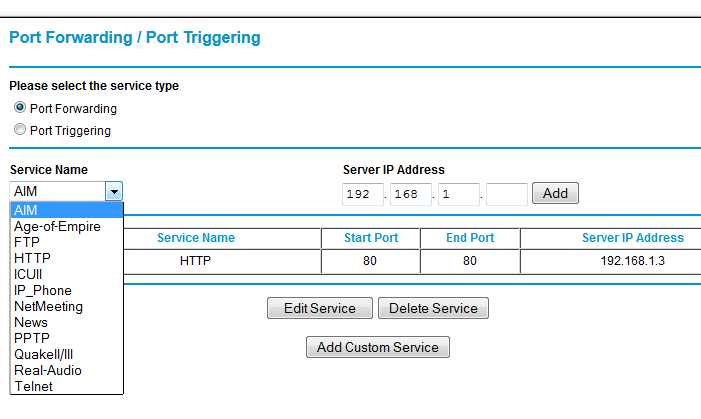

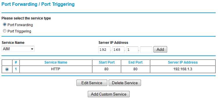

    @ kleer94, I wrote that I mean port forwarding: /
    Anyway, I will add a redirect screen: (I will add that 192.168.1.3 - this is the internal ip of my laptop, which was assigned to me by the router).
    Determine & Set Up an External IP Address on Laptop with UPC Modem/Router Connection
    You can now see my settings in this and the previous post. Is the port forwarded well, that I can figuratively say that my laptop now has an external IP? And how can you check it?

    Your laptop still doesn't have an external IP, but is now port forwarded to it.
    Yes, the port should now be correctly forwarded.
    It's best to download a http server, e.g. Apache, which is free, the most popular, etc.
    When you have already unplugged this server, after typing in the browser "127.0.0.1" on this laptop should display "It works!" or something like that. The same should be displayed if you type in the browser the address from this page: http://www.whatismyip.com/. You type in the address bar eg 83.21.41.234 and it should show the same page as when you typed 127.0.0.1. If this is the case, you have port 80 redirected to your paw and you can, for example, build a website ;)

    Set up a proxy in your browser and try to enter your IP address. You will enter as if "from the outside" and if you have a web server set up, the page should appear.
    From netgear we would like the status tab screen.
    In the screen two posts above there is a DMZ option - if you enter the laptop's IP there, all ports will be redirected.

    After I set up Forwarding and did nothing DMZ or proxy. After typing ext. Ip the page "does not answer too long". At the same time, I do not have any http server set up yet. What should show up then?

    Finally, now we know you have a public address on the router's WAN.
    First of all - do you have a web server running on the 80 / tcp port on your laptop during the tests? Secondly, you can confirm the open port, correctly redirected to the listening service, on http://canyouseeme.org/ . You have a redirection set up, leave the DMZ alone for now.

    Approx. I will say differently in the Forwarding section, how to set a specific port? Because for HTTP I can't change from 80. The choice is as shown in the screenshot. I would like to open one port to the world.
    #25 10018282
    salmon
    Posts: 3477
    Help: 435
    Rate: 262
    You have the "Add Custom Service" button at the bottom
