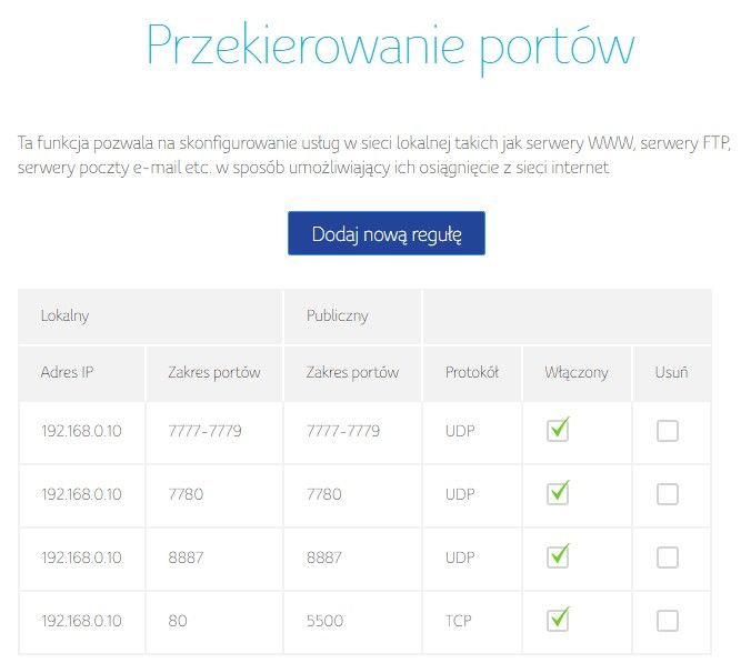

    Under "Advanced settings -> Security -> Port forwarding" I have this rule (the game server listens on port 7777 - locally you can connect):
    How to Forward Ports on UPC Connect Box with Compal Modem (Hardware v5.01) .
    However, from outside you cannot connect by router IP and port number. I tried with DMZ enabled on the local IP and same thing. I disabled the firewall, disabled UPNP, no change.

    This is the rule I created earlier.

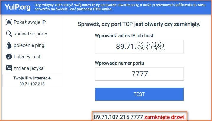

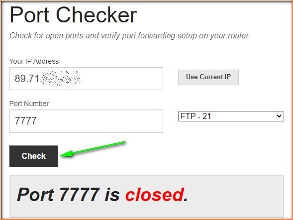

    I checked the port availability from the outside:
    The outsider obviously cannot connect to the game server.

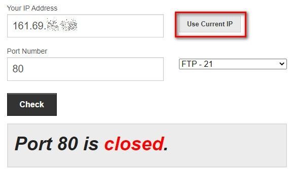

    For example, I checked for example port 80 at my place - closed:
    Port 80 on onet is open:
    And on onet this port is used non-stop.
    192.168.0.10 is the address of the computer on the local network where I run the game server.

    Check the ports here:
    https://yuip.org/pl/port-check
    For a port to be open, something/someone has to be using it!
    But I then asked an outsider and they couldn't connect to my game server by entering the IP address of the router and port 7777
    Additionally, on the UPC the IP address is external but dynamic - change the IP address and again no one will connect to the game server.
    It's not a problem, because I can always provide an IP number, or use a DDNS service.
    Here check the ports: https://yuip.org/pl/port-check .
    I have checked and it is the same:
    Or do you have a Compal modem on UPC and port forwarding is working for you?

    Current port forwarding:
    In the Windows 10 system firewall configuration, there is a rule enabled for incoming connections to this server (to applications) for TCP and UDP on all ports - I will check again this afternoon to see if anyone can connect to this game server.

    It works - once UDP port forwarding is correctly configured, you can connect to the game server on your local network.
