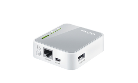

  • USB-powered WiFi-to-Ethernet client for Wake-on-LAN
    #9 13792844
    el_oscyppo
    Posts: 94
    Rate: 18
    Once I had the need to connect a stationary via WiFi to the Internet, but I did not have a WiFi card for it or any other USB card. Instead, I had an old Linksys router, which could be set in the "Client" mode - in this way, the WiFi card for this stationary became a router connected with a LAN cable. It worked. The only inconvenience is that the router needs a separate power supply, but ...
    http://www.instructables.com/id/Cheap-and-Easy-Arduino-Wi-Fi-Hack/
    ...I came across something like this on the net. The idea is the same, but instead of a router, we have an Arduino powered by 5V USB, and as you know, most laptops / stationary devices have an active USB even when the equipment is completely turned off (e.g. to charge the phone).
    My additional question in this topic is: has anyone come across a ready-made device operating on this principle? This is: a WiFi client that plugs into a USB-powered LAN socket (sounds devilish, I know :) )
    If not (and probably not) - this is a very interesting idea for a project to be made, which probably many people would benefit from.
    Refreshing the thread, I propose a discussion on how and using what hardware (Arduino? Raspberry Pi? something else?) to make such a device while maintaining small dimensions. The universal Wake-On-LAN module over LAN over WiFi sounds interesting :)
    by the way, greetings to forum users :)
  • #10 14233226
    tomoa
    Yes, there is something like this, e.g. the TP Link TL-MR3020 router.
    The device can operate in three modes. In one of them (client) it connects to the router (access point) via wifi and forwards the signal via RJ-45 cable.
    Remember to clone the mac address in the router (client), otherwise there will be problems.
