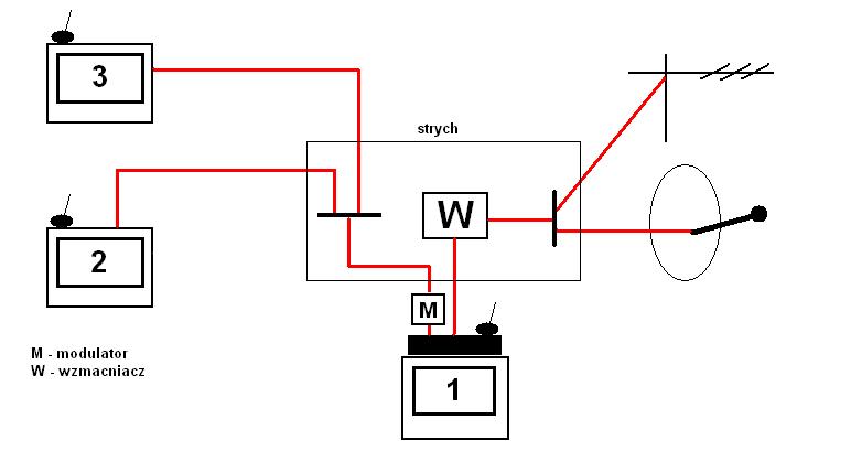

    Currently my setup looks like the picture. The signal from the satellite and the terrestrial TV antenna is combined in the attic with a combiner into one, amplified, then it goes to the decoder in the living room and returns to the attic with the signal with the selected digital TV program (in analog form, of course).
    Then it is distributed around the apartment (there is a splitter in the attic). There is also a radio remote control extender in each room. Of course, on all TVs there is a program selected on the set-top box, which is a nuisance.
    Why do you need two cables from the antenna for a set-top box with recording
    I want to install an additional multiroom decoder in room 3. It is possible not to run a cable directly from the converter to it, but to connect it via LAN (this will not be a problem). Then you can't record on the main set-top box, but I'll live with it. (green color option). I guess that should work?

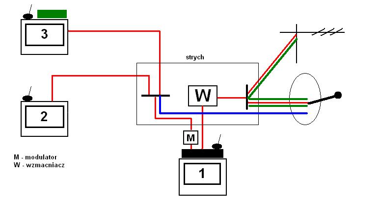

    The second option - I run an additional third cable (blue) from the converter directly through the splitter to room 3 and then I have all Multiroom functions in both decoders. I want room 3 to also have an analog signal from the master decoder, including the signal from the terrestrial antenna - will this work?

    Regarding picture number 1:
    what kind of amplifier is used there and what (is it really?) is the satellite signal amplified?
    It is not possible. The multiroom decoder is a normal satellite decoder and must have a direct connection to the converter.
    The cable from the converter cannot go through the splitter, but directly to the tuner (sending voltages and signals to the converter!)
    Instead of an amplifier, install a 4-output multiswitch in the attic and the problem will be over. You will also need to replace the converter with Quatro and run 4 wires from the converter to the attic. Then you have 1 cable from the attic for each receiver. At its end, you will mount TV/SAT sockets and you will be able to connect a single satellite tuner in each room. If you need a second SAT signal in any room, you will
    on this route either a second cable or the Twinsender mentioned above.
    From what I remember, it was mainly about amplifying the terrestrial TV signal, which was weak then (now it is strong, so the amplifier is probably unnecessary). And by the way, the SAT signal is amplified.
    I don't know exactly what kind of amplifier this is, because it was assembled 15 years ago, so big, in a massive iron casing.
    But now it passes and the amplifier and works.
    Ok, I can send it directly to room no. 3. Can I connect the same second TV / SAT combiner on the way to also have a terrestrial TV signal on the second decoder or on the TV right away?
    link
    So - one combiner, what is now, then TWINSENDER (the amplifier must be thrown away, because it is written that there can be no amplifier between the receiver and the transmitter) and to the main decoder.
    On the second combiner, the third cable from the converter and the signal from the TV antenna (previously divided by a splitter), and then to room no. 3.

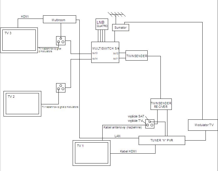

    The installation should look like this:
    Each TV has access to terrestrial signals.
    Each TV has access to a satellite converter.
    Each TV set has a signal from the modulator.

    I understand that the sockets must be replaced with those with separation of TV and SAT signals.
    http://www.dipol.com.pl/gniazdo_koncowe_signal_rtv-sat_R694100.htm
    I'm still asking about the equipment if OK:
    multiswitch:
    http://www.dipol.com.pl/multiswitch_mp-0504_signal_5-wejsciowy_4-wyjsciowy_z_aktywna_naziemna_R6944504.htm
    or
    http://dmtrade.pl/index.php?p1160,multiswitch-pms-54-0
    Converter:
    http://dmtrade.pl/index.php?p760,lnb-quad-opticum-lqp-04h
    I also found a converter with a TV combiner, then the combiner in the picture falls off (and one cable at home) and I give the signal from the modulator to the multiswitch, right?
    http://dmtrade.pl/index.php?p1219,lnb-quad-digistar-terrestrial
