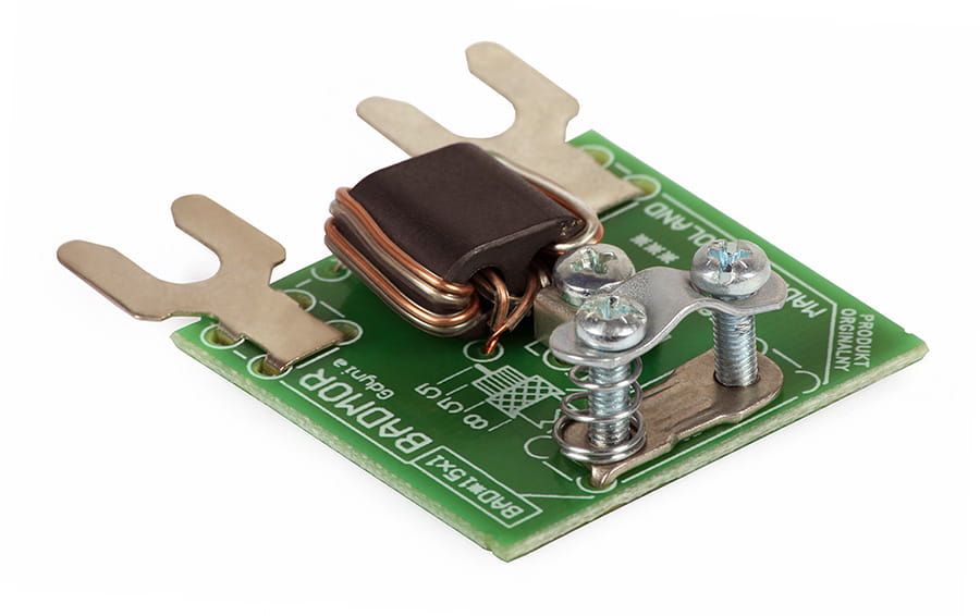

    I understand that in my case the amplifier is not needed, and is the impedance transformer necessary for my antenna?
  • Balun matching reduces noise and pattern distortion
    #32 20096973
    sq3evp
    Posts: 6728
    Help: 226
    Rate: 901
    BiQuad is approximately 50 ?. It will work but there will be noise and noise sensitivity due to this
    Use a transformer to match the symmetrical antenna to the unbalanced conductor.

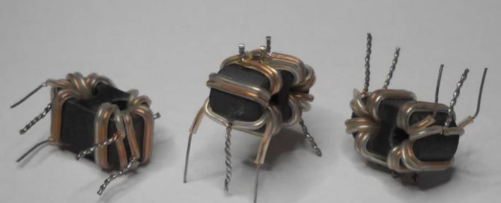

    A moderately advanced electronics engineer will convert each balun made on a ferrite core from the 300/75 ohm transformation to 75/75 ohms in a dozen or so minutes. It is enough to have soldering irons and an ohmmeter.
    This is the problem of connecting the ends of this balun.
    There is indeed a problem with Telmorowski 75/75. They are hard to get, unless they are surplus, they are often badly damaged by time.
    It can also be based on coaxial cable loops, but it takes longer and narrows the antenna frequency response.
    I used to make such baluns by winding a bifilar coil on a pencil with 0.5 mm wire with 3 or 4 turns insulation. In real current conditions, this is a problem of mechanical fastening of the ends. In the worst case, I attached such a wire balun to the original plate of the IV-V band balun - made on strip lines - where the strip lines were cut off and the ends of the balun were soldered to the antenna lugs and cable clamps. 15 minutes of work.

    To complete the previous statement, I will add that the line on which the ferrite baluns are wound has an impedance of 150?.
    The whole philosophy with the conversion of 300/75 to 75/75 is to desolder the wires from the common point and connect the same as on the other side, i.e. white with white and yellow with yellow.
    Impedance transformer or antenna amplifier - what is the difference and which on
    Taking the opportunity, I will ask what are these baluns, because I have several. I have drawn the connections and it turns out that they are 2 4: 1 transformers connected in series, 16: 1 in total, i.e. 300 / 18?.
    This is also the case, but I'm afraid that it is not 300/18 but 800/50.

    So illustrative: Impedance transformer or antenna amplifier - what is the difference and which on
