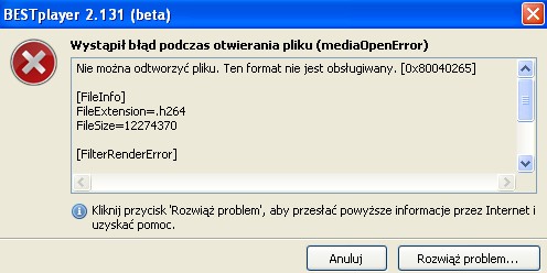

    Powolniak1987
    Posts: 131
    Rate: 14
    I installed K-Lite Megapack, and Best Player did not open it Opening .H264 Video Files: Recommended Video Players and Converters for Camera Footage
  • #15 13167952
    ciastex
    Posts: 607
    Help: 37
    Rate: 18
    It seems to me that this file is damaged or it is not a .h264 file

  • #17 13168171
    Powolniak1987
    Posts: 131
    Rate: 14
    Nothing, the format has been changed from .mkv to .h264 Media Player Classic is also not good with it
  • #18 13168678
