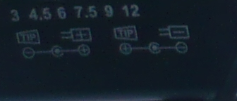

    I don't know much about electricity and I couldn't find out what the dashed line on the cable means and what the continuous with the dashed one. Namely, I have two power supplies: one from the USA, i.e. for 110v and the other from Poland for 220v. I would like to change the tips because I need it for the phone, I just don't know which one with which. Pictures below: How to connect a phone charger – solid vs dashed wire, 110V/220V? and the other cables: How to connect a phone charger – solid vs dashed wire, 110V/220V? the US power supply is gray and has one cable marked with a solid line, while the other one from Poland has one cable marked with a solid and a dashed line. Can someone tell me how to connect it?

    Check my friend what values are on this power supply from the USA. voltage and current. Will the one with the Polish power supply give advice when it comes to powering this phone. Personally, I would not suggest these stripes, check with a meter.

    Different manufacturers use different markings, more than once I met that in one case the minus was on the strap and in another plus...

    The simplest way to determine the polarity of the supply voltage is careful observation. Find the marking on the casing of the power adapter or phone

    Thanks buddy for sharing it :D but I'm not really an electrician. I have such markings as YOU in the picture had. I'm just talking about cutting one and the other cable and connecting them together. I have a drawing, is that enough?

    If there are markings on both, it's even easier. All you need is a flashlight with a working bulb and a battery. You cut off the plug from the original power supply (110-120V) with a length of cable. On the housing, you look at the polarity markings and use the bulb to set the color of the wire (with or without a strip) connecting to the external contact (because easier access) of the plug. This is half the job. Now we proceed to identify the polarity in the new power supply. If you don't have anything to make the aforementioned indicator out of, then there's nothing else to do but a sharp knife. You gently and patiently cut the insulation from the socket to which the replaceable terminals are connected. It is best to do it from the side of the marked vein. If you get to its connection with the socket, you will compare it with the polarization described on the housing, depending on the position of the plug. All that's left to do is connect.
