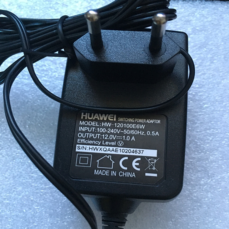

    Hello, I would like to connect the led strip, however, so as not to spoil the older charger, where is the plus and where minus? 2 cables go to the end and there is metal inside and outside but I don't know where what

    Find the polarity symbol on the power supply (such circles with the symbols + and -).
    The line that goes inside the stamp indicates the polarization inside the socket.
    If in doubt, upload a real photo of the power supply (rating plate).
    best regards
    EDIT:
    where plus and where minus in the power supply for led strips
    It looks similar to the picture:
    1. The top plus case in the middle
    2. Case bottom minus in the middle

    Usually + is inside and - outside; make sure, however, as recommended by a colleague above, send a photo of the rating plate.
  • #5 16780888
    DrabU
    Posts: 146
    This is exactly the huawei hw-120100e62 power supply
    input 100-240v 50 60 Hz
    output 12.0v and next to it there are two lines horizontally higher is straight and below it dotted 1.0a
    efficiency level V is all that is written on it but unfortunately I have nothing to do at the moment
    Added after 5 [minutes]:
    about this power supply only with photos from the net
    • Oryginalny-Huawei-B593-B315-B310-E5172-E5186-E5180-zasilacza-ue-wtyczk-adowarki.jpg_50x50.jpg (1.73 KB) You must be logged in to download this attachment.

    father sorka bad zdj it is better
    • where plus and where minus in the power supply for led strips Oryginalny-Huawei-B593-B310-B315-E5172-ue-zasilacz.jpg (172.72 KB) You must be logged in to download this attachment.

    These straight and dashed lines mean that the power supply supplies direct current, and the number under them indicates that max. 1A. How much tape do you want to feed? I don't know if 1A may be enough.
    By the way: the driver / LED strip will burn faster than the charger due to a bad connection; The charger may burn due to overload.
    Added after 59 [seconds]:
    https://www.olx.pl/oferta/zasilacz-huawei-hw-120100e1w-12v-1a-CID99-IDntaKI.html
    This one is similar to this; has + inside and outside.

    For safety, however, it is better to measure with a multimeter or "indicator" Led diode and 2-5 kOhm resistor connected in series.
    If you give a longer diode leg to the + power supply it will be lit.

    However, plus inside and minus outside thanks! and I have 2 m of LED strips
