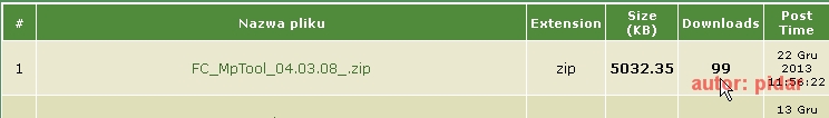

    Let's check this program:
    • FC_MpTool_04.03.08_.zip (4.91 MB) You must be logged in to download this attachment.

    Hurrah :D Finally, effective advice. Everything erased. You can record and delete normally. :D Nice "gift" just before Christmas. :D :D :D

    I ran the program mentioned above by Pidar and I didn't even know how to deal with it. I clicked one of the tabs and started the process of deleting data from the pendrive (start) and then the formatting took place automatically.
