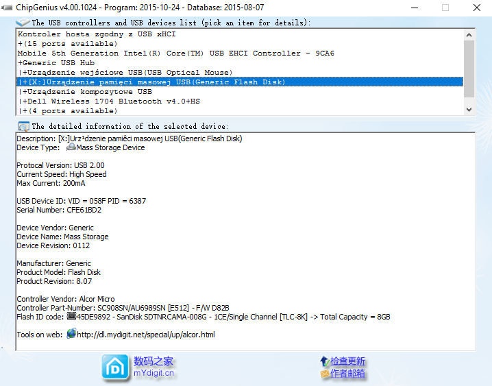

    So I have an 8gb flash drive and I don't know what happened to him. It worked normally for a while and recently I decided to rip the system on it. I plug it in and see that there is a movie on it. I couldn't delete it from the device, so I tried to format it (PPM-> format). I couldn't because I was writing "The disk is write protected".
    So I downloaded Hard Disk Low Level Format and did low-level formatting. The movie has removed itself and now as I insert PD it shows that I have to format it, so I click Format but it is still write-protected. I don't know what to do anymore.
    I am posting a photo from the ChipGenius result
    In addition, I say that in Disk Management, when I connect pd it says that it is Online and when I try to format it (and an error pops up) it changes to "Read only".
    I also tried diskpart through cmd but it doesn't work.
    And so btw yet FC MpTool program probably does not detect this pd (if it should).

    In AlcorMP v14.01.24.00 this memory is detected :?:

    Nothing detects

    BlaineJutuber wrote:
    That's how it works thanks :D
    I used the wrong controller
    To confirm add (save) info from Flash Drive Information Extractor and close the topic.
