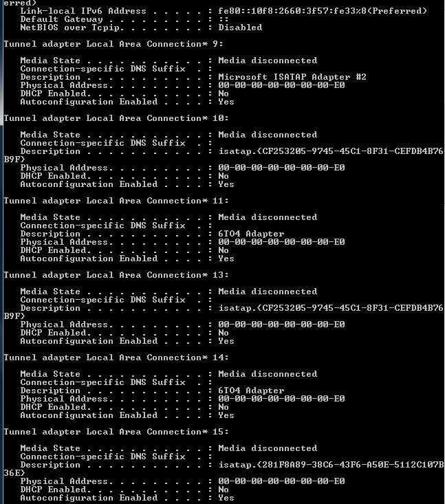

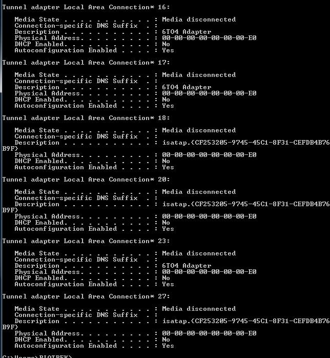

    It's simple buddy, after ipconfig there is only 1 slash (/), not two :)
