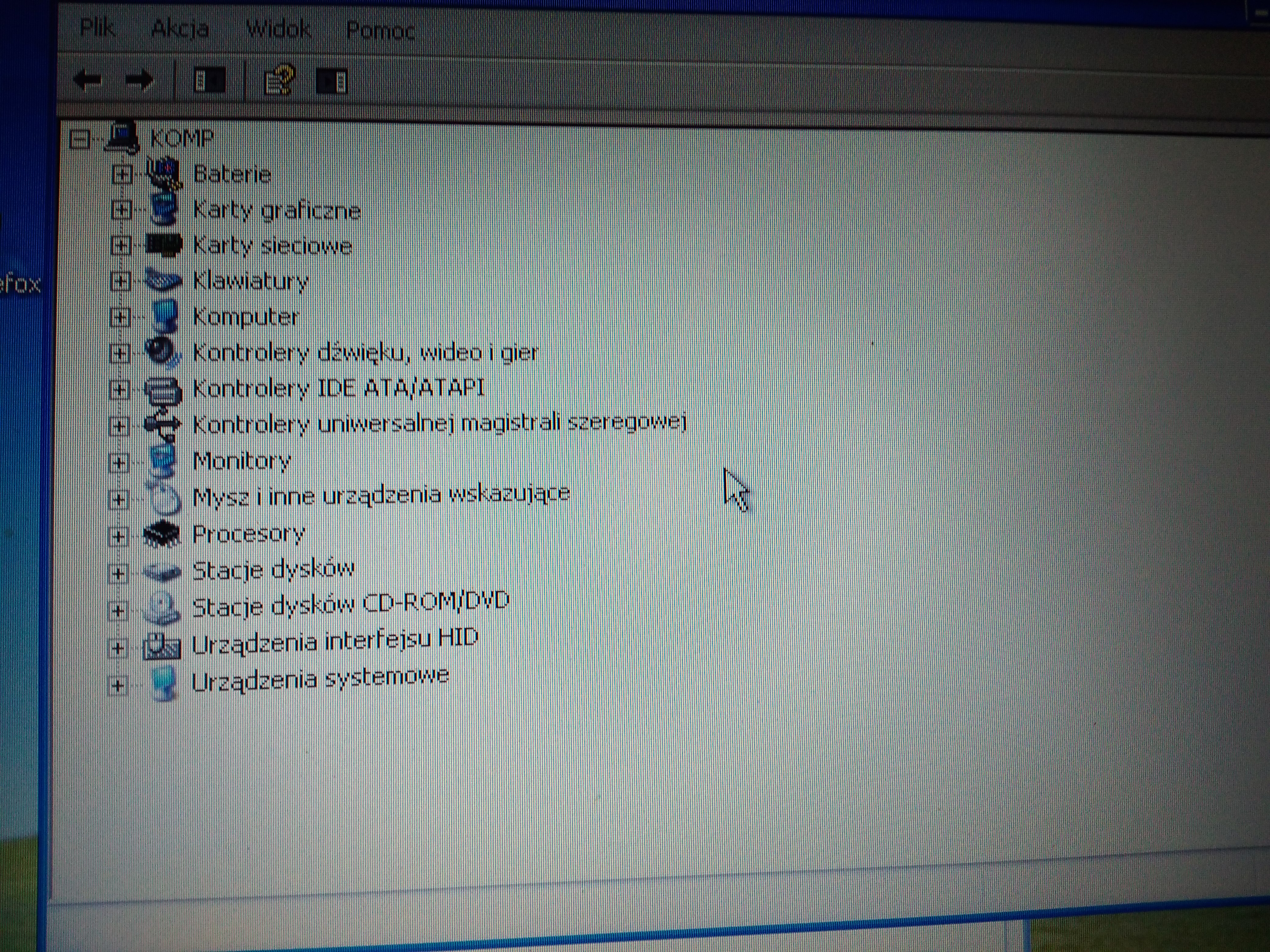

  • #12 16600586
    Wiktorq
    Posts: 7
    I think everything is ok with the drivers
    • Windows XP: Connected to WiFi but No Internet Access - Troubleshooting Guide 1500649520135..jpg (4.49 MB) You must be logged in to download this attachment.
  • #13 16600660
    KOCUREK1970
    Posts: 35666
    Help: 3860
    Rate: 5488
    Wiktorq wrote:
    I think everything is fine with the drivers
    Nothing results from this, because you don't even know what and what network adapters there are - he may not have detected them or installed.
    And if he installed, it is not known with what drivers.
    Wiktorq wrote:
    yesterday I reinstalled windows xp and all drivers
    So the same XP was there before?
    If so, you haven't installed everything or the wrong drivers.
    What exactly is the wifi and LAN network card? - producer, designation.
    Drivers downloaded from where these products?
