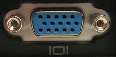

  • #6 10636368
    młody14
    Level 37  
    Posts: 4013
    Help: 319
    Rate: 231
    ;o Then you are not talking about the integration, but about the COM port:
    The computer does not connect to the monitor - anyone know what happened?
    The input to the integrated card is blue and has no "standing, i.e. normal contacts", only holes :)
    Plus they have names...
    The one with the holes (input in the graphics card) is a female port, and the plug from the monitor (the one with "standing plugs") is a male one. Just like in biology :D
    This is the first thing...
    The power of the power supply is expressed in WATTS (W) .
    By the way, we provide the brand of this equipment.
    Connect to this input which is marked in the picture:
    And one more thing... if you already have something Volts not Volts
    I'm a layman, but these things are good to know :D
  • #7 10636809
    matiop1
    Posts: 33
    młody14 wrote:
    ; then you are not talking about the integration but about the COM port:
    The input to the integrated card is blue and there are no "standing, i.e. normal contacts", only holes :)
    Eh, you break me down such things, it's true that it's worth knowing, but you didn't help me anything ... Because I know where the cable connects. And such an input I have only on the graphics card, not on the motherboard. So maybe someone has any suggestions other than a lecture not needed...

Could a mismatched COM port be mistaken for VGA?
Yes. A DB-9 COM port has protruding pins, while VGA (DB-15) on the card/motherboard has recessed holes [Elektroda, młody14, post #10636368] Mixing them prevents the cable from fitting and yields “no signal.”
