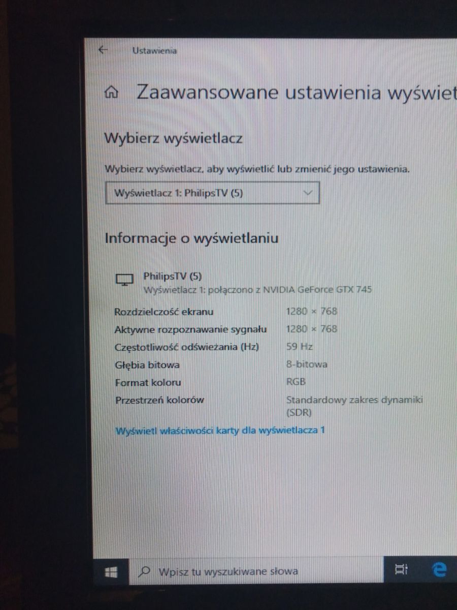

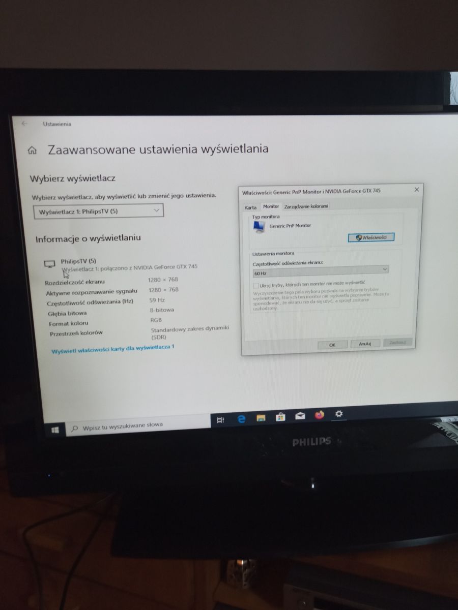

    Is the refresh rate set to a value supported by the display in the graphics card settings?
  • #5 19126327
    Adrian. 21.
    Posts: 39
    What to do if the computer cannot see the monitor?
  • #6 19126335
    Kardor
    Posts: 461
    Help: 13
    Rate: 100
    Try to change these settings, of course giving up the modes that the monitor cannot display. Interestingly, the card does not recognize monitors, except for PhilipsTV, so it can be assumed that either the connector or the card is damaged.

    But the monitor is not detected correctly by the card, it is displayed as Generic.
    Are your card drivers up to date?

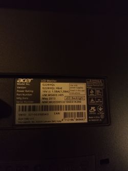

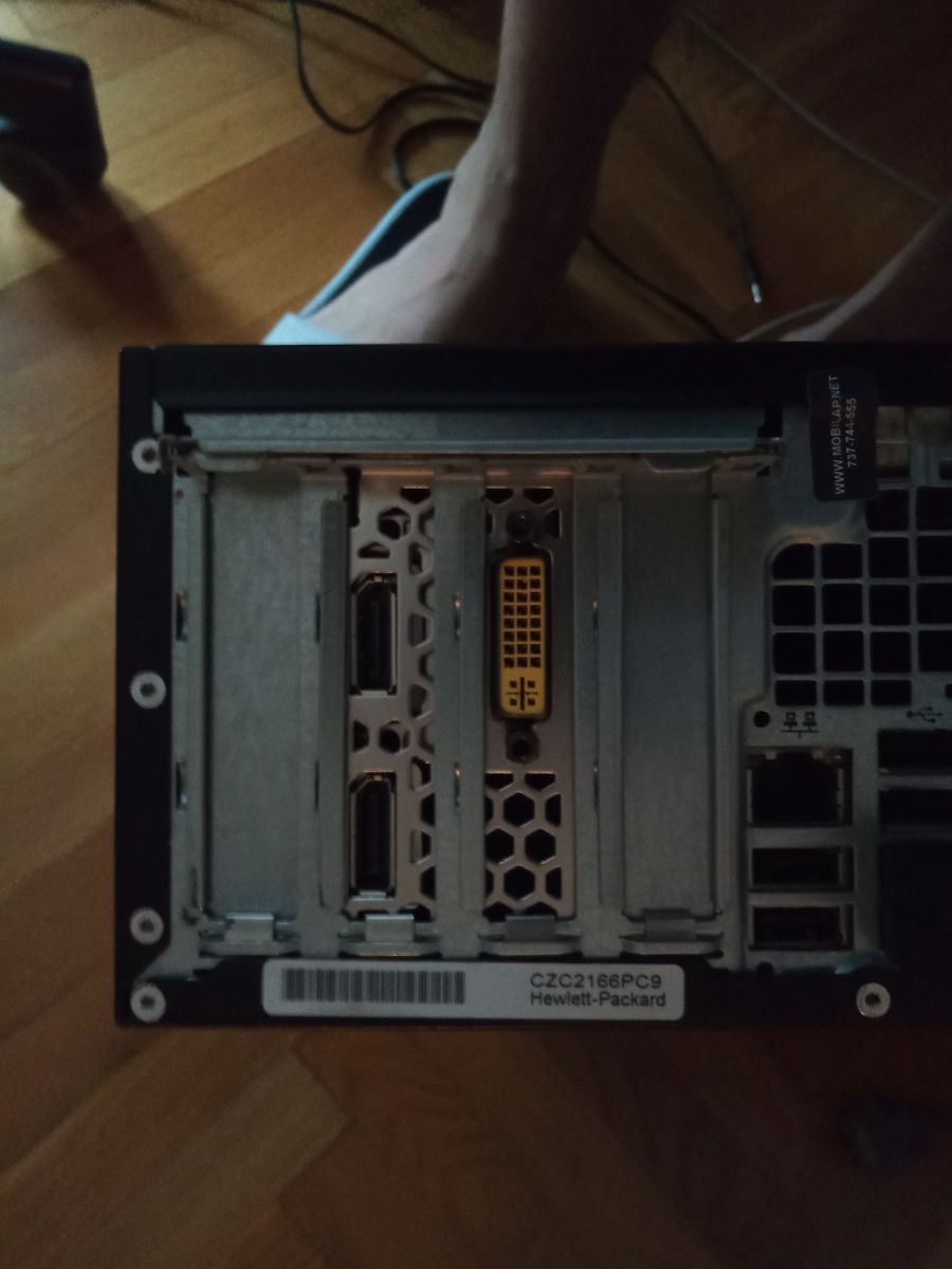

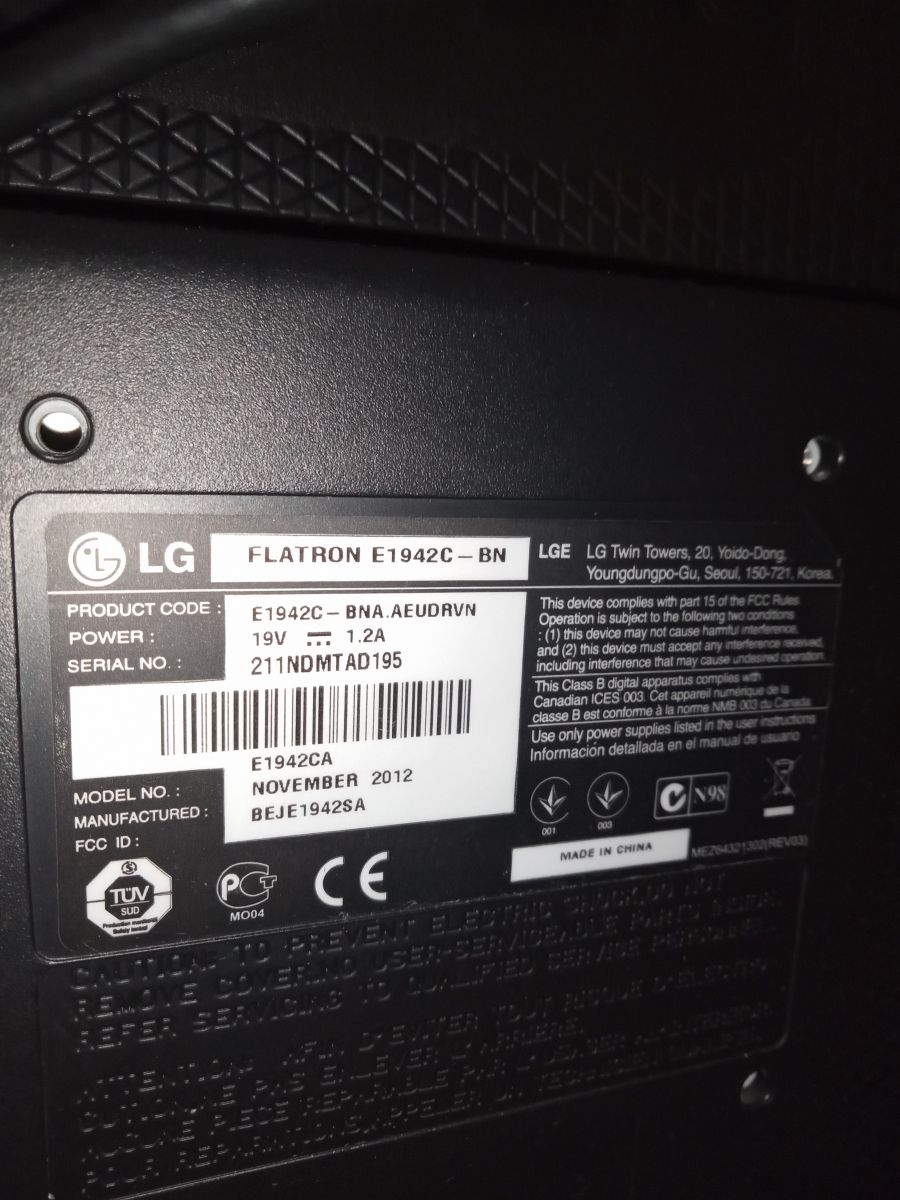

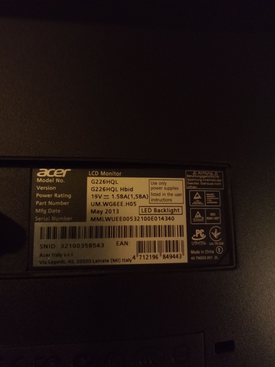

    Please specify the exact models of these monitors.
  • Graphics card outputs work on old TV only
    #11 19127900
    Adrian. 21.
    Posts: 39
    What to do if the computer cannot see the monitor? What to do if the computer cannot see the monitor? What to do if the computer cannot see the monitor?
    The first LG monitor has only a VGA input, it works normally on two laptops, the second monitor works on two laptops and has HDMI, DVI and VGA outputs, the third photo is a graphics card, when connected to both monitors via VGA NO SIGNAL on both monitors, after connecting via dvi (adapter) still No signal, by connecting display hdmi - hdmi still No signal, after connecting with the same cable to a 14-year-old TV everything works normally

    Dedicated graphics card, i.e. from the motherboard, not the processor and no additional one, as I understand it. So check the BIOS settings regarding the graphics card to boot from. Signal source selected appropriately in the monitor?
  • #15 19128212
    Adrian. 21.
    Posts: 39
    When connected to a laptop, the monitor works via VGA and HDMI without changing the signal source, it reads the path itself, and since the TV works normally under the computer, it means that the card has the correct settings
    Added after 7 [hours] 54 [minutes]:
    It only works via a DVI cable (double-sided), I close it
