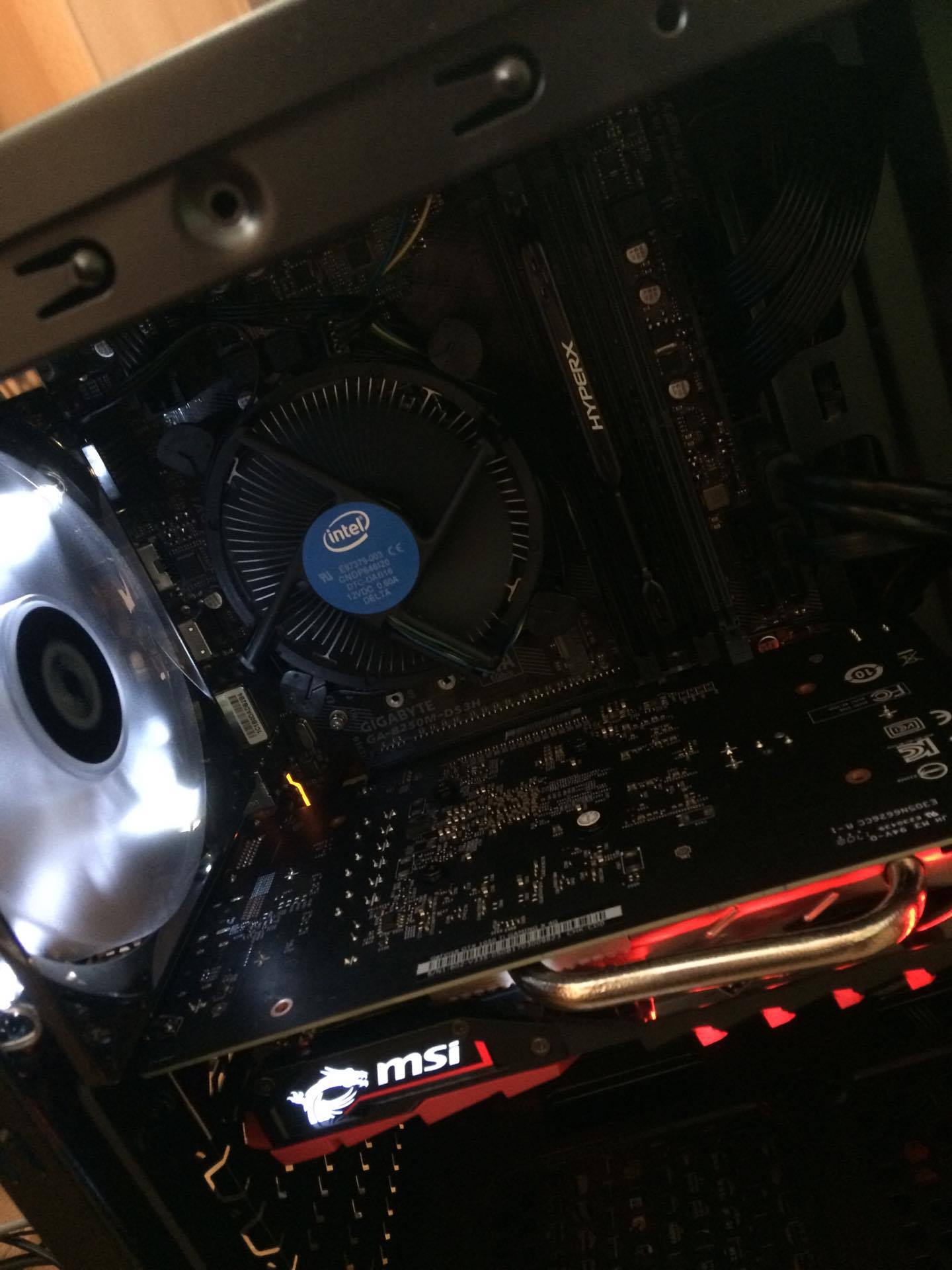

    A few days ago I got my new computer, which was made by a friend from the forum. Along with the computer, I immediately ordered a new monitor, because mine was already outdated. I put the new computer aside for a while because I had to transfer files from the old one to the laptop, but in the meantime I connected the new monitor to the old computer and it worked.
    Yesterday I connected the new computer the same as the old one and unfortunately nothing is displayed on the monitor. The computer is working, below I will insert a photo of what it looks like. I'm a little worried because I ordered an assembly along with the computer and I was sure that everything would be ready, and here's the hatch.
    New Computer Monitor Not Displaying: Friend-Built PC & Monitor Connection Issues New Computer Monitor Not Displaying: Friend-Built PC & Monitor Connection Issues
    Is it worth messing with it at all or should I just send it back? Thank you in advance for your help and best regards!

    What kind of monitor is this?
    Which port is the monitor connected to?
    The monitor works connected to the old computer?

    Have you checked the integrated graphics?

  • #10 16471715
    h1ddenerror
    Posts: 26
    This is what it looks like.
  • #11 16471717
    Kasek21
    Posts: 45570
    Help: 4968
    Rate: 3524
    How is it supposed to work when you connect it to an integrated card with a separate card installed?
    You have to connect the monitor to the DVI connector near these red caps or through the HDMI cable with the monitor.
    Well, that's all clear. You didn't connect the monitor there :)
    Does this new monitor only have a VGA input?

    Oh jesus I'm stupid.
    Well, I'm going to the store to buy a cable and let you know.

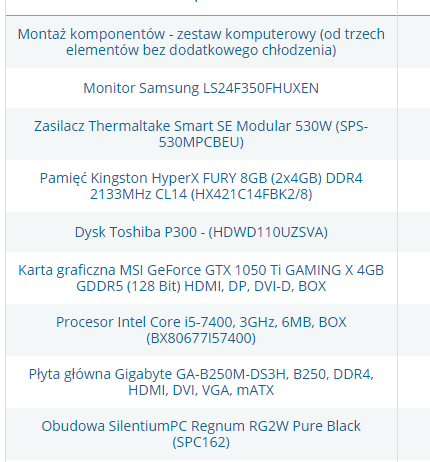

    Specify the model of the monitor so that you do not buy blindly.
  • #17 16471784
    Kasek21
    Posts: 45570
    Help: 4968
    Rate: 3524
    LS24F350FHUXEN
    Need to buy an HDMI cable.
