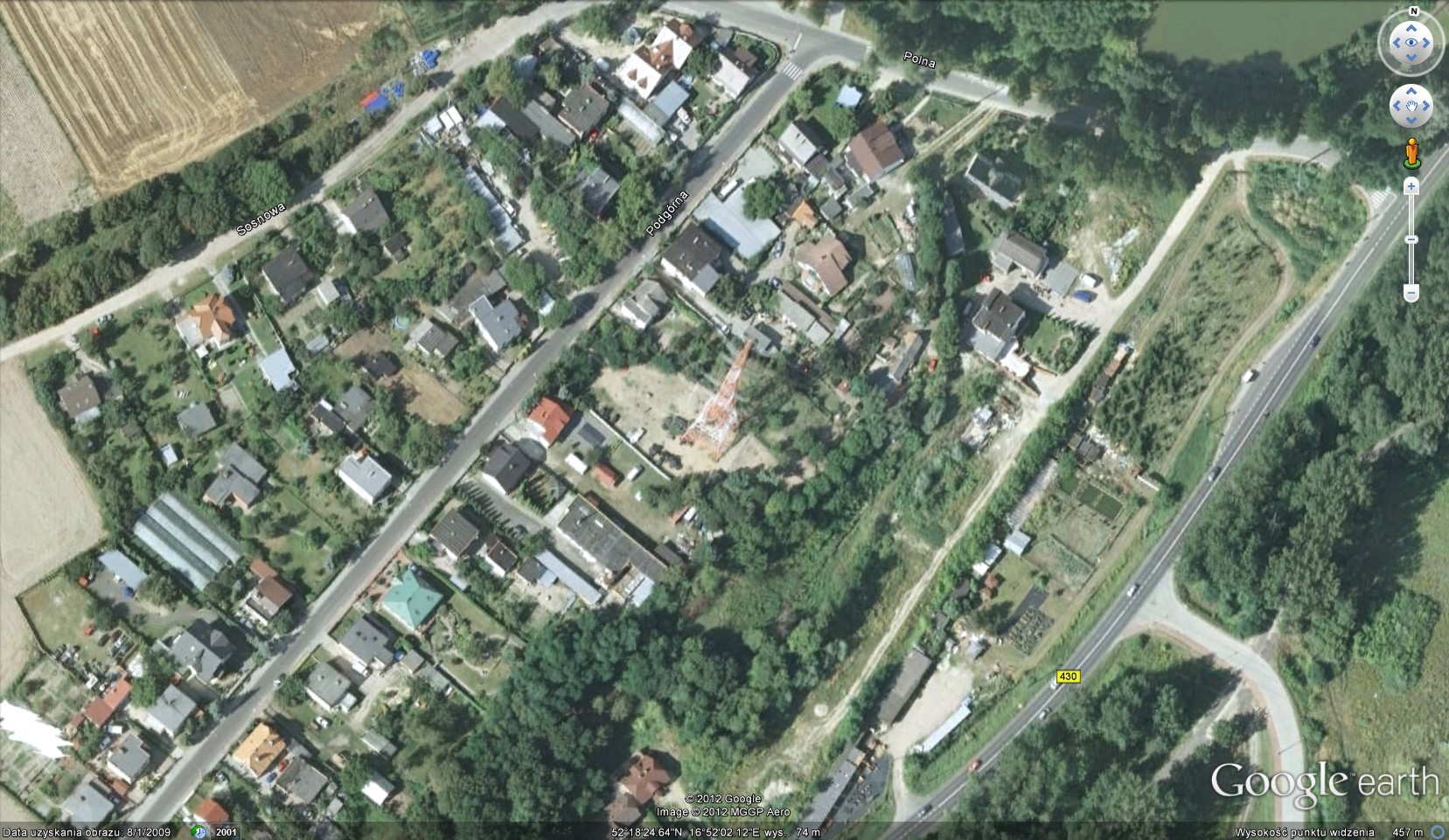

    My colleagues "experience" the 110th.
    And here please:
     Building a House 10m from 110kV Overhead Power Line: Impact on Safety, Health & Family
    A four-circuit, two-voltage line (2x400kV + 2x220kV) in the center of the village over the heads of the inhabitants.
    And here please:
    And is it not the famous Plewiska - Kromolice line? This is probably not the best example. ;-)
    But the fact - I have a family living close to 220 Konin-Łódź and there are no problems there.
