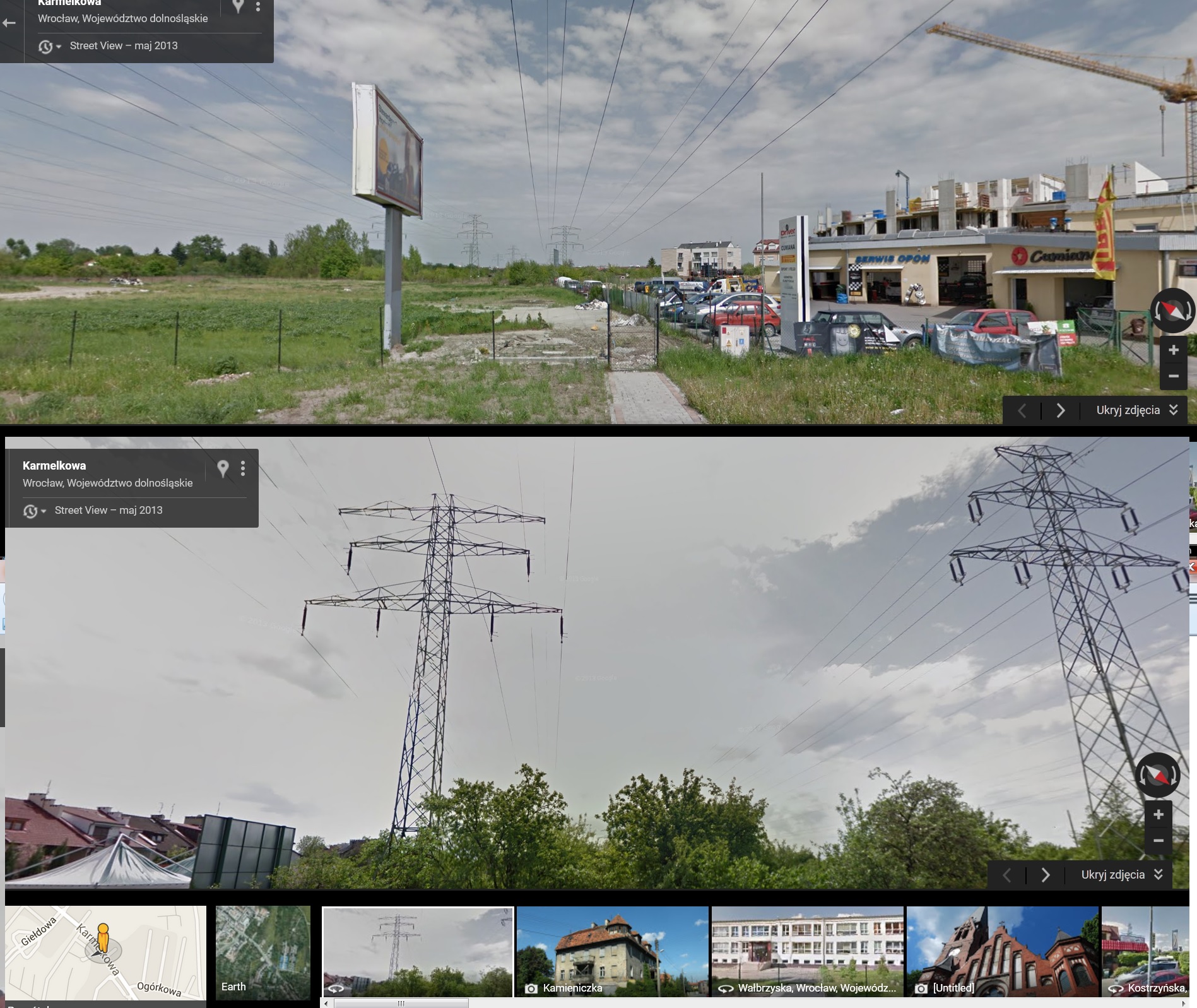

    I am asking for help in identifying the WN line and assessing its impact on the health of tiny children - I want to buy a flat located 30 meters from the extreme cable.
    The line is marked S118 69, runs through Wrocław os. Klecina.
    I suspect that it is 110kV, but I can not find confirmation in any way, I am also afraid that one day it will be rebuilt to a larger one.
    google.pl/maps/@51.0674843,16.9731482,3a,62y,225.94h,108.25t/data=!3m6!1e1!3m4!1s4d0noNM90S8u8phMYKuRJA!2e0!7i13312!8i6656
    Thank you in advance for your help

    #2 15579647
    sq9fmc
    Posts: 963
    Help: 129
    Rate: 406
    It is 110kV.

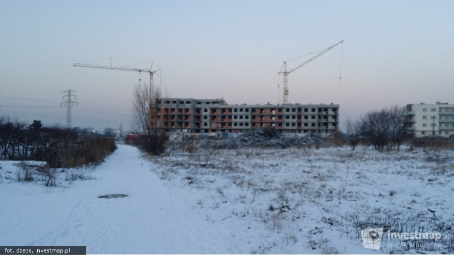

    zyga1988
    thank you very much for help. Unfortunately, the articles I read are completely extreme, in one they say 250-600m, and in others the authors say that 15m is completely safe. I still don't know what decision to make.
    In the attachment I am presenting a photo of this particular investment, the apartment would be on the left, it is about 35m away, the remaining apartments are already booked, there are also houses (even closer), but maybe people just do not think about it.

    #7 15580687
    zbich70
    Posts: 17197
    Help: 1171
    Rate: 6668
    zyga1988 wrote:
    but maybe people just don't think about it.
    You're dramatic, buddy. High voltage lines have existed for decades, much closer to the housing development where generations were born and raised in excellent health.
    Question - will the children's room be without 230V electrical installation?
    Because I can assure you that this installation, separated from children by 5mm of plaster and 1m of air, will be more harmful than the 110kV line behind a thick wall and 30 meters of space.
    It is also worth knowing that the EMF intensity decreases z square distances.

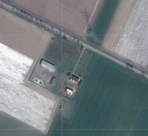

    I have lived almost under the 110kV pole for quite a few years. My children and their peers play in its vicinity.
    Here are a few photos, even worse than the author's objections:
    220kV above the playground:
    Apartment 30m from the WN line - its identification and impact on children's
    220kV at the block itself:
    110kV directly above the house:
    People are alive and well :D
