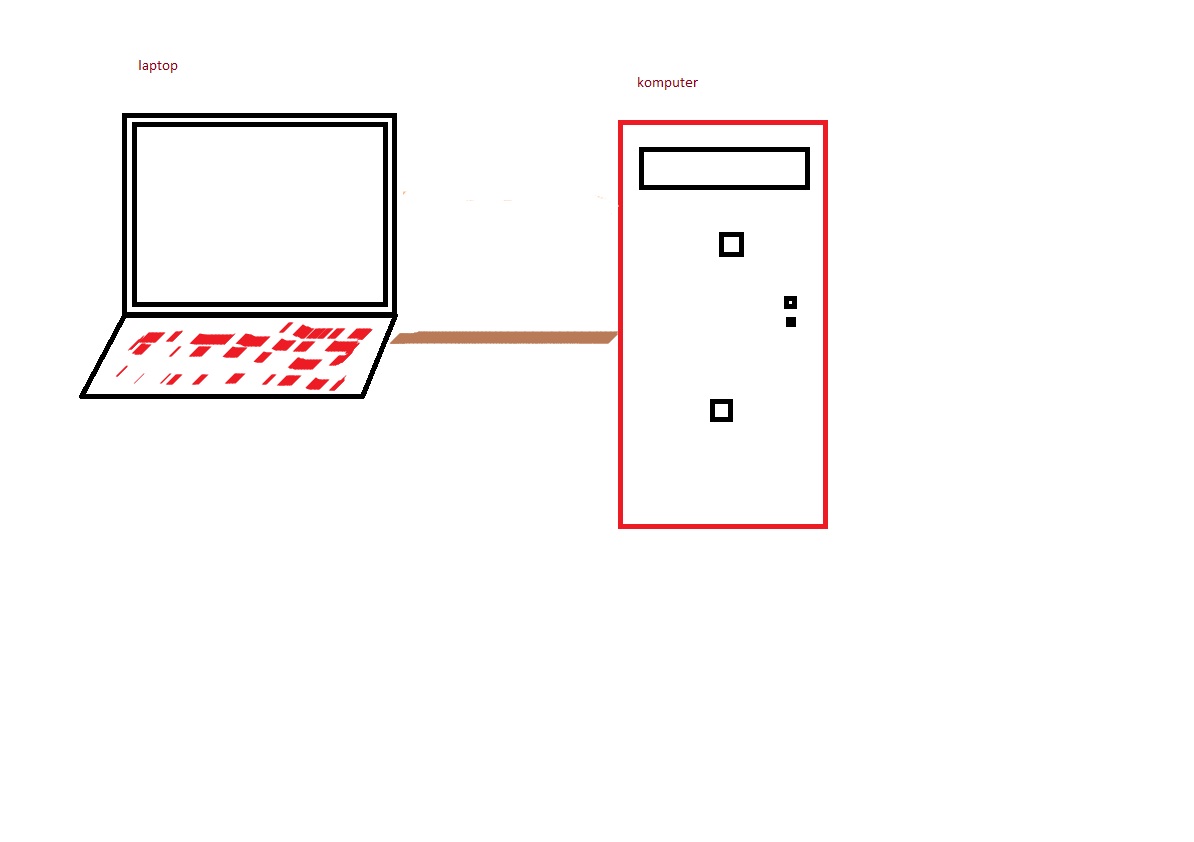

    Hello :)
    I have a Lenovo G550 laptop and an older HP computer.
    I would like to know if it is possible to connect the computer to the laptop display as I do not have a separate PC monitor. ?
    • Connecting HP Desktop to Lenovo G550 Laptop Display: Using Laptop as PC Monitor laptop pc.jpg (48.21 KB) You must be logged in to download this attachment.

    djzatorze
    Posts: 501
    Help: 58

    Aj, make this picture laugh more than information :D Generally, it cannot be done without disassembling the laptop. The simplest solution is to disconnect the matrix from the laptop, connect it to THIS and that controller for the computer. I do not know if the controller you need is available in Poland at all :) At the bottom of the linked page are links to sample controller auctions on ebay.
