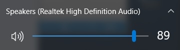

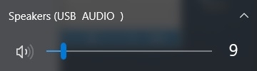

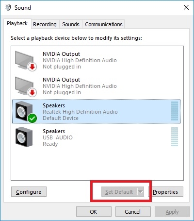

    tita98 wrote:
    I think that this problem cannot be solved in the way I assumed at the beginning.
    Of course you can: /
    That's what the default audio output in Windows is for.
    This is a picture of the settings in the robot, so you can not see the TV, but at home I have a similar setup as a colleague; TV + speakers.
    Setting Up HDMI Output & Headphones Simultaneously on Lenovo G580 Laptop with Windows 7
    In the office I have 2 HDMI monitors (without sound) + built-in card + USB card led straight out to the desk with a USB cable.
    In the sound settings, just set the appropriate device as the Default audio output and it's ready.

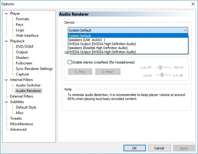

    In addition, many applications allow you to choose a specific device from the list of available, without changing the default audio output.
    Below, for example; Audio settings for Media Player Classic x64:
  • #12 16894101
    tita98
    Posts: 154
    Rate: 42
    It worked. It turned out to be very easy. PPM on the Master Volume speaker => sounds => playback, and there I have a TV and speakers. It was enough to right-turn off the sound on the TV and automatically turn on my speakers. arnoldziq led me on a good track, but thank you to everyone who tried to help me.
