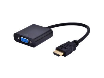

    I have a problem with my monitor. After connecting it to the laptop via an HDMI - VGA converter (HDMI to the laptop and VGA to the monitor), the inscription "OUT OF THE 67.4 kHz/60 Hz OPERATING RANGE" is displayed on the monitor. I went into the settings and changed from 60Hz to 59Hz, but it didn't matter doesn't help. I tried to find something about it on the Internet, but all the articles were about the computer, not the laptop. The converter and monitor works, because I connected the monitor through this converter to the old laptop to HDMI and everything worked, but on the newer one it doesn't. HDMI output it also works with Lenovo.
    My equipment is:
    - Lenovo Ideapad 330 laptop
    - Old LG Flatron L1918S monitor
    - And such a converter
    After connecting the monitor to the laptop, it displays "out of operating
    I will be grateful for your help :)

    Set the resolution to the one your monitor supports.

    And where exactly do I set it, because in the settings, even if I connect a monitor, I can change the resolution, but of the built-in screen.

    Connect the monitor, turn on Extend and then the option to set the resolution for the second monitor will appear.

    I did what my friend wrote and in my case it worked
