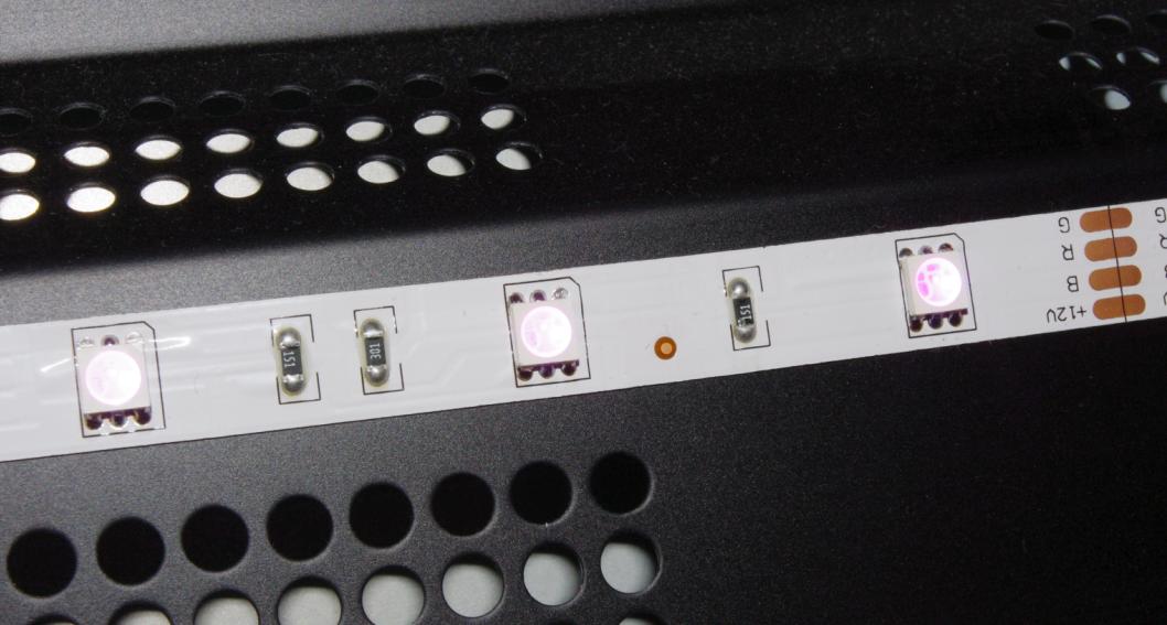

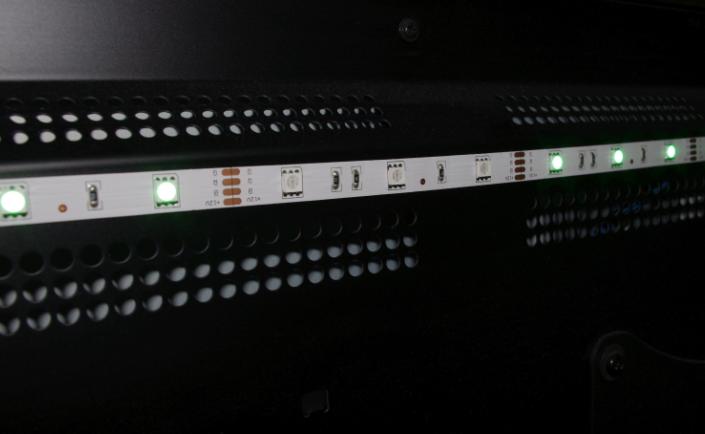

    Hello everyone. I have a request & question. I noticed that one segment of the RGB LEDs glows in a different color.
    Faulty RGB LED Strip: Identifying Issues with Green Color and 151, 301, 151 Resistors
    It turned out that one of the component colors - green - was not lit.
    The question is...Where should I look for the fault? Power supply or one of the 3 resistors on the faulty section? I took a closer photo, these are their denominations: 151, 301, 151.
    If one went, how can I check which one?
    Could anyone give some good advice? :)

    Ring the paths of a given diode segment if possible, check the supply voltage. Most likely, one of the paths was interrupted or a cold solder phenomenon occurred, e.g. at the resistor - an open circuit.

    Is it possible that one of the cathodes/anodes in one of the diodes has burned out and the entire segment is not connected?

    I think it may be the resistor's fault. What power supply are you using?
    to the colleague above: the phenomenon of cold solder, in the case of LED strips, occurs after the first connection, very rarely after long-term use.

    Looks like a simple task. If you know that there is no green color and the tape has marked paths, grab a meter. It can be assumed that the resistor marked 151 has failed. For example, you measure the voltage before and after the resistor. Of course you can measure resistance. It could happen that the resistor became disconnected from the path. but the solution is not in discussion but in action.
