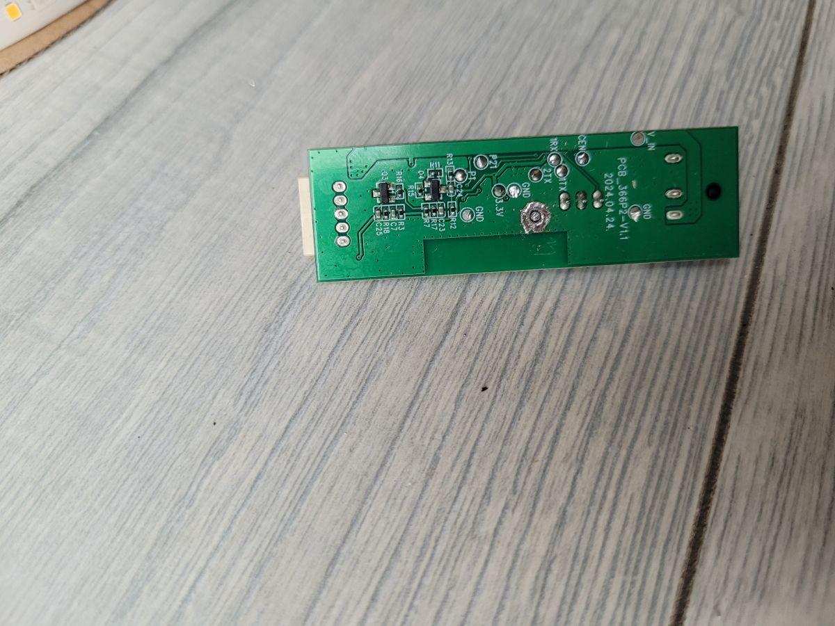

    Close-up of a circuit board with visible electronic components. A circuit board lying on a wooden table. Circuit board with USB cable attached, visible on a wooden surface.
    AI: What is your specific goal or purpose for exploring the interior of the ACTION RGB device?
    One more input into teardown database
    AI: Are you facing any specific issues or challenges while exploring the interior of the device? If so, please describe them.

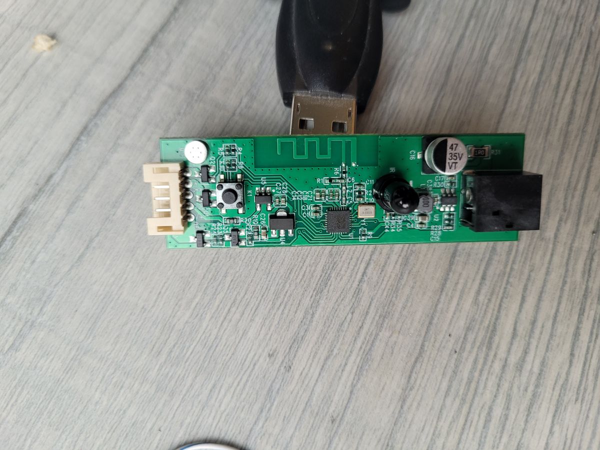

    Yes I connect flasher but cannot reset device. Also I do not know if use tx1 tx2 I tried both without success.

    How did you connect the flasher? 1TX and 1RX should work. Then just do power on/off to reboot.
  • #3 21351478
    cijoml
    Posts: 78
    That's what I have done but chip did not reboot. Also tried ground CEN without success. May be the problem with capacitor I saw some video...?
  • #4 21351485
    Posts: 14700
    Help: 656
    Rate: 12745
    But capacitor here would be on 12V line and not on 3.3V... maybe try swapping RX and TX?
    Did you flash any other devices with your setup?
    Do you power your strip with a reliable 3.3V power supply?
    Can you show a photo of your setup?

    Of course I tried swapping rx and tx.
    Yes I have flashed many Tasmota firmwares with this setup. No problem with setup. I used speed 921k
  • #6 21351490
    Posts: 14700
    Help: 656
    Rate: 12745
    Yes, but what about BK7231? It may have slightly different requirements and I remember some topics from our forum where people used too weak power supply (directly from USB to UART converter) or the USB to UART converter itself was not too good/

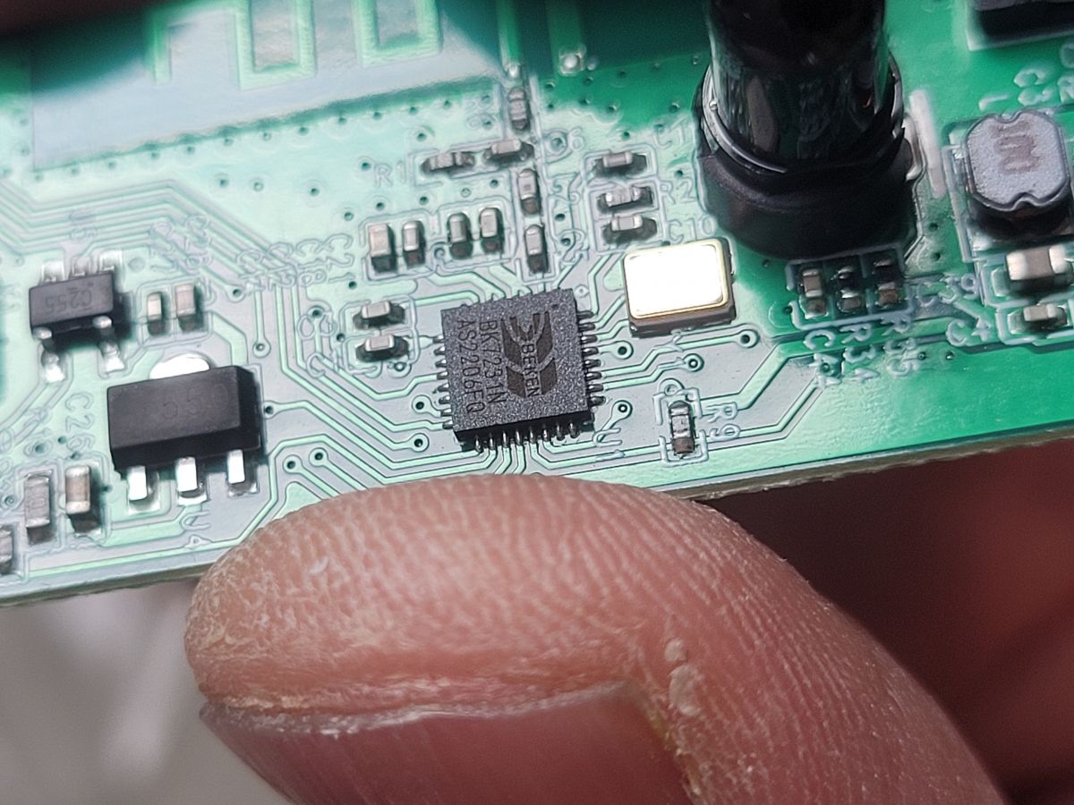

    Hello I was successful flashing openbeken. I get web interface, wifi work, however I need set template so the LED stripe work. Can somebody help?
    Here is extracted tuya config from flasher:
    - Microphone (TODO) on P23
    - LED Cool (Channel 4) on P24
    - IR Receiver is on P26
    - PWM Frequency 1000
    - SPI MISO 17
    - SPI MOSI 16
    - Control Pin (TODO) on P22
    - LED Warm (Channel 5) on P6
    Device seems to be using CBU module, which is using BK7231N.

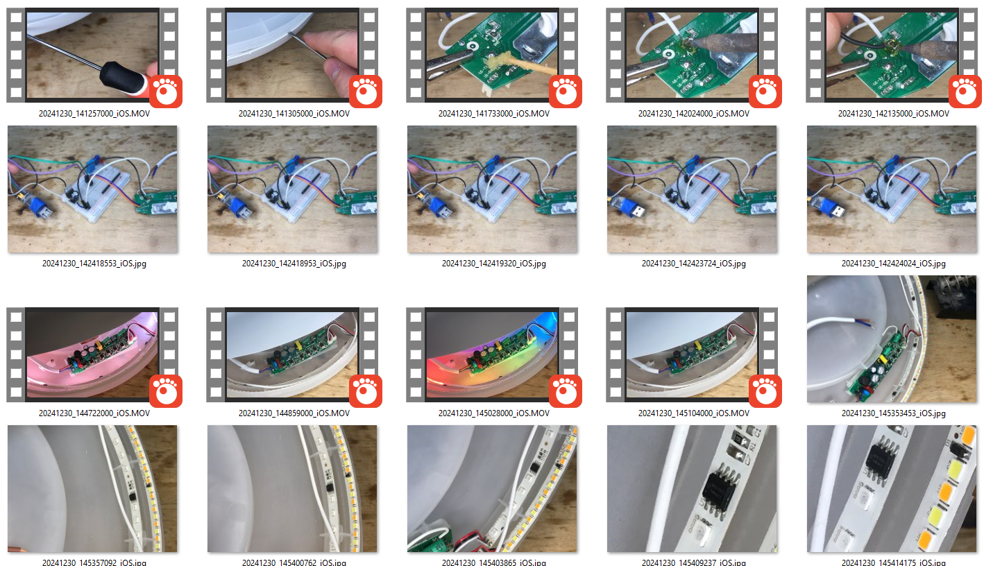

    I literally used this driver yesterday in RGB (SM16703) + CCT (CW two PWMs) combo and it worked well on Action LSC 3206306:
    Thumbnails of photos and videos showing experiments with circuit boards and LED strips.
    What is your current device config? Maybe you need to set one of pins to high state? P22 to Always High?

    Posts: 78
    Ah yes 22 always high fixed problem. Seems I have light again
    Added after 7 [minutes]:
    Now I need to swap blue and green colors since they are swapped.
    Added after 47 [minutes]:
    This seems to be correct configuration for the RGB.
    startDriver SM16703P
    SM16703P_Init 40 RBG
    startDriver PixelAnim
    However there is still problem with WARM white. When I trigger it from main page, LEDs are switched off and dimming not work for warm leds. When I trigger it from App/Status page clicking on/off and dimming I can operate WARM leds with no problem.
    Any fix for this behaviour?

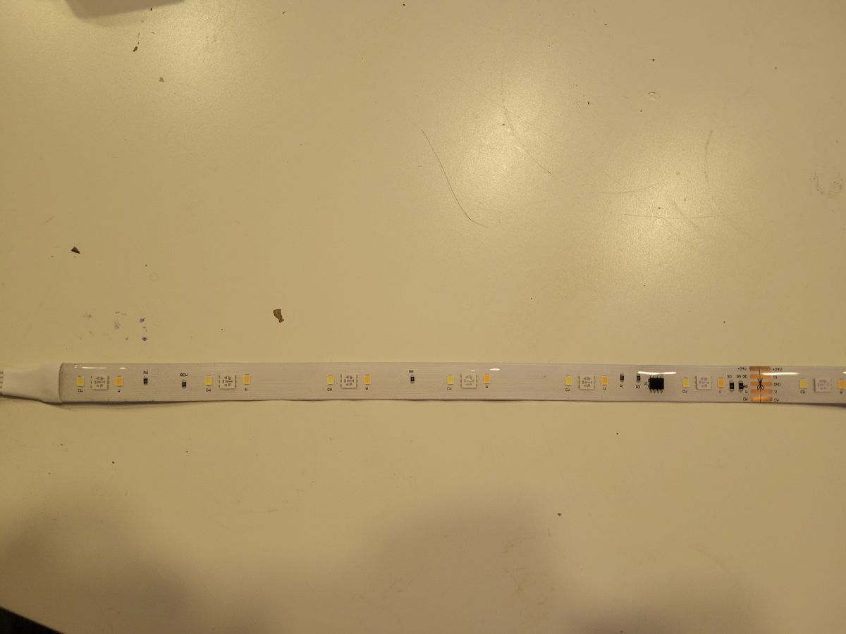

    The strip works like when I address 1 diode 6 diodes start lighting the selected color. Is it such a shitty led stripe that one chip controls all 6 leds and cannot be addressed individually?
  • #19 21377493
    Posts: 14700
    Help: 656
    Rate: 12745
    I can think about more effects. I'd have to check. But you can always use DDP.
    How your strip looks like? I remember seeing such products on market. They have one controller per 6 LEDs or so.
    Remember that you can always just buy WS2812 strip and connect it to 5V power supply and it will work with OBK good.
  • #20 21377499
    cijoml
    Posts: 78
    DDP work and I use it now however it utilizes WiFi with small packets which is not OK. If there would be a possibility just to mimic WLED colour effects just inside Beken would be great.
    I will make and send photo of the stripe

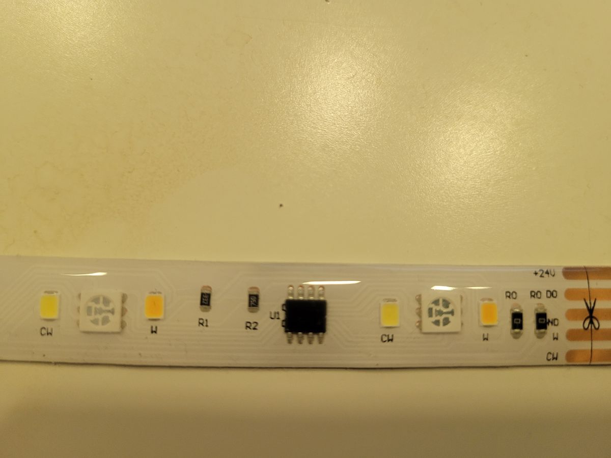

    LED strip with multiple diodes on a light background. Close-up of an LED strip with CW and W diodes and electronic components on a white background.
  • #21 21377511
    Posts: 14700
    Help: 656
    Rate: 12745
    What is the marking on the IC? Black IC with 8 legs? Is it SM16703?
  • #22 21377526
    cijoml
    Posts: 78
    I cannot see any marking even with magnetizer.... :(
  • #23 21377539
    Posts: 14700
    Help: 656
    Rate: 12745
    well, it doesn't change the fact that you have one IC controlling 6 classic LEDs. If you want better resolution, buy WS2812 strip, and MAKE SURE to power it from 5V. You don't need another WiFi controller, you can use that one, WS2812 is supported by OBK.
