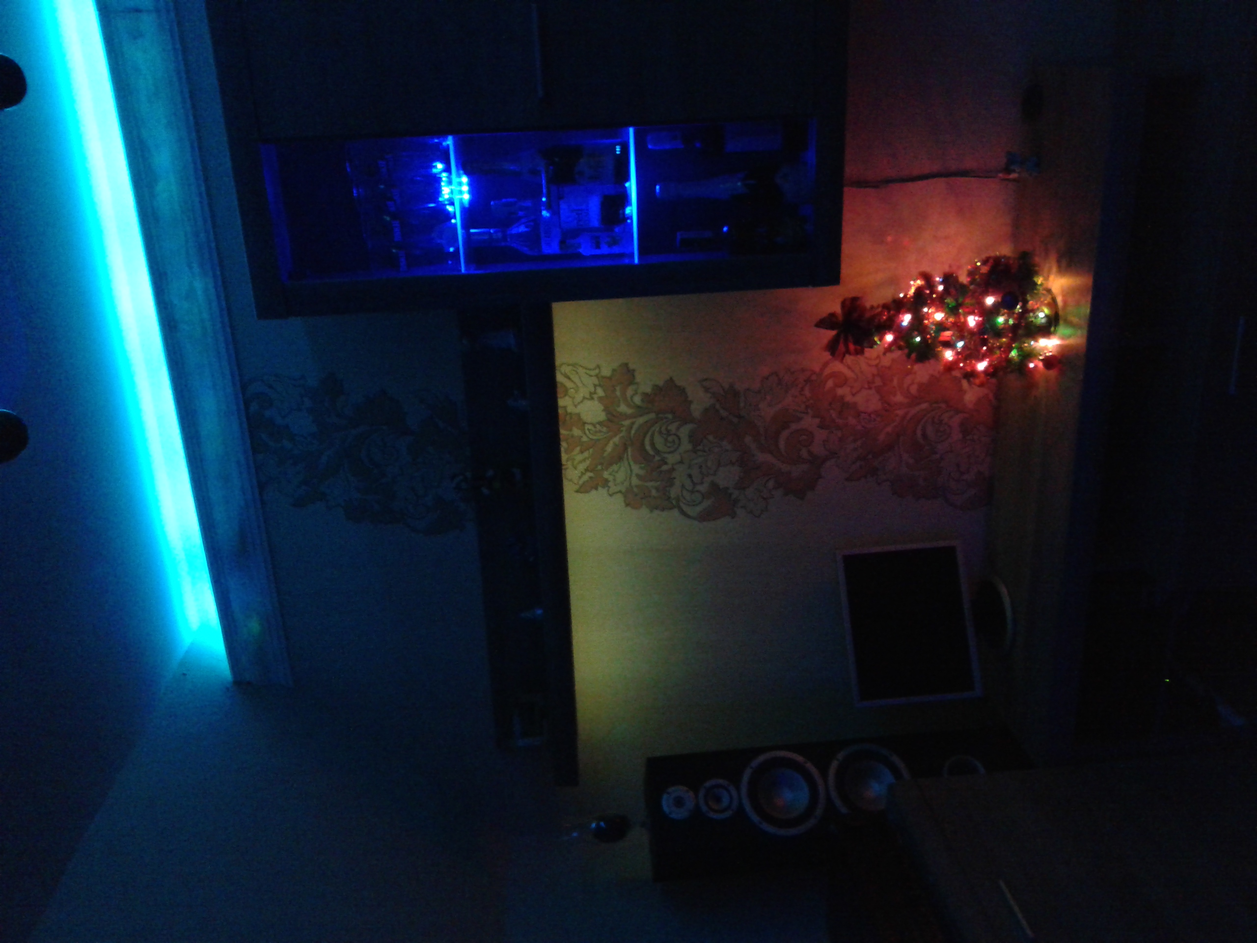

    Hello, I have been struggling with LED lighting in my room for several days. I have already replaced the controller once, because after turning off the LED strip (on the ceiling) was green and mixed colors altogether. After the exchange, everything was fine for 2 weeks.
    Today I bought 1 m of tape + power supply and controller for the same room in a different place. I plugged it in, everything works as it should. But the previous longer strip on the ceiling started to malfunction, i.e. after selecting the red color on the remote control, it lights up blue, after turning on the blue color, the green LEDs turn on, and after turning on the green color, the red LEDs. You just "mixed up" the order on the remote control. Since it worked well before, RGB colors with the driver are surely well connected.
    What is going on? Will I have to replace the driver again? I'm fed up with them.

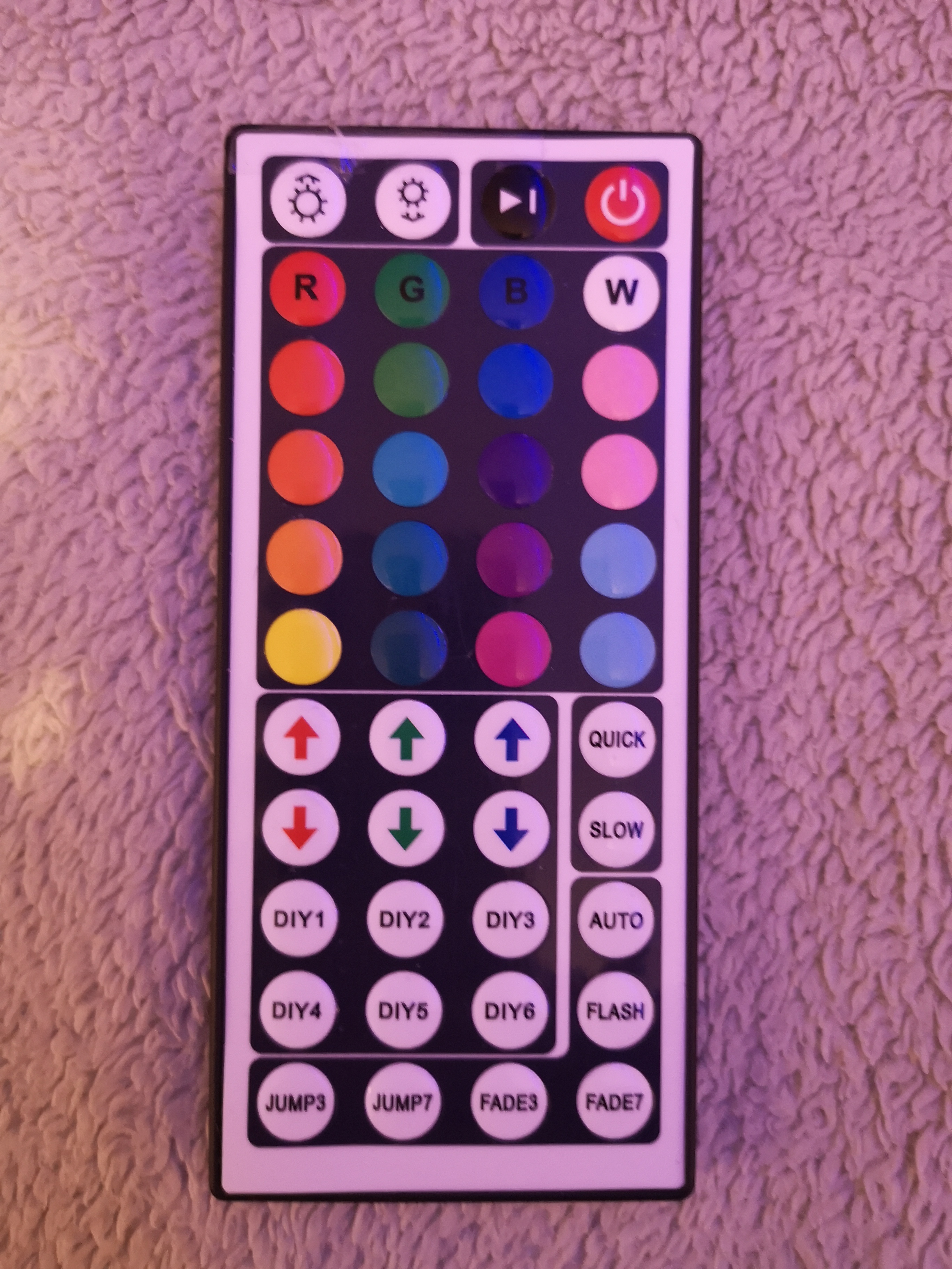

    Which button is fade7? My controller does not respond to combinations of turning on (any other) and turning on again
    Are there any other programming combinations (it changes the controller mode)?

    Because I had the same problem - I am sending a photo of the pilot on which this combination works.
    And check the batteries - they are rarely replaced, hence some keys refuse to obey.
