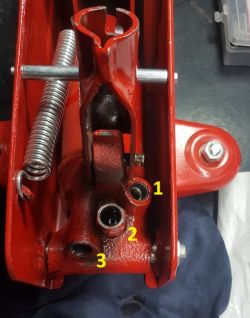

    Hello, colleagues, I have a hydraulic lift as in the photos. I took it apart, replaced the o-rings with new ones and the effect was the same. Those, the lift empty when raised to the very top, begins to descend despite the fact that it should not. The oil is max. There is air in it. What could this be happening? What could be wrong? I don't know how item 3 should be folded? Just like in the picture or maybe the ball should be inside? Because it fell out and I don't know how it was. But I put it together anyway and it didn't work. Oil leaks are nowhere to be found. What could be wrong?

    I do not know. I got it for repair, but if anyone lost something, I have no idea. That is why I try to understand the subject of how it should look like. The central pin of position 3 has such a recess on both sides for the shot. But there is only one shot. Maybe there should be two sharps there?

    The ball should be right behind the screw. There is a small dimple where the ball sits centrally. Check the ball for squashing or replace it with a similar one for a bearing.
    Buddy, what are you talking about?
    jaszto wrote:
    Look carefully at the balls and ball nests, especially item 1.
    Position 3 is tightened and should hold. Put the ball (item 1) into the socket, press it with a non-hardened steel rod and tap it lightly with a hammer. This is how I repaired the 10t lift. In my case, the extreme protection was the extension in the cylinder. In this frog, the protection is probably in pos. 2, tapping the ball will not hurt.
    Buddy, should I hit this ball from position 2 from the pump? She's stiff with this plunger. And let someone explain to me what item 1 is responsible for? What is she doing and what is this ball spring for?

    Thanks colleagues for the suggestions. But I also did such an experiment. I wrung out everything that was in position 1 and position 2. I poured oil into position 1 by lifting the piston up to suck oil. Position no. 3 was closed as it was during work. And the effect was that when I lifted the piston up and poured the oil, the effect was the same as always. That is, the piston popped up and held it gently falling. Does this tell you something?

    inside there is a piston check valve (a ball with a special rubber) which is also a pump check valve.
    It is most likely accessed from the inside of the actuator piston.
    There may also be a leak between the piston and the oil reservoir.

    The lift could not be repaired. I mentioned a few things in it but unfortunately it did not bring any improvement. That's why I bought a new working one.
