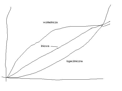

    C - exponential characteristic (anti-logarithmic) and can someone draw me what is the graph of such a potentiometer??
    because what linear looks like, I know logarithmic too, and the third one, I don't know :)
    please help

    Here you go ;) Regards.
    • Potentiometers A vs B – which taper is linear, which is logarithmic? wykładnicza.jpg (2.16 KB) You must be logged in to download this attachment.

    Below I have drawn three characteristics of the potentiometers.
    Example of application: a human hears in the log function, so the volume potentiometer must be in the lec function. that the stimuli received by the ear were linear (don't laugh, the translation was the simplest possible).
    Greetings
    • Potentiometers A vs B – which taper is linear, which is logarithmic? log.jpg (14.7 KB) You must be logged in to download this attachment.
