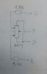

    In search of something that I could add to the gas in my electric car, which I have been trying to make for some time, I hit the gas pedal of a forklift, where it mechanically fits perfectly into the structure. The sensor is probably broken, but I don't know that and I wanted to check it. Unfortunately, I was probably at the end of the internet and I haven't found one.
    Maybe some of you had to do with what is shown in the attached picture. I suspect the hall effect sensor, but I won't give a head. I do not know the leads either, so I would not want to damage anything by rushing.
    This is what it looks like
    What is this sensor and what are its parameters (MCB 419311 potentiometer)

    Well, this is what I saw, but mine has 4 cables, and the one you write about - 3 and it looks a bit different :(

    Have you checked the resistance between the wires?

    @onepiotr, no, I will not be charged. Most likely, I will strip the reptile and transform it my own way. Specifically, I want to use this housing, because it is cool, and to it I put an analog hall effect sensor and a small magnet - I have already done tests and they turned out very promising (good stability of parameters when the magnet rotates), and above all, the path will not wipe out, because it will not be like that :)
    @ gradek83, I took the measurements and if between the black and the extreme yellow and green it behaves like an ordinary logarithmic potentiometer (the resistance in the direction from green to yellow drops faster and faster from the extreme position in the range of 4.25k to 1.73k), then with a red cable I have such miracles that it's even hard for me to describe them here (there is no logic at all) - maybe that was the reason for replacing the accelerator pedal module.

    Curiosity won, and at the same time there will be information for posterity :) Taking into account the strange and illogical indications (which does not surprise me anymore and you probably will also stop after seeing the photos), I decided to undress the reptile. He gave up relatively easily. It turned out that it was only slightly glued at the edges, which could easily be delaminated with a knife and remove the lid.
    However, there is a potentiometer inside. On the attached pictures you can see exactly how it is built and how the resistance path is used - it had no right to work properly anymore. The upper slider is resistance, the lower two are the connection terminated with sputtered resistors (the tabs on the right side of the tracks).
    What is this sensor and what are its parameters (MCB 419311 potentiometer) What is this sensor and what are its parameters (MCB 419311 potentiometer) What is this sensor and what are its parameters (MCB 419311 potentiometer) What is this sensor and what are its parameters (MCB 419311 potentiometer) What is this sensor and what are its parameters (MCB 419311 potentiometer) What is this sensor and what are its parameters (MCB 419311 potentiometer) What is this sensor and what are its parameters (MCB 419311 potentiometer)
    Finally, the housing is already in the workshop and is trying to sensibly stuff a magnet with a linear hall effect sensor into it.
