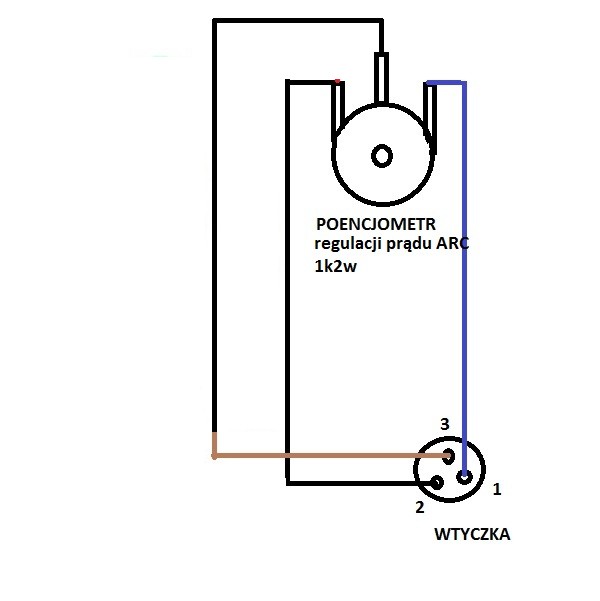

    I would like to connect the potentiometer according to the diagram (as in the picture), I got lost or connected with each other:
    A) feet 2 and 3
    if
    B) feet 1 and 2
    Thanks for the help

    Does not matter. The most important thing is not to combine 1 of 3 :D .

    Depends on what you need to get.
    It will depend on the connection method whether, for example, by turning it clockwise, you will increase or decrease its resistance.

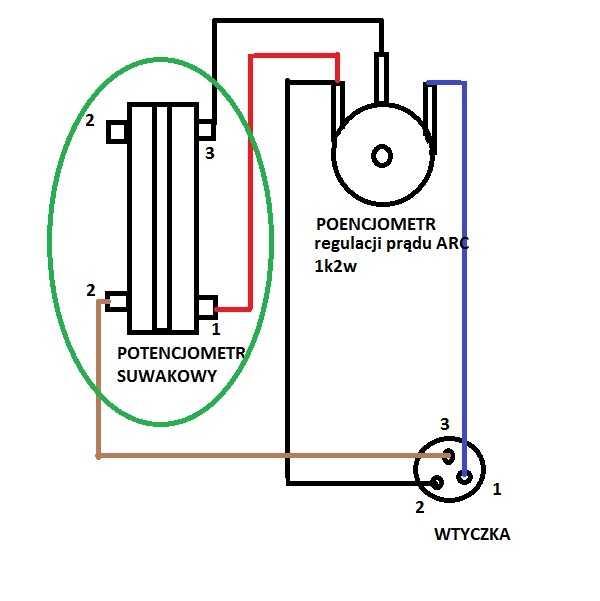

    I need help with the following matter.
    I would like to get rid of the slide potentiometer, and leave only the rotary potentiometer (I do not know how to connect it after cutting the slide pot).
    It looks like the diagram:
    Potentiometer Wiring Confusion: Connecting Feet 2 and 3 or Feet 1 and 2?

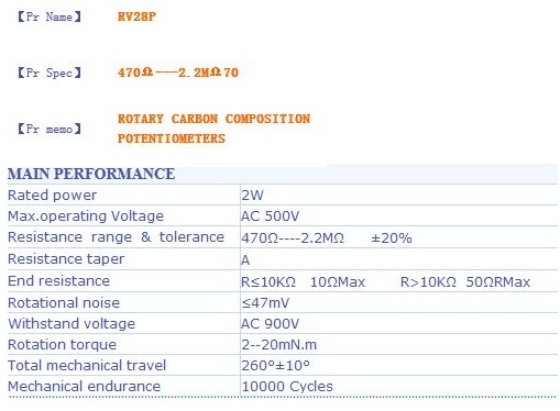

    After the symbol RV28P, I found such information:

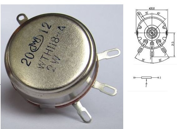

    In addition, if it was possible, I would like to replace the above-mentioned rotary potentiometer with another one.
    I found a few but I don't know if they would be good (due to the resistance). For example like this:
    symbol: wth118-1a-2w

    I forgot to write down how it works for the moment. I set the amperage (let's say 50 amps) with the rotary potentiometer, and I can regulate the slider between: 0 A - 50 A

    Try to connect like this.

    Thanks a lot karel47. It works the same with each potentiometer.
    Instead of the original one, I put another one, because that one is plastic crap.
