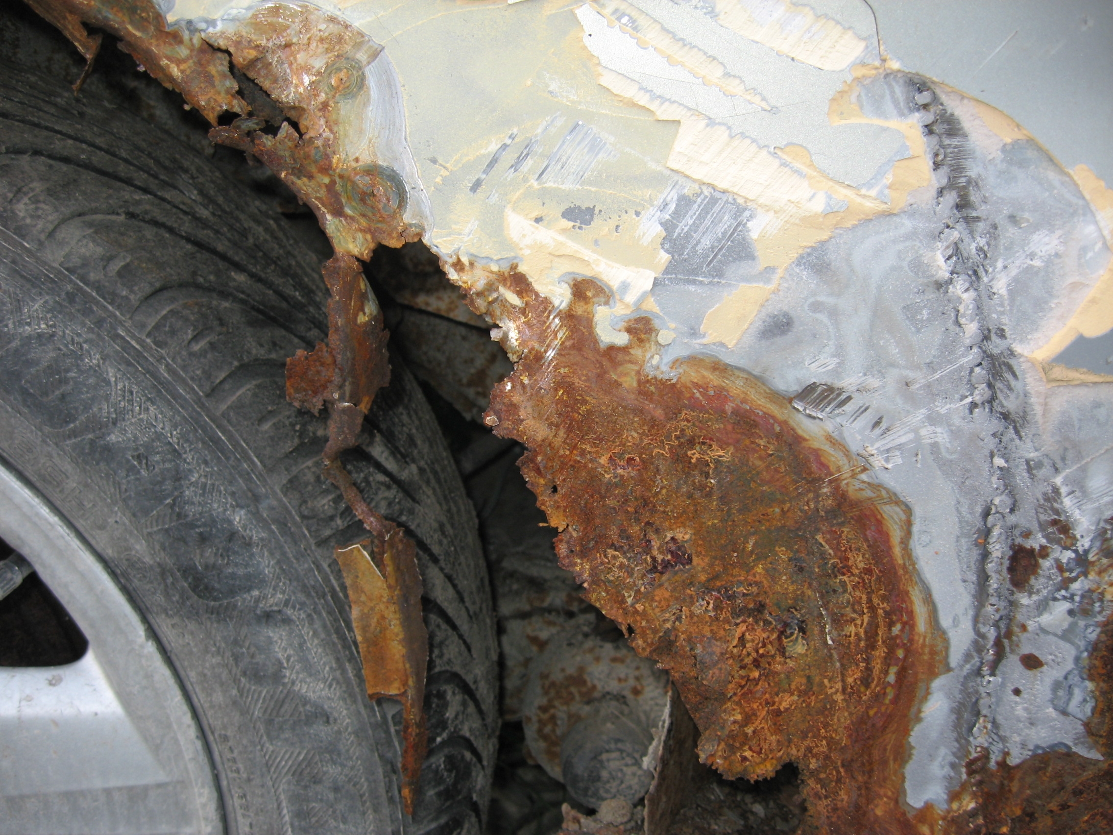

    well, the advantage of technology:
  • Audi A4 B5 shows better corrosion resistance than A3 8L
