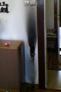

    As another curiosity for all electricians, this is an example of spontaneous combustion of an electrical outlet of which a long time ago we did an expertise belonging to the SEP at the time.
    Understanding Electrical Current Travel Along Walls and its Relation to Circuit Theory
    As you can see it's a nice hole in the wall and a trace of the outlet is gone, in the floor burned a deep hole 8cm in diameter from dripping plastic. Terrible stench was in the stairwell and smoke coming out from under the door, the owner was not at home and the neighbors called the fire department , they entered through it and extinguished the fire stink.
    There was the problem of the broken window and the cost of the intervention of firefighters.
    The firefighters and poor electricians of the administration clung to the owner "What did you plug into this socket"
    She insisted that she had never used this socket, and even for some time she felt that the wall near the door frame tingled with electricity .
    It was a curb socket, the wire was new (7 years old) 3x2.5mm² next to a heavily heated after the night tariff accumulation stove fed from a separate three-phase line.
    The woman was telling the truth - there was also an electrochemical reaction here, heat, gypsum deposition of the box and snow on the cables, I do not remember exactly, but chemists explained it somehow.
    At such a furnace, the wall was certainly dry - yet it tingled with electricity.
    The eSy 16A fuses from the outlet and 25A in the stairwell did not work, if there had been a differential for all outlets would probably have turned off the voltage.

    wada
    Posts: 3048
    Help: 168
    Rate: 732
    Plumpi wrote:
    Dude Wada, I think you're letting your imagination run too far :) Read a little about wall and floor resistance measurements and note with what methods and what voltage values these measurements should be made.
    note that I wrote " sometimes "and that's a little almost 20 years ago and measurements were made with popular crank meters :D
    How is it now -. I don't know
    And I don't want to know because pulling the wire doesn't amuse me anymore and it doesn't interest me.
    And the problem is and will be, changes in measurement methods are yet to come.
    15kVmaciej wrote:
    wada wrote:
    It is also worth paying attention to the DC current that is often generated when passing through different materials.
    I had a glare why I sometimes have different readings with different methods!
    wada wrote:
    and even between Gas concrete (popular suporex) and gypsum plaster (acts like an old-fashioned selenium rectifier) and on the wall you have positive voltage with respect to PE
    and a colleague relied on various unigrunts with which walls are insulated before plastering - he was doing some research on measuring the insulation of walls by measuring its conductivity - something like that - I do not remember exactly.
    The conductivity characteristics varied depending on what company the unigrunt was, and very much resembled the characteristics of the semiconductor Diak

    wada
    Posts: 3048
    Help: 168
    Rate: 732
    15kVmaciej wrote:
    wada wrote:
    A colleague relied on various unigruntles with which walls are insulated before plastering - he did some research on measuring wall insulation by measuring its conductivity - something like that - I don't remember exactly.
    Nothing of the sort, in a certain metal box embedded in the wall I had readings against it and the PE coming from another building, the wire run separately, no inductions and the like. A colleague directed me what to look at more closely on both sides of the wall
    well these tests are what a fellow PhD student at the polytechnic tried to do.
    A case similar to yours and a solid spark when splicing equalization connections and PE from two buildings, also happened, but the electricians spliced it explaining that it was some induction or phase shift on different sections of the line.
    The truth came out probably after two months - a red rod on the wall - a cooper going on the facade wall and passing through several other walls, was plastered, an electrochemical cell was formed, from what I recall it had 16V of direct voltage and a considerable current.
    Another case was PEN overloaded on one phase had almost 30V (alternating) more than PEN from another line.
