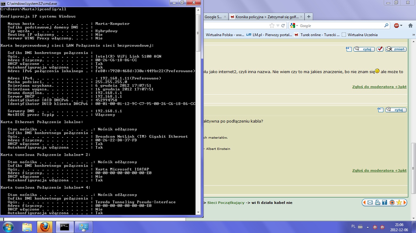

    I have this problem: today, after turning on the desktop computer, the internet did not work, there was a message that the network cable is not connected, after turning off and turning on the network card, the connection was only the Internet still not working :( wi fi works without a problem, after connecting the cable to the laptop also the internet does not work, via the cable :(
    I bought a new cable, it didn't help
    Will I be able to deal with it myself after your tips? Please help. I urgently need a desktop computer, because I am writing my MA thesis, and my laptop does not work with usb ports, and I have no way to connect a mouse?
    Thank you in advance for your help and understanding :)
    my router is spark lan wrt 141

    yes the LEDs are active:
    ip config from laptop, wi fi works https://obrazki.elektroda.pl/3722111500_1354825247.jpg
    while on the desktop it says: an error has occurred, the task is not handled ...
    I guess I messed up something more because the name of the connection changed to a different one in the landline .....
    save :(
  • #7 11619516
    jimasek
    Posts: 35287
    Help: 3783
    Rate: 2681
    I mean the cable connection, not the wifi, and in the screenshot the cable is disconnected.

    I connected the cable back to the stationary one: the card says 10/100 Mb
    And in the stationary, where the internet always worked on the cable, now in Ipconifig / all he writes: an internal error has occurred, the request is not supported

    marta899 wrote:
    Did not help :(
    Have you restarted your computer?
    Give screen-a from ipconfig / all again while you're wired.
