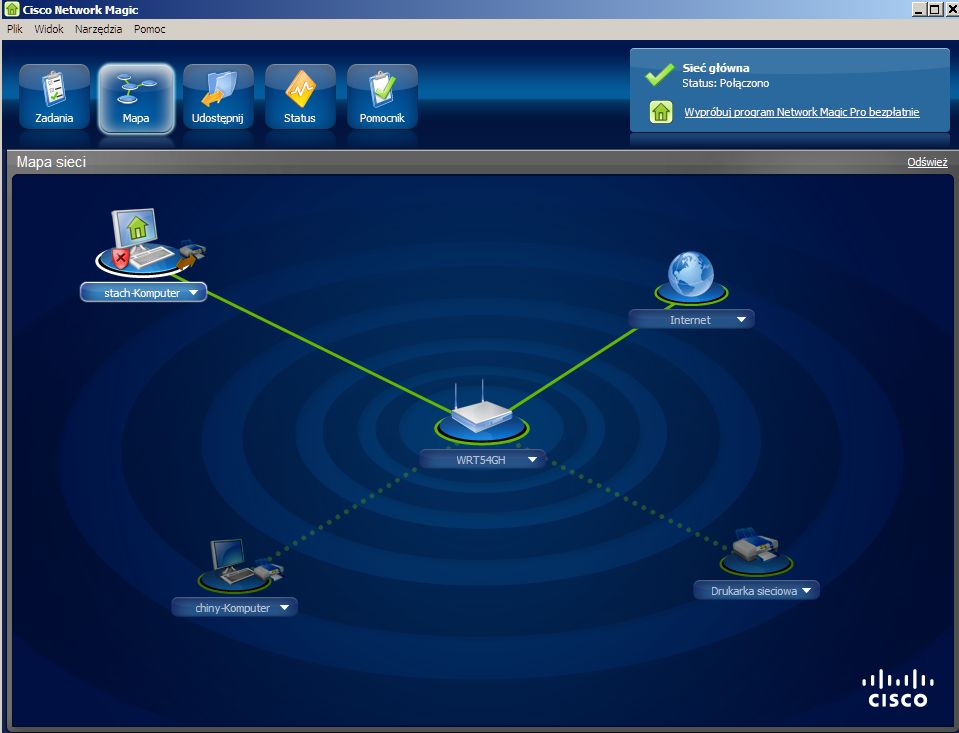

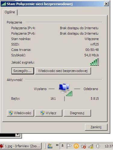

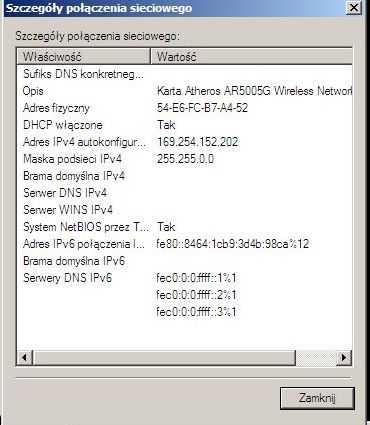

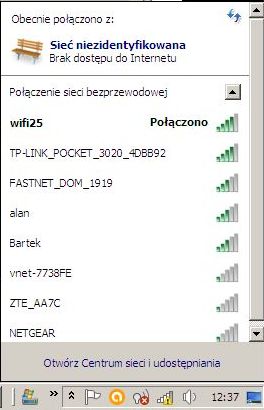

    Suddenly, while using the Internet, without modifying the network, one host connected to wifi ran out of Internet, while at the same time another host connected to the router with a cable - no problems. Cable Internet directly from the modem. The situation has been going on for several hours.
    Something to me, this IP address on the wifi card does not match. Please have a look at the screens or everything as it should be.
    -windows7
    -router linkys WRT54GH.
    -when DHCP is disabled on the router (DHCP reservation) it does not solve the problem
    edit:
    - interesting that there is no connection on the cable connected between the router and this problem host, i.e. the router's software cannot detect the new device). Although on the same cable, on the same LAN card connected directly to the modem - the Internet is there.

    You have a buggy IP address, you don't have a gateway assigned to it, so the connection will not work.
    Use your finger to assign any free address from the pool 192.168.1.x, mask 255.255.255.0, gate 192.168.1.1, dnss either auto, or whatever you want (e.g. 192.168.1.1 and 8.8.8.8) and check if it works.

    hm, it works. Thank you.
    What did he suddenly assign to himself some weird addresses? Because it happened when I was using the Internet and then ... when suddenly ....
    Well, because all my life I have set "get an IP address automatically".

    This address (169.xxx) is assigned by microsoft to cards from DHCP as they did not get an address from the server.

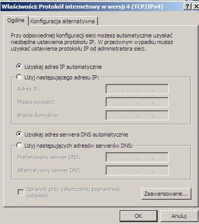

    I am completely dumb.
    I repeat, the problem arose when there was this configuration:
    - on dhcp network cards enabled
    - on ip network adapters automatically
    -on the dhcp router enabled and manually assigned mac -ip for each device on the network
    after post # 2, I changed on my computer (not in the router) to:
    - ip, gate, manual mask
    and it worked
    so you tell me to go back to the configuration I always had (and during which the problem occurred)?
    (ps. this screen with the settings on the router where dhcp disable is, I did a moment after changing this option, previously it was enable. ... I hope ... although I could at one point think that if I manually assign Ip to Macs, then It's not dhcp anymore and I gave disable. I won't give my head. But that would explain everything.)

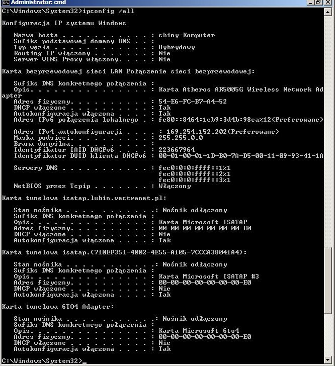

    Anyway, look at the IPv4 address you have in the CMD window, and compare it with the IP address given by the router - it's a completely different pool.
    You have an internal IP, allocated by your network provider.
    No, I know it. This is an effect, not a cause. But I am convinced by your proposal to look for the reasons in tampering with the settings or some kind of attack, a virus, because I remember that when it happened, I was walking on medium-trusted sites.
