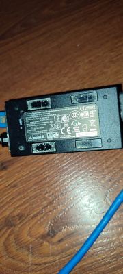

    As for this "router", yes, there is a LAN cable connected to some cube (you can see it in the photo).
    As for the diodes, yes, they light up.
    Internet Connection Issue with TP-Link TL-WR841N via Ethernet Cable
  • #6 19906013
    sosarek
    Posts: 83875
    Help: 9318
    Rate: 15495
    So you have radio internet. Connect the cable directly to the computer, bypassing the router.

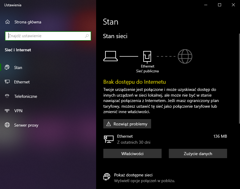

    Unfortunately, that didn`t help either. Is it possible that it is the router`s fault and you need to buy a new one?
    Added after 14 [minutes]:
    I don`t know if it will help, but after connecting the ethernet, something like this appears on my computer.
  • #12 19906269
    KOCUREK1970
    Posts: 35448
    Help: 3835
    Rate: 5431
    @TeusQ
    It must be a private network, not a public one.
  • #13 19906290
    TeusQ
    Level 4  
    Posts: 62
    Rate: 22
    KOCUREK1970 wrote:
    @TeusQ
    How to do it?
  • #14 19906356
    KOCUREK1970
    Posts: 35448
    Help: 3835
    Rate: 5431
    @TeusQ
    Under the connection symbol, you have a "properties" banner, tap it and change it from public to private (you may need to restart your computer).
  • #15 19906371
    TeusQ
    Level 4  
    Posts: 62
    Rate: 22
    Unfortunately, it didn`t help.
