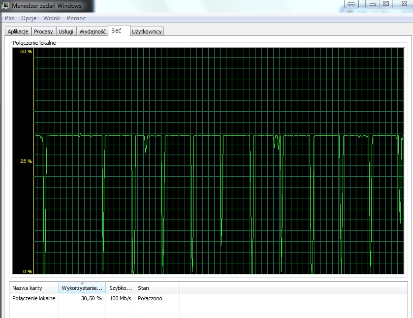

    Hello all.
    I have been fighting with the UPC network for some time. Disconnects, yellow triangular "network" icon appears. A moment ago there was a UPC service technician, we downloaded a 4GB file, observing the connection graph (30Mbit). He found the chart okay, not in my opinion. Can someone objectively comment on whether the link drops to 0% are normal, or should I terminate the contract?

  • #2 11734238
    Maxe
    Posts: 137
    Wireless computer or cable?
    However, if the option is, then try the other one as well to see if it is the same.

    #4 11734254
    vito007
    Level 26  
    Posts: 942
    Help: 73
    Rate: 214
    The chart does not prove anything. Transfer drops can be caused by the server.
    You have to try transferring from different servers (well at different times).
    On the other hand, connection loss is more worrying.
    I understand that you have a computer connected directly to your modem.
    By cable or by radio.
    It would be good to try on a different computer - will it be the same.
  • #5 11734268
    tormentor
    Posts: 123
    Rate: 24
    Thanks for the answers.
    Comp directly on the cable. Without a router and with a router, the graph looks the same.
    The modem is Scientific Atlanta.
    I tried on 2 computers - the same.
    I have tried from various sites that offer 0.5 or 4gb files for download - the graph ALWAYS looks the same. In my opinion, the line should fly evenly, according to the UPC technique it is ok because the pings from the wp respond for half an hour, and the graph does not appeal to him.

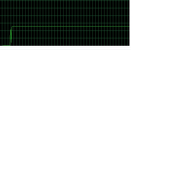

  • #7 11734416
    tormentor
    Posts: 123
    Rate: 24
    I have the controls up to date, besides, the graph looks the same on another computer. I also tried the page you gave. Could someone with a permanent link see how the graph looks like for him?
    It looks like this for me
    UPC Internet frequent disconnects and yellow triangle icon—are link drops to 0% normal?
  • #9 11734542
    tormentor
    Posts: 123
    Rate: 24
    Well, he has not been breaking up for half an hour, I will check what it looks like at the neighbor's apartment. Thanks alot!
  • #10 11735170
    vito007
    Level 26  
    Posts: 942
    Help: 73
    Rate: 214
    such breaks are not normal.
    If they still occur - advertise.
    Have a technician come with a laptop and see it.
    If his computer is good, and yours is bad, then you may still have a virus, or some other dirty thing - some program that regularly blocks the link.
    (I fantasize a little, but nothing else comes to mind anymore)
    check that all connectors on the coaxial cable are tightly crimped (that the cable sits stiffly in them) and that it is screwed on.
    Once, such a loose F generated a lot of jitter on the voip, and all other parameters of the link were ok.
  • #11 11735491
    tormentor
    Posts: 123
    Rate: 24
    Gentlemen, I checked with a third laptop, borrowed for a while. With each test, I connect without my private router. I missed the cables, the technician replaced all the branches. The graph looks the same on all computers, so UPC gives you back. The technician is to come again, he will probably find that the chart is ok :(
