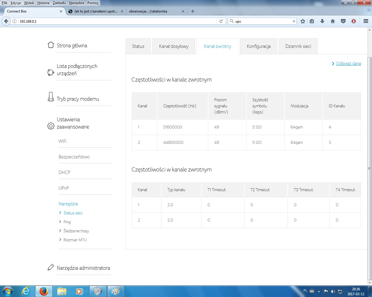

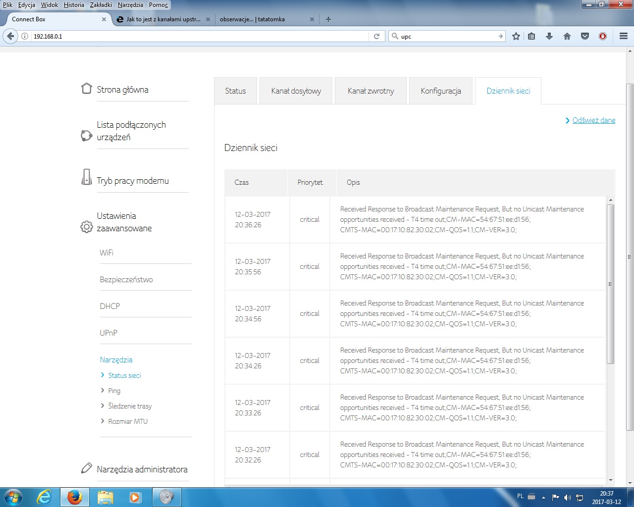

The modem does not have to lock onto 4 upstream channels; 1 or 2 channels can still be normal, and the red degradation warning only matters if the modem is restarting or the connection is dropping [#16340580][#16343207][#16343656] Four upstream channels are recommended, but if the upstream signal is too high the modem may not be able to use all of them [#16340580] Because the problem keeps returning and the modem log shows T4 timeouts, the upstream signal likely needs adjustment at your location [#16341945][#16343349] If the service is otherwise stable and there are no reboots or disconnects, the message itself is not a problem [#16343656] Packet loss on intermediate hops is not a reliable sign of instability unless the target host also shows losses [#16370785]

    Hello. I have a 120 Mb / s connection from Upc. I have been using them for a long time for link stability. The compal modem page displays the message red in degradation of services. Two return channels are displayed in the tab. The only question I have is whether this message in red is correct and whether these channels do not have to be 4. I had several service technicians, the last one had little success because for one day there was a message in green Internet and 4 return channels. [/ Img]

    Recently they claim that this is not a problem.

    If there were no gaps and disconnections of the Internet, I would not delve into the subject and I would not tire them either. An error pops up every minute in the modem's log
    13-03-2017 18:48:56 critical Received Response to Broadcast Maintenance Request, But no Unicast Maintenance opportunities received - T4 time out; CM-MAC = 54: 67: 51: ee: d1: 56; CMTS-MAC = 00 : 17: 10: 82: 30: 02; CM-QOS = 1.1; CM-VER = 3.0;

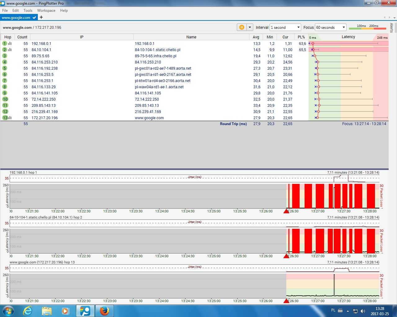

    One more thing, do these 1 and 2 hop packet losses mean anything when it comes to stability? Upstream Connection Degradation on 120Mb/s UPC Service: Compal Modem, Return Channels, Technicians
  • #14 16370785
