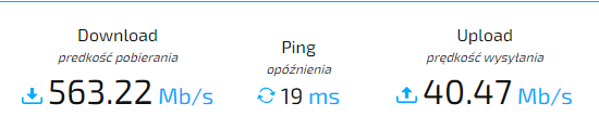

    At the beginning, there was no problem with the wireless Internet 7 ping and I do not remember downloading about 100 Mb / s upload.
    After coming from vacation ping 20/30 download 40 / 50Mb / s upload 40Mb / s I do not know what is caused by it.
    UPC Giga Connect Box: Internet Issues - Increased Ping & Decreased Speeds (DL/UL 40-50Mb/s)
    Thank you and best regards

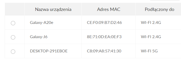

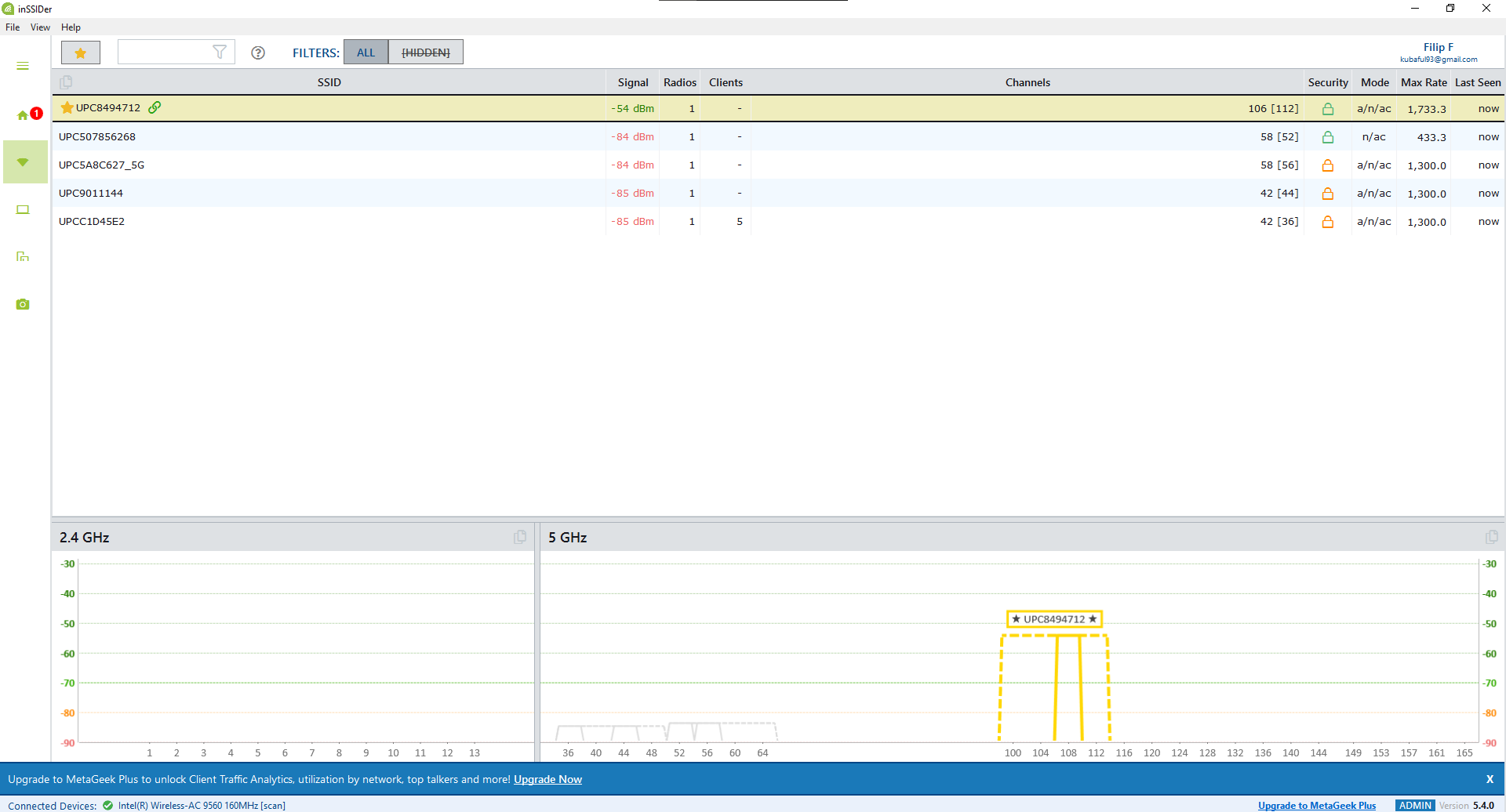

    _cheetah_ wrote:
    RussianDoggi wrote:
    At the beginning with wireless internet
    You mean you mean that the connection between the router and the computer via wifi has slowed down?
    If so - enter the type of wireless card in the computer and it would be good to start with a wifi network diagnosis -> https://www.elektroda.pl/rtvforum/topic3158772.html
    Preferably InSSIDer (Win), or possibly Wifi Analyzer (Android).
    One measurement DIRECTLY at the router
    Another measurements on a computer connecting to wifi
    And place the screen accordingly: https://obrazki.elektroda.pl/4257484200_1454694642.png / https://obrazki.elektroda.pl/9695492800_1454695020.png
    All things are in the screenshots at the top

    _cheetah_ wrote:
    Oh sorry - I didn't get it with Xirrus.
    At 5GHz you have a total desert so why are you set your channel width to 40MHz and not 80?
    How long is this connection set up in the computer?
    I have a 5G network set up for my laptop in the router settings
    In 5g I can change to 20 MHz 20/40 MHz 20/40/80 MHz
    I am set to 20/40/80 MHz
    Suggesting 5 GHz channel 48 and InSSIDer checks

    _cheetah_ wrote:
    So from the machine he set 40MHz to 5GHz. And try to manually set the channel to, e.g. 48 and see what the width of the channel will be then. And maybe install InSSIDer on the computer, you can see everything better.
    You still have to see this:
    Connection Properties pane
    Win7:
    Win10:
    https://static.elektroda.pl/attach/111_6087024.png
    I changed 5G to channel 108
    Added after 5 [minutes]:
    And I have to add that before the holidays, 7 ping was in csgo, so ping in speed tests was probably lower

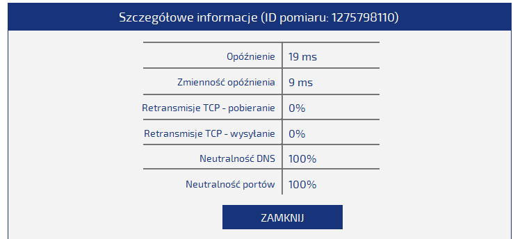

    bbartek93 wrote:
    As for changing the ping from 7ms to 20 / 30ms, check the router if you have turned on IPv6. You can do it in 3 ways in the router, the fastest is probably to log into the router and see if you have bridge mode available, or see the uploaded cfg or in the information if there is IPv6. Because I understand that you also have this ping on the cable?
    yes, the ping is the same on the cable, but it does not jump as much as it does without the cable

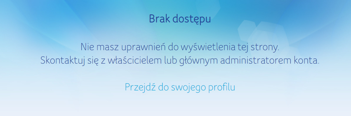

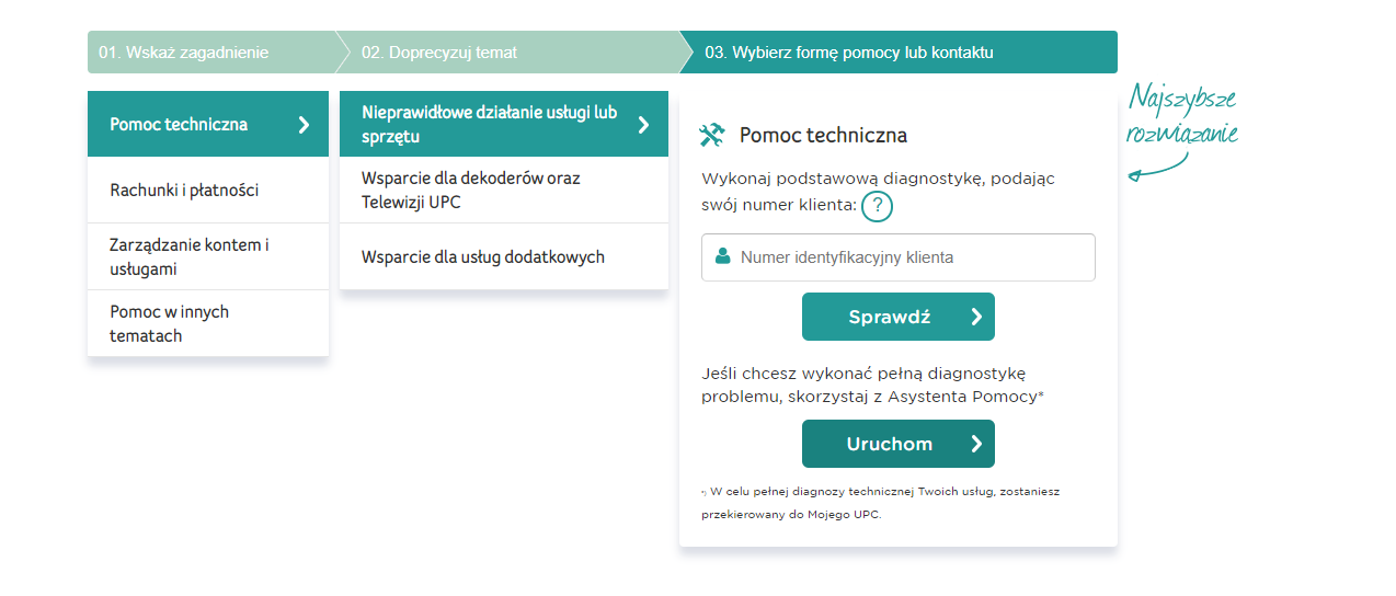

    the only problem is that I have to enter the customer number or log in, only my dad knows the number and data
    so .. I have to ask him about it or I won't be able to write to them
  • #21 19231092
    bbartek93
    Posts: 110
    Help: 19
    Rate: 29
    So ask yourself. The customer number is needed to identify if you are writing about your link and that they will find you in the system. They may also need PESEL to identify the subscriber.

    The account does not have to be associated with the contract (you do not even need to log in) but they will still need the account details and then they will have to identify if you are a user of this internet.
  • #24 19231109
    RussianDoggi
    Posts: 34
    Rate: 12

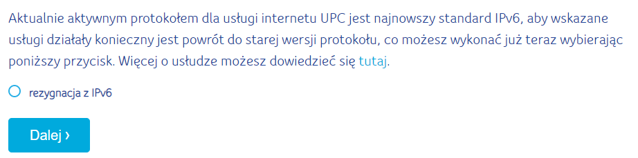

  • Switch to IPv4 in old Moje UPC portal

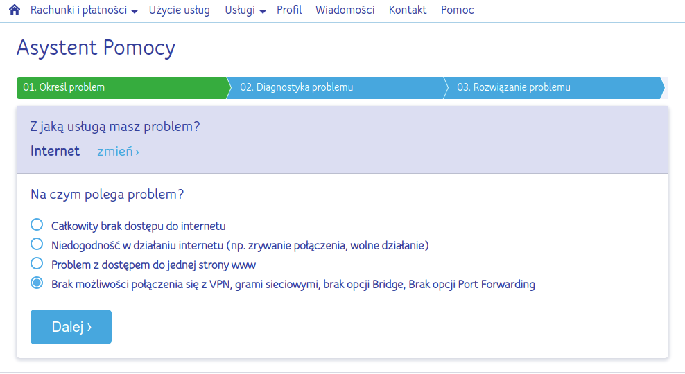

    #25 19231123
    bbartek93
    Posts: 110
    Help: 19
    Rate: 29
    Then you will do it when he comes back. There is one more change option.
    You are logging in to the old version of Moje UPC: https://www.upc.pl/sign-in?conversation=https%3A%2F%2Fwww%2Eupc%2Epl%2Fmojeupc%2Foverview%2F
    And through the Help Assistant, go to switch to IPv4 as in the picture below: https://www.upc.pl/mojeupc/asystent-pomocy
    Unless it does not pass and it is written to contact the hotline or via chat, that's the only way to be done.
  • Switch UPC connection to IPv4 via Moje UPC

  • IPv6 behind NAT increases ping and breaks port forwarding
    #29 19231180
    bbartek93
    Posts: 110
    Help: 19
    Rate: 29
    There is no catch. What you have ipv6 now is worse because a lot of sites and servers don't support this IP protocol and you get IPv4 behind NAT to make these sites work for you. You don't have public IPv4 back then, so it's worse for online gaming. So you can say that UPC is testing IPv6 on little-known users. With IPv4, you also have the BDRIDGE mode available in the panel, good if you want to connect your router and configure everything on it. Then the Connect box behaves as a modem, but by default the BRIDGE mode is turned off and works in router mode, which is the same as with IPv6 (because with IPv6 there is simply no choice between modem and router mode).
    With IPv4, port forwarding works for you (because you have public IPv4 and not behind NAT), so in games you will have NAT open after unblocking the ports. Plus, you get less ping because your route doesn't pass through an additional NAT server where you get IPv4.

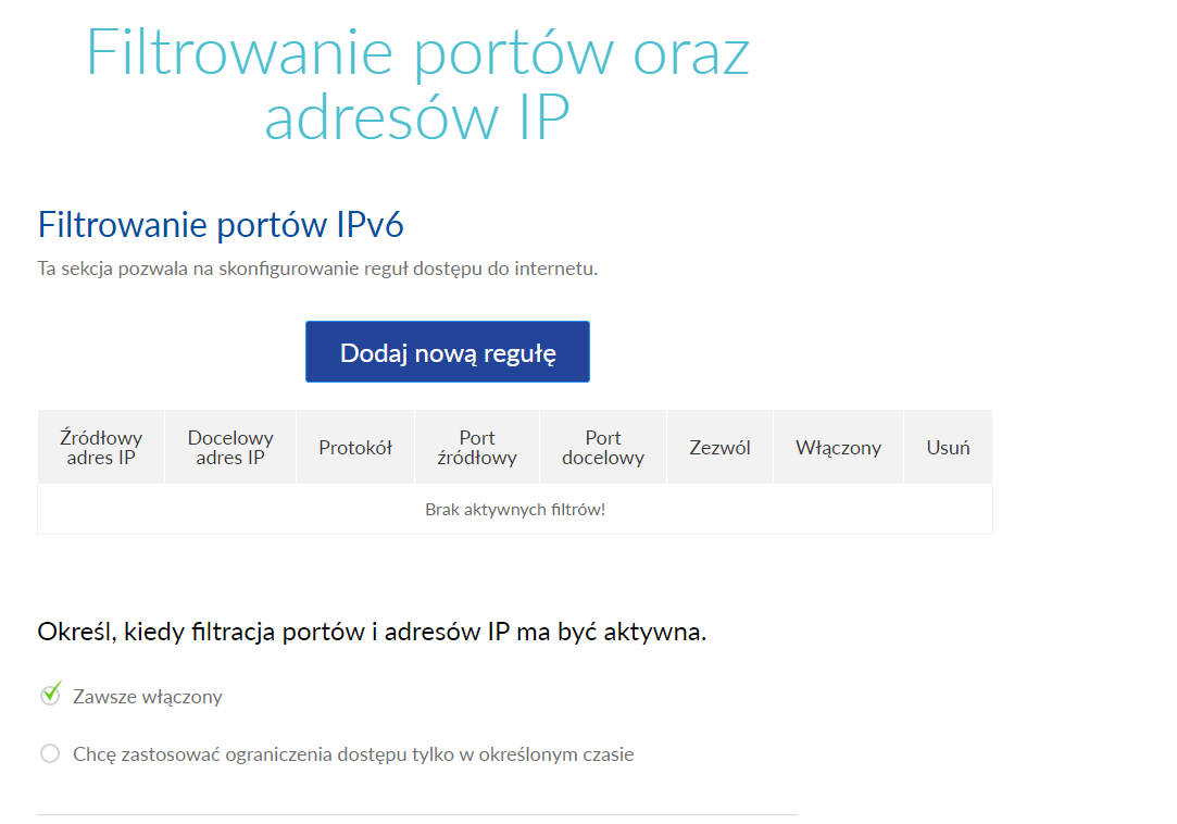

    @ bbartek93
    I should not check this box, yes?
    Added after 30 [minutes]:
    RussianDoggi wrote:
    @ bbartek93
    he asks me not to turn out that I will do something wrong
    I know to leave it, but I just want to make sure because I don't know too much
    :D

Can I contact UPC without the contract holder’s login?
Yes. You may start chat unauthenticated, but agents still request the customer number or PESEL to verify the account [Elektroda, bbartek93, post #19231098]
