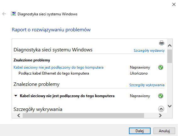

    For some month I have had a problem with the UPC Polska Internet 120 mb / s. At first, the problem was trivial, if you can call it that. At the startup of the computer, I had no internet connection, to solve this problem it was enough to click "Solve problems" As shown in the picture:

    And the problem completely disappeared throughout the whole PC session.
    But now that doesn't help either. Internet failures are sometimes more frequent and less frequent. I checked the Ethernet cable on 2 laptops. There is no such problem. I even made a PC format to check if it was a system problem but the problem persists. Reinstalling the drivers for the network card did not help either.

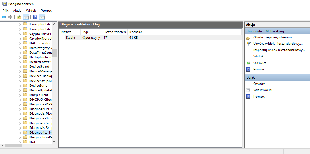

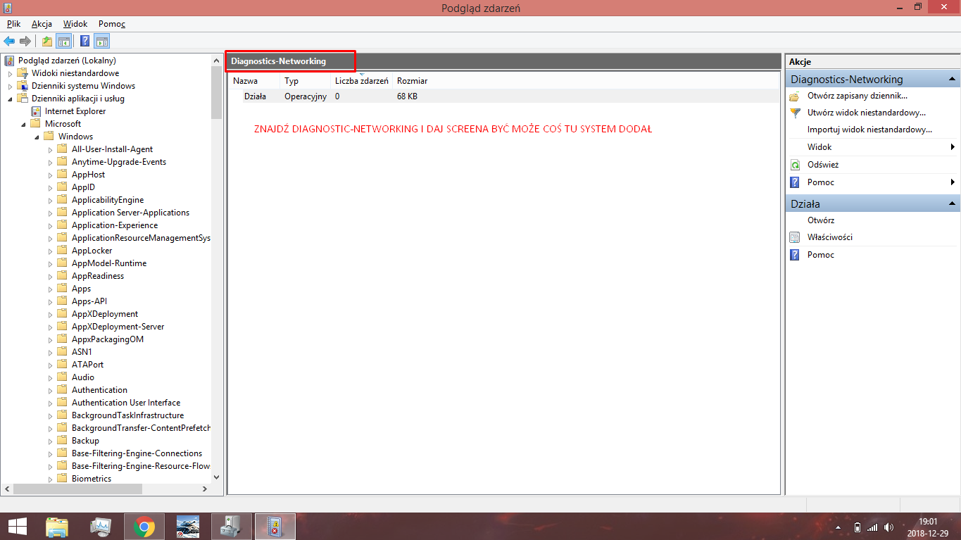

    Give the "Detailed operations" screen in what you posted. Continuous UPC Polska Internet 120mb/s Disconnections: Intel I219-V NIC & Connect Box Modem Issues
    And this too Continuous UPC Polska Internet 120mb/s Disconnections: Intel I219-V NIC & Connect Box Modem Issues

    This is in the detailed operations.

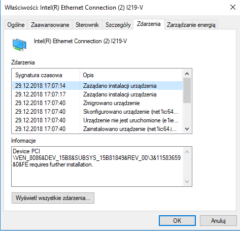

    These are these events: / Is it normal?
    Ps. I was installing these drivers. At the beginning, I noticed the lack of the net when logging into the windows account. But now it was quiet and never appeared.

    So now everything is ok?
  • #7 17661805
    kosa1337_92
    Posts: 17
    So far yes :D Thank you!
