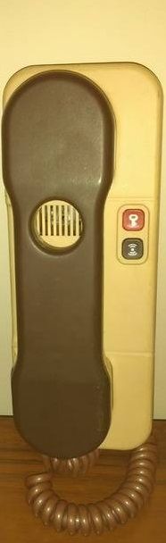

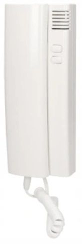

    I will refresh the topic, because today I struggled with the intercom at my parents. Ie: I was replacing the handset with a new one and I had a problem with 6 wires, what and where.
    I hope it will serve someone. In this topic, the handset I put on also supports garage doors and a wicket with an electromagnetic lock.
    Old intercom

    New intercom, which I recommend "UNIFON WEKTA TK7".
    Probably the cheapest on the market.
    How many wires should a cable have for an intercom with a magnetic lock. and an How many wires should a cable have for an intercom with a magnetic lock. and an
    CENEO LINK: WEKTA TK7 UNIFON
