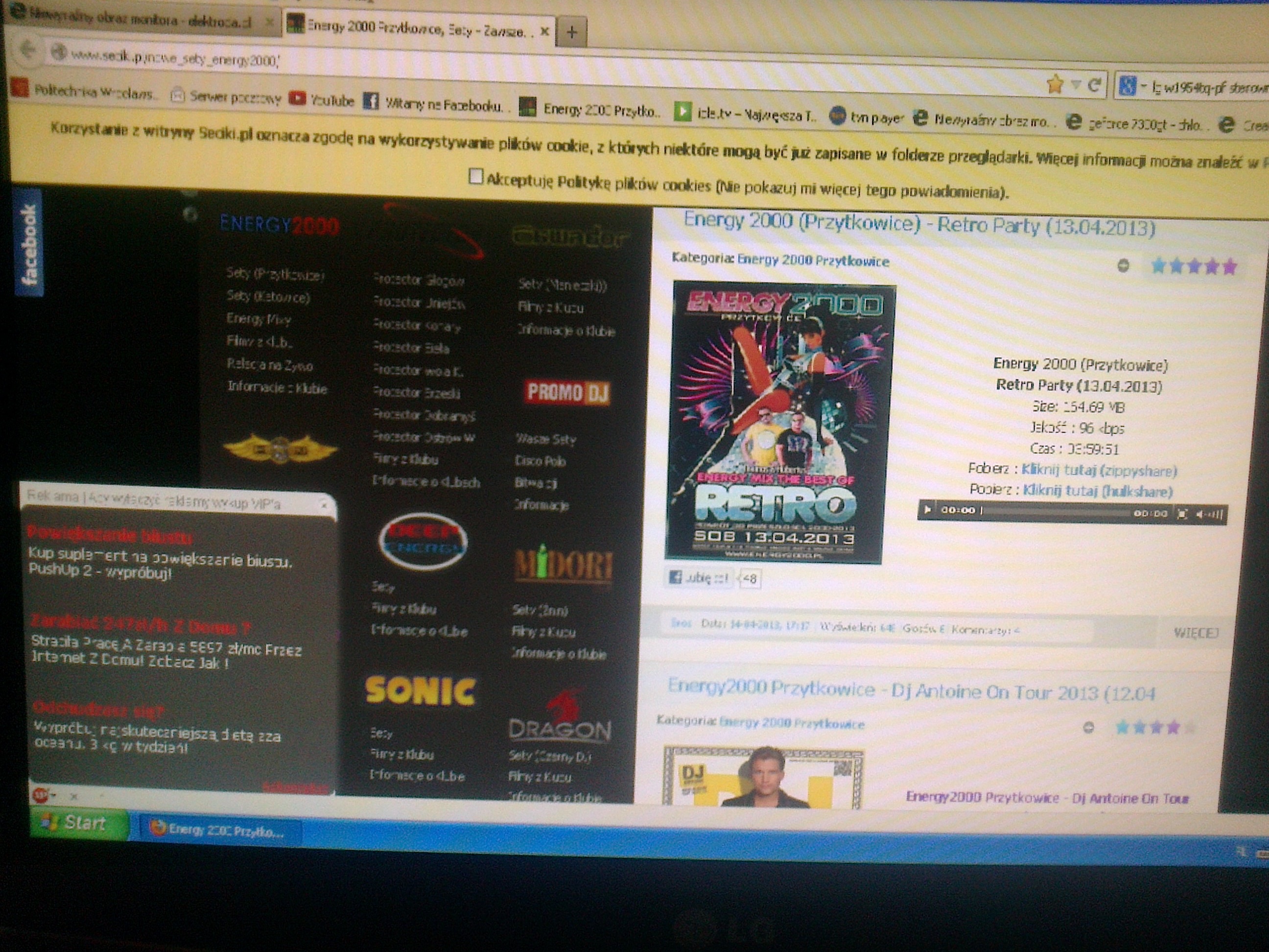

    Hello, honorable forum members.
    I was cleaning the computer casing and cables, after connecting everything and turning on the computer, the image is terribly blurry. I tried to set the resolution and restore the system but it didn't help :(
    Please help

    The image you uploaded looks completely normal. Take a photo showing the problem with the camera and upload it again.

    I didn't fumble anything, everything went like this:
    1) the computer was running and everything was fine
    2) cleaning
    3) turning on the computer - resolution broken
    Monitor Image Blurry After Cleaning: Resolution Adjustment & System Restore Failed
    subtitles are cropped everywhere: /

    Well, in this picture you can see that the picture is poor. But the reason is still mysterious? As a colleague previously advised @ dt1 , install the drivers for the monitor - this gives you more setting options - I know this after my experience with my Philips!

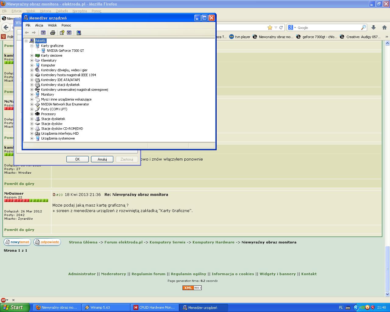

    Maybe what kind of graphics card do you have?
    + screen from device manager with "Graphics Cards" tab expanded.
  • #24 12214984
    kambataro
    Posts: 75
    Geforce 7300gt
